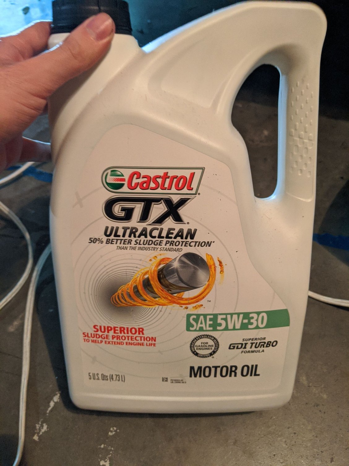

Since I started doing my own routine preventative maintenance and restoration on this Blazer, I switched the brand of oil from the Walmart Supertech 5W-30 to the Castrol 5W-30 Ultraclean. Both conventional oil (so I think).
I used the Castrol Ultraclean for about a year because Scotty Kilmer on YouTube had a video about oil where he highly praised the Castrol Ultraclean for high mileage vehicles that didn't get serviced enough (Because the previous owner of this Blazer had it in storage before he decided to sell it).
This is the bottle of Castrol Ultraclean I've been getting off of Amazon.
When I went looking for it, I searched on Amazon for "Castrol Ultraclean 5W-30 Conventional". This product was on their first page of results. So, it showed up in my search results, Amazon says it's compatible with my model Blazer, and no where on the bottle does it say "synthetic". It doesn't say "conventional" either, but because ot didn't explicitly say "synthetic", I thought it was safe to use so I did for about a year.
The reason why I stopped using it is because I can't find this exact bottle anymore. So I switched back to the Supertech conventional. This switch back was very recently, and seems to be around the time this oil leak suddenly got worst.
When you go searching for the Castrol Ultraclean on Amazon, you get the same product under the same search query, but the bottle now has a new label that says "synthetic blend". I don't want synthetic oil and thought that's what the new bottle is. Amazon got an ear full of me when I was battling their refund department for a falsely advertised product.
Back then when I complained to Amazon about it, their listing had an image of the bottle without the "synthetic blend" label, but when I got the product in my hands, it said "synthetic blend", and I didn't even notice it until after I opened it. Castrol's marketing team made it very subtle.
https://www.amazon.com/Castrol-03096-ULTRACLEAN-5W-30-Motor/dp/B00GTOJK0C/ref=mp_s_a_1_3?dchild=1&keywords=castrol+5w30+conv entional+oil&qid=1592713263&sprefix=castrol+5w30&s r=8-3
This is Amazon's listing as of today. Can you spot the difference between this and my photo?
So now I need to know of this specific Castrol oil was mislabeled from the beginning and I have, in fact, been using synthetic blend oil.
Has anyone else experienced this?

A little online research leads me to believe that it has always been a blended formula and they merely changed the label to reflect it. Here's an example:
https://www.bobistheoilguy.com/forum...GTX_Ultraclean

Using a "cleaner" oil like that (which certainly has more cleaning agents in it) will accelerate leakage because itll erase the crud that helps seal the worn out seal.
Castrols stuff is first rate. have used it for 30 years.
