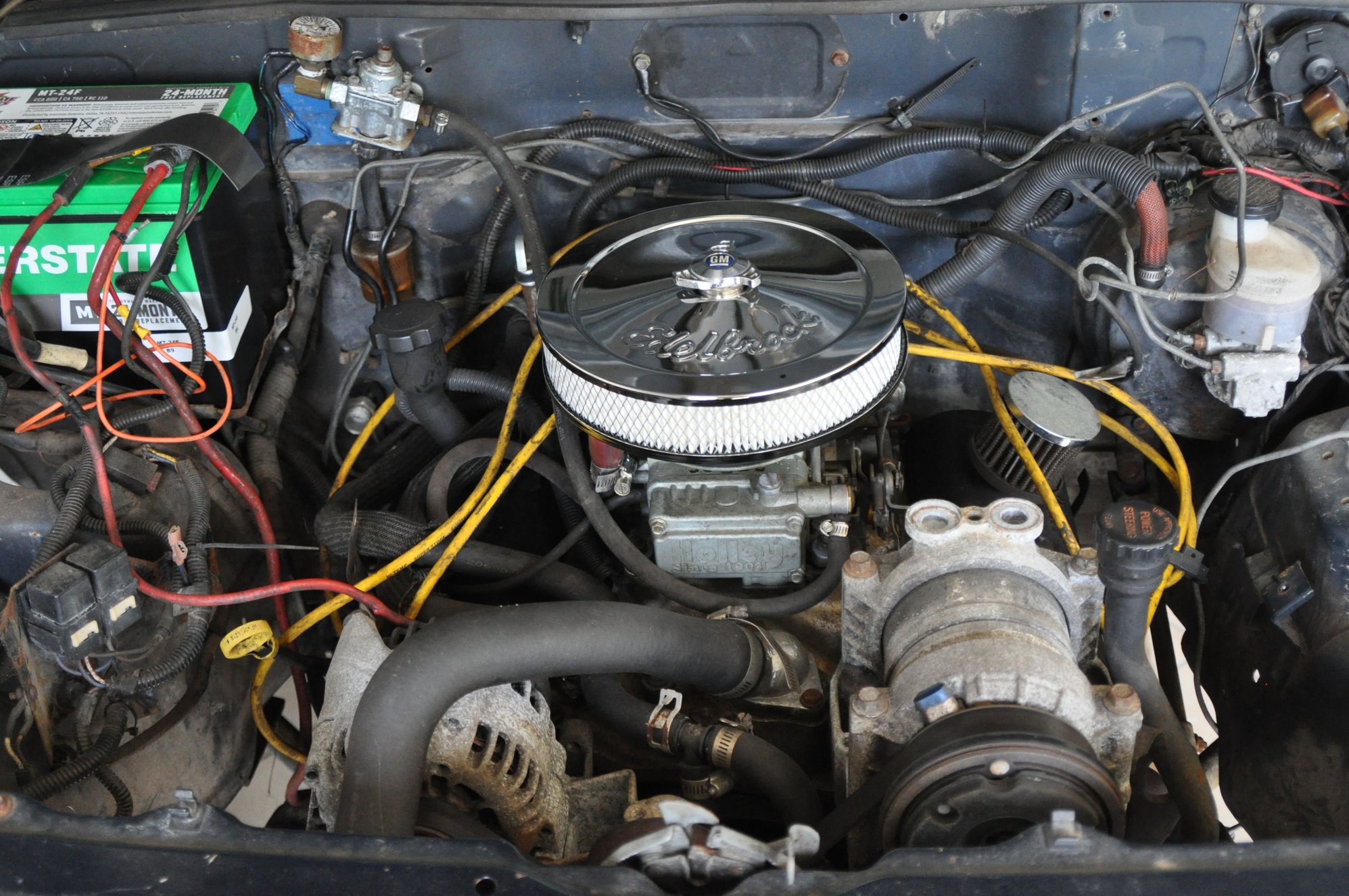

Hey all:
I got this monster truck project that needed restoring and the drive train is Chevy Blazer. The engine is a early 4.3 Vortec V-6 slightly built with cam. Holley 600 cfm double pumper, headers, etc. and the engine sounds like a 454!! I crawled under and pulled out a Buick (BOP) TH350 that was slipping with the previous owner. I was going to have it rebuilt and the more I thought about it and the more my friends said go with a Chevy TH350, the more I wondered why this BOP was used in the first place. I was thinking, 'well, if it's what they had on hand for this build'...... But then I think about the time and cost of installing the adapter plate to use a BOP instead of the common Chevy TH350. I'm still wondering why.

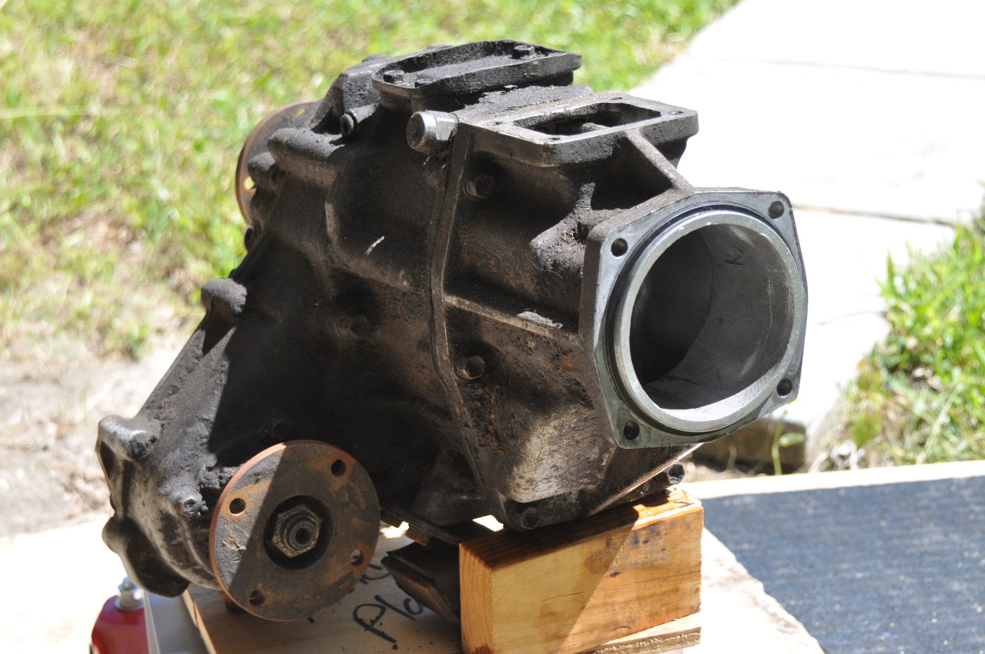

I can tell you that it has a Downey OFF-ROAD transfer case bolted to it, which I've since removed and checked to be a sound set-up. The output shaft has been chopped to use the mating sleeve to connect the BOP output shaft to the transfer case input shaft with an exceptional 1/16" tolerance apart. But, why the BOP?? The THM tail cone diameters are all the same. Remove the tail cone and mount the trans to the transfer case using the 4 allen bolts. I'm I thinking this BOP stuff too hard? I've located another built Chevy TH350 with 3500 stall for $800 but a friend suggested I use 1500 to 1800 stall instead.
