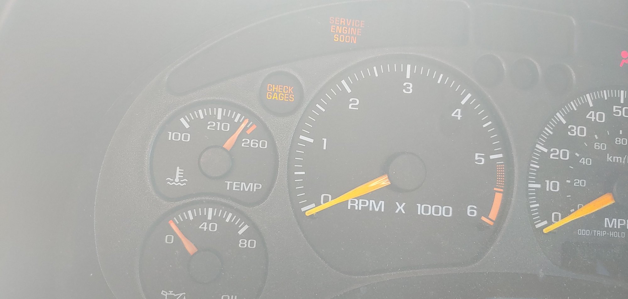

Hey guys. Drove the Jimmy today. So a few weeks ago I was having the temperature guage go between 210 and near redline all the time while driving. Changed thermostat, I finally had heat again and was running a solid tick below 210 without moving even under a 3,000lb load. All of a sudden today, no CEL but im running a solid 250F, also the truck seems to be making a pulsing rattle even tho I'm idling around 650rpm. Not to mention it keeps gobbling up coolant. Tank wont run fully dry but coolant level in the overflow tank gets low. Ive had this thermostat for about 3 weeks. Oh and also now I have no heat too. Just cool. Any ideas? I have 3 days to fix this before work again.
If needed I can record a video of me driving to show how quickly it climbs in heat but then stays directly on 250F.

Didnt even get home. It steadly increased in temperature the whole time. Never went down. But I stopped and pulled off, no leaks under the car even though the coolant tank has coolant. But I noticed the coolant level didnt raise when hot. Isnt the overfill tank coolant supposed to go up when the vehicle is warm?
