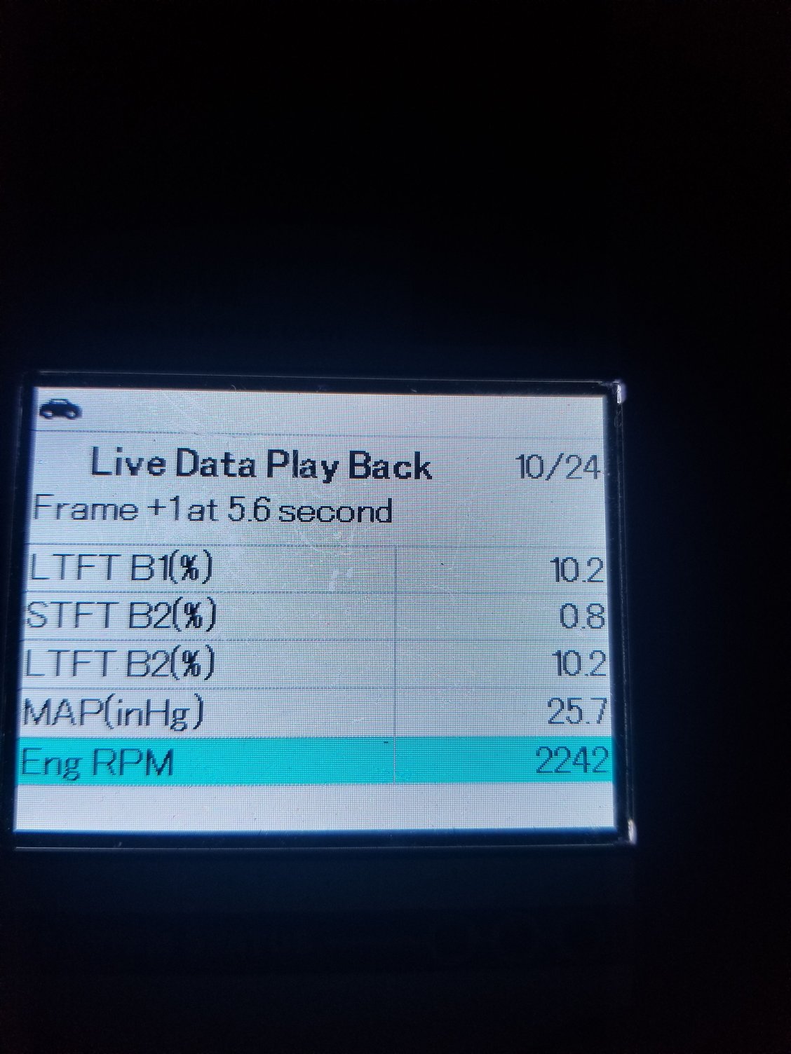

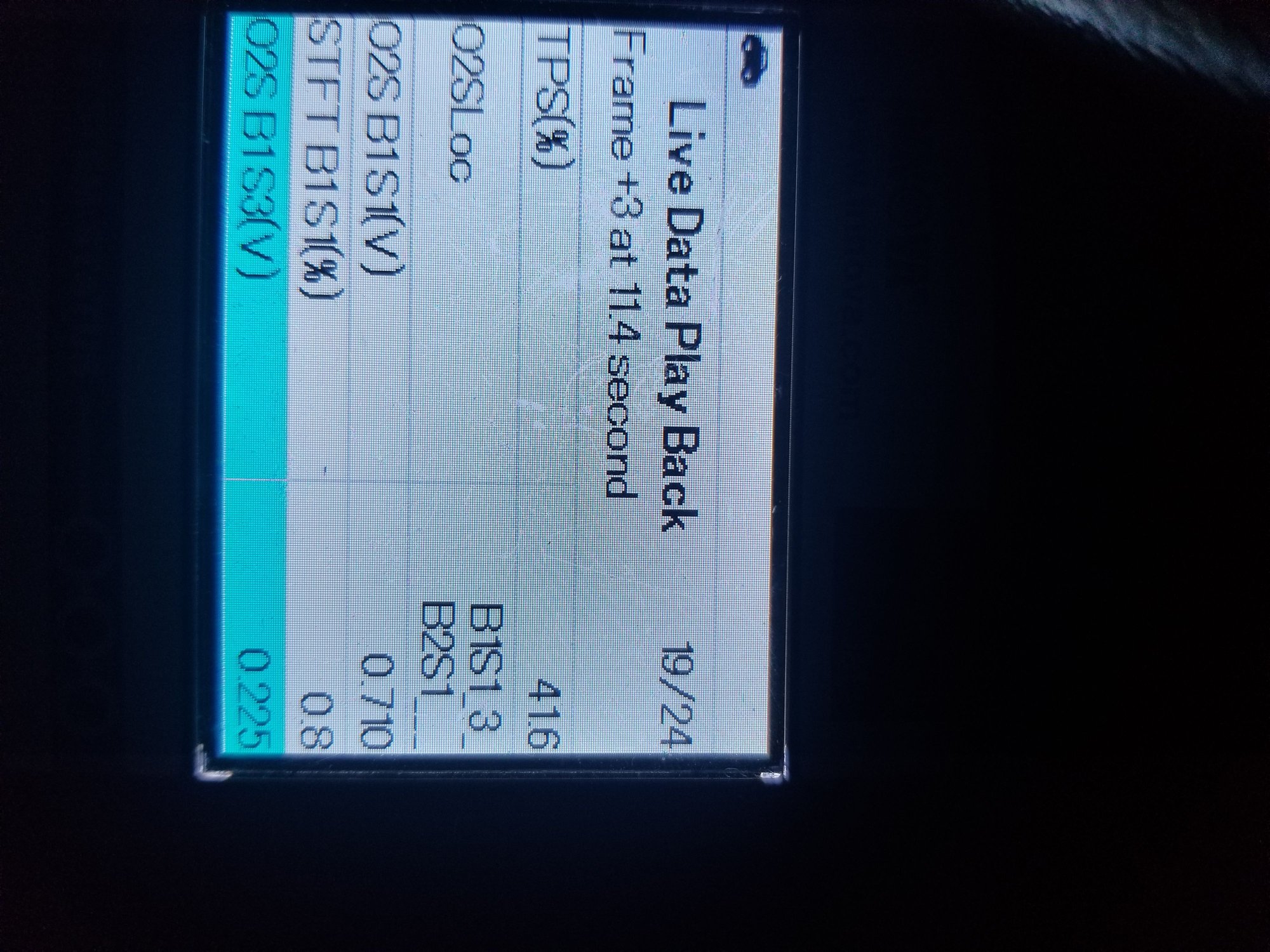

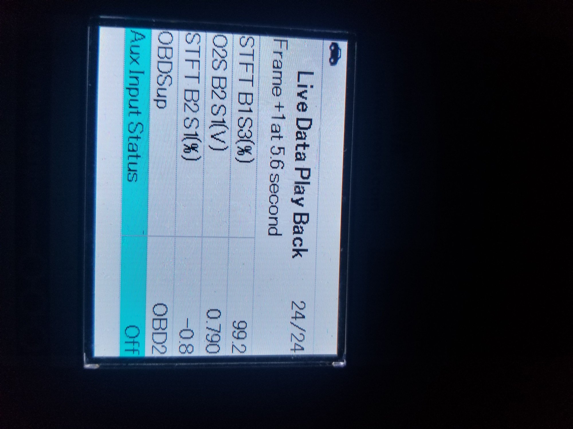

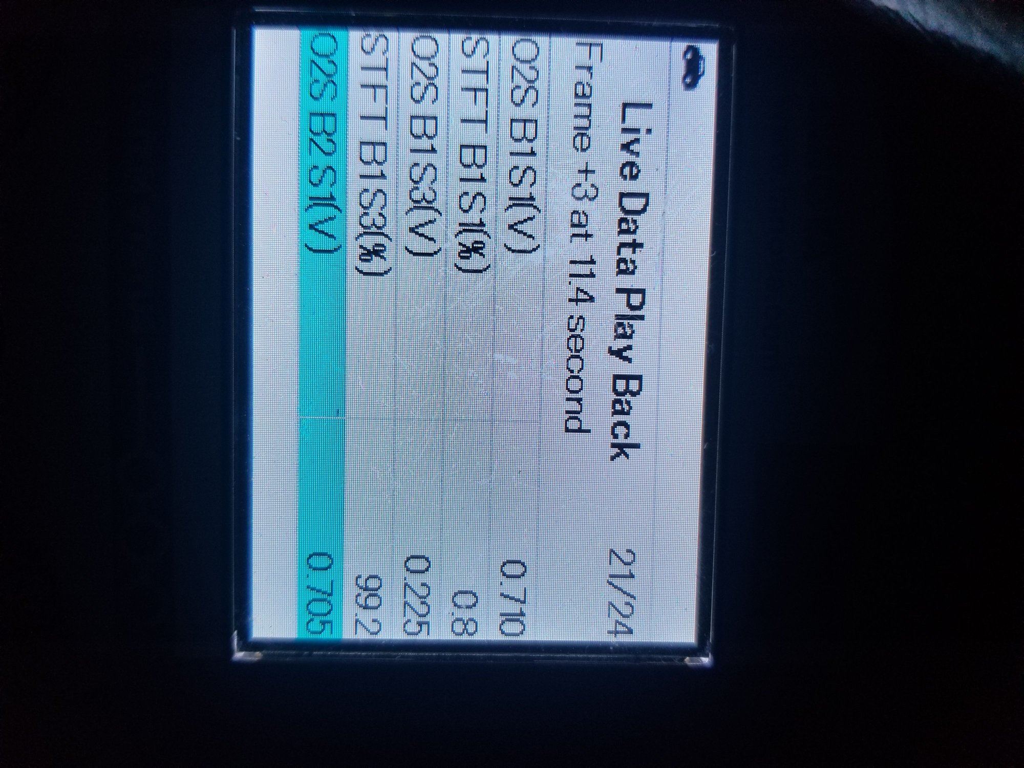

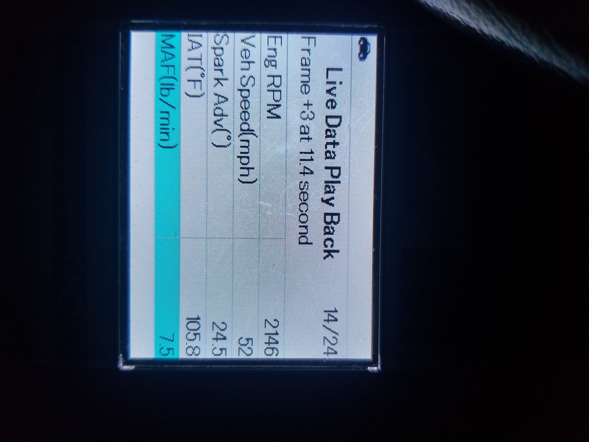

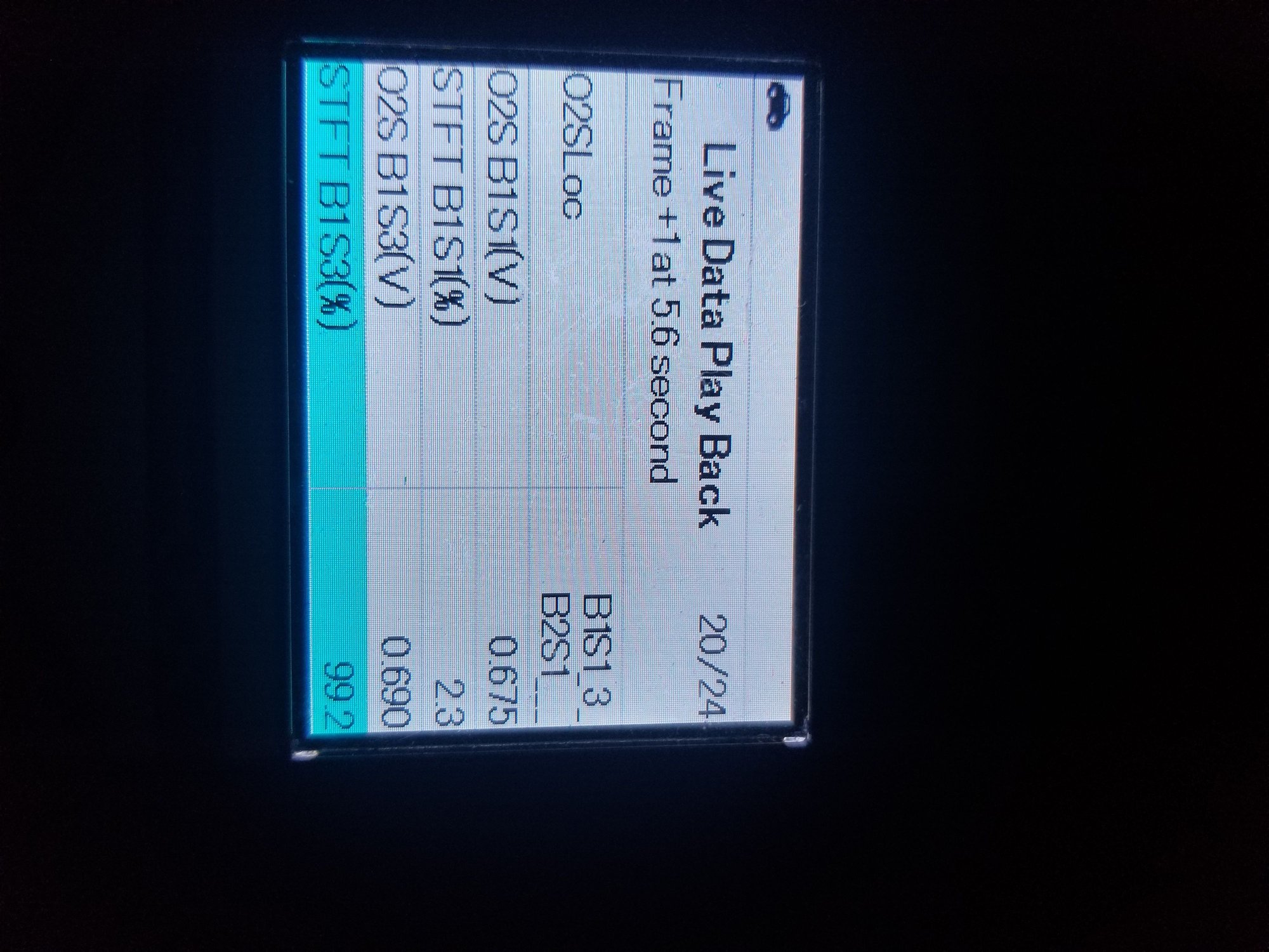

P0452 is an evap pressure sensor low output. This can be the sensor, its power or its ground but it can also be a vacuum leak somewhere in the evap system. This won't cause the engine to run lousy unless there is a problem with the purge control valve and its not closed and sealed for normal operation as it should be because this would cause a vacuum leak. A quick check would be to plug the output of the purge valve to see if that improves anything. A vacuum leak anywhere else can cause problems so get your fuel trims at idle and 2500 rpms to help diagnose a vacuum leak and see if you can rotate your scanner screen shots. Your trims are marginally high not catastrophic but they do show adding fuel for a perceived lean condition. This can be vacuum leak which will get better trims at 2500rpm but it could also be injectors, unmetered air, etc.

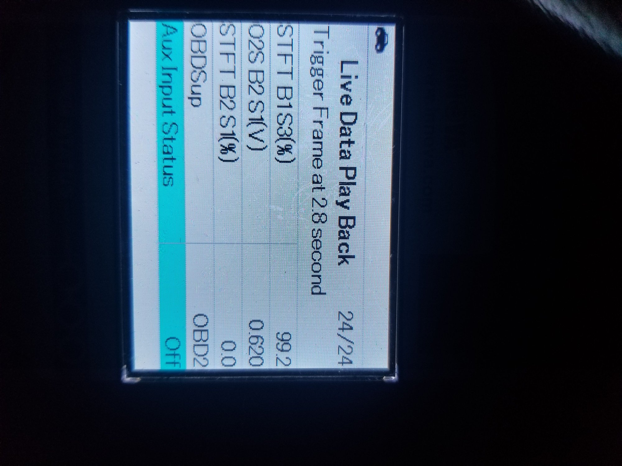

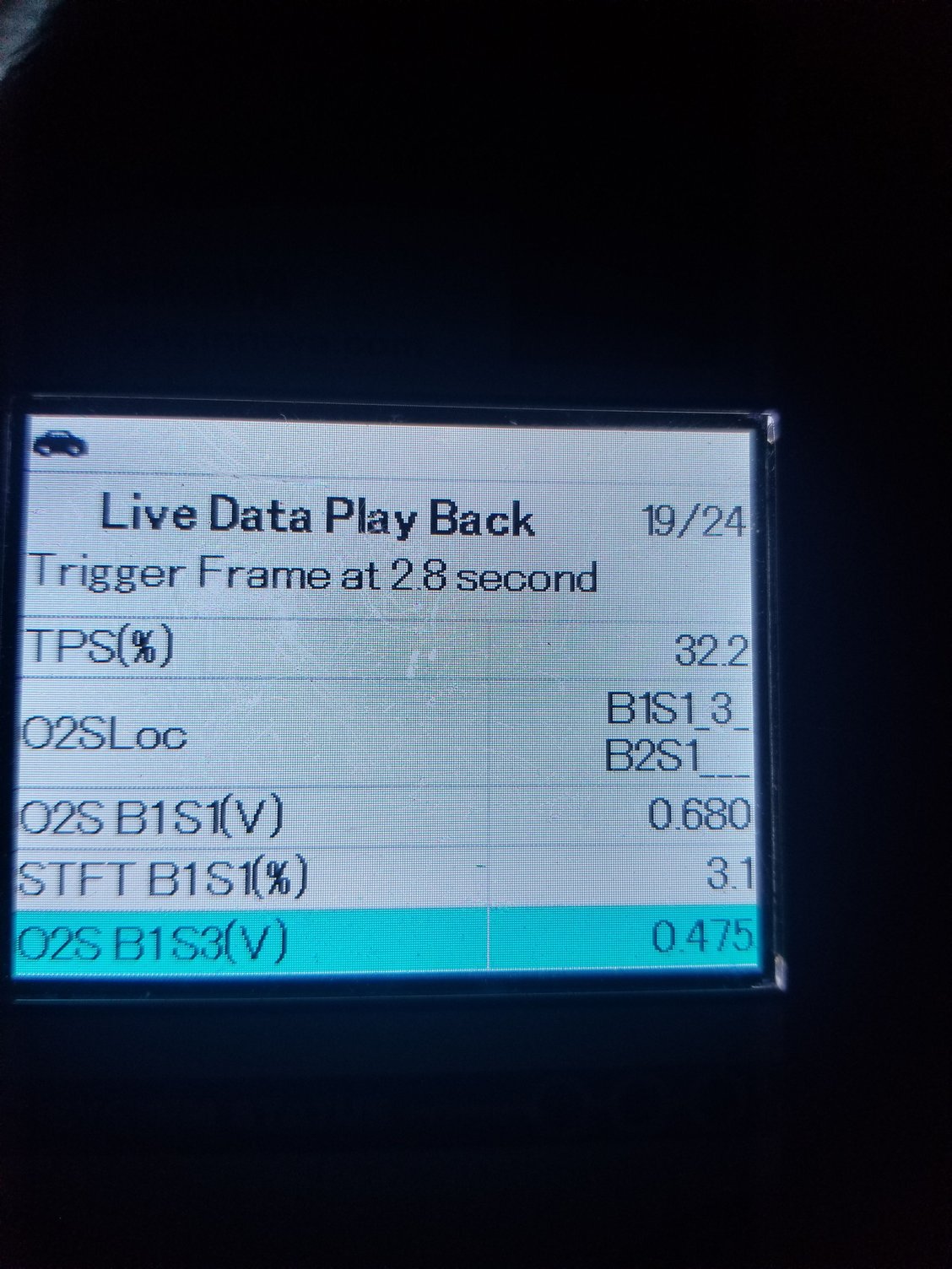

P0420 is a cat problem. This may have no effect on how the engine runs unless there is a problem with the O2 sensors, their power or wiring or the cat is plugged and causing excessing back pressure. We need to see the o2 sensors graphed at operating temperature to see what's going on.
P0405 is the EGR valve. This can also cause problems, do you know if its working correctly?

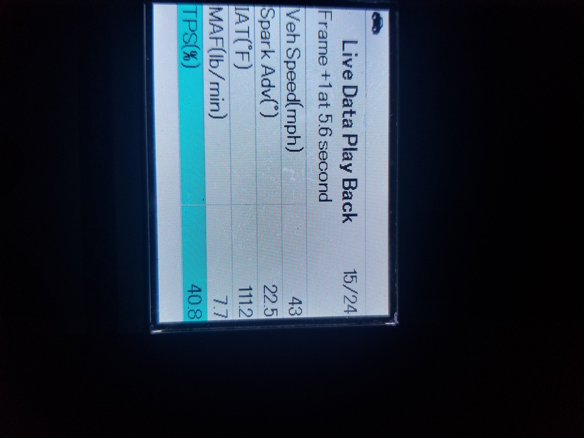

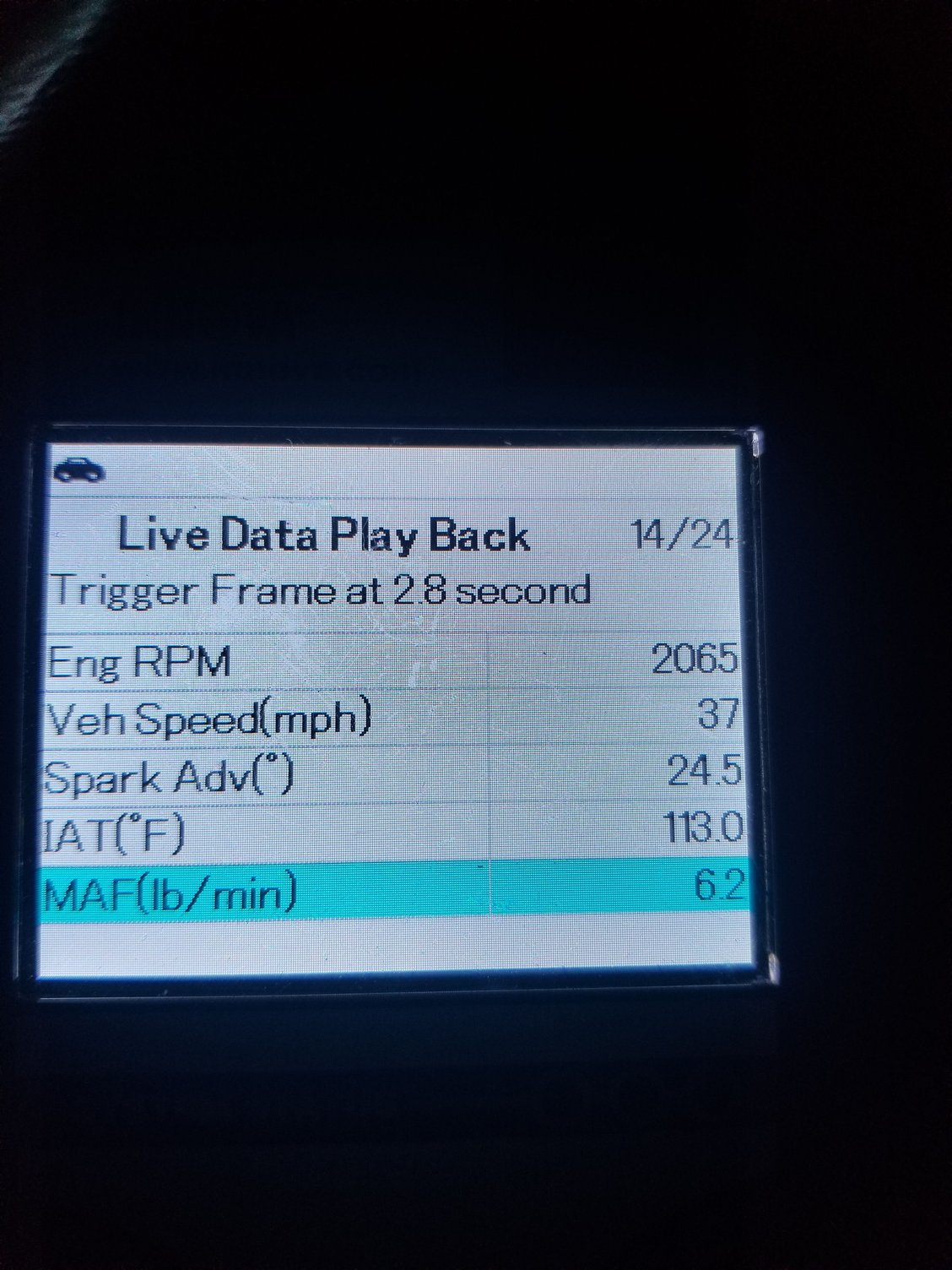

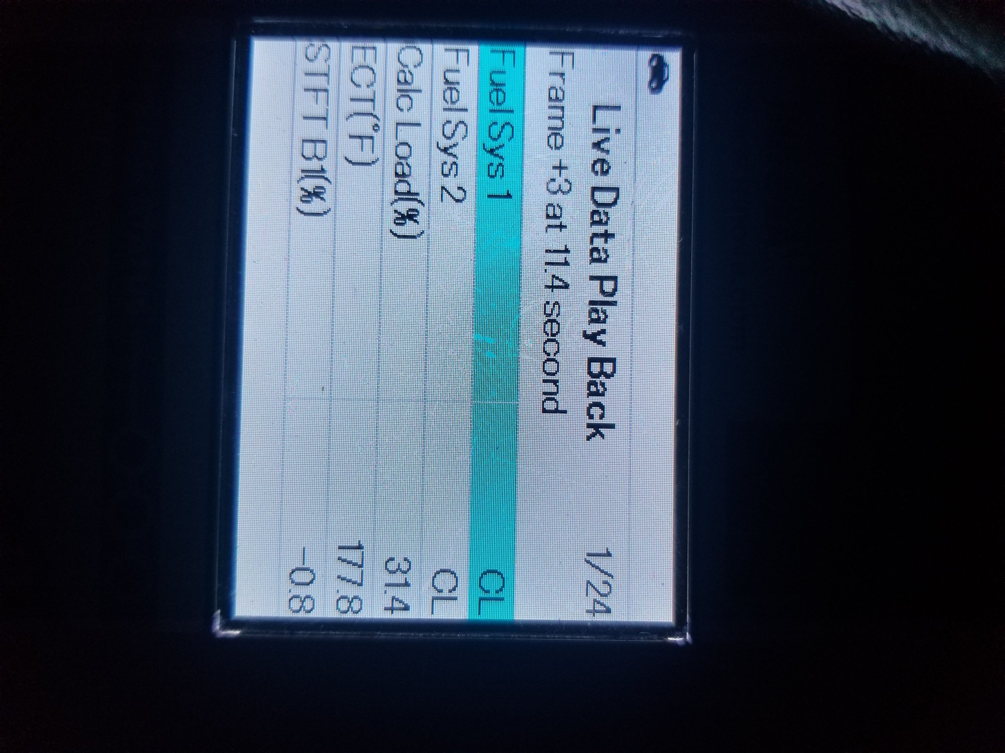

You have posted multiple sensor values. Check MAP, IAT, ECT on a cold engine and compare the values to ambient. Check the ECT at operating temp, I saw a value that looked low. Watch your TPS sensor with engine off key on while putting the gas pedal slowly through the entire travel and make sure that the end values make sense with no glitches in the output. Get your MAF at idle which is a crude check and a start. Full load testing is required to really test the MAF properly but that can be later.

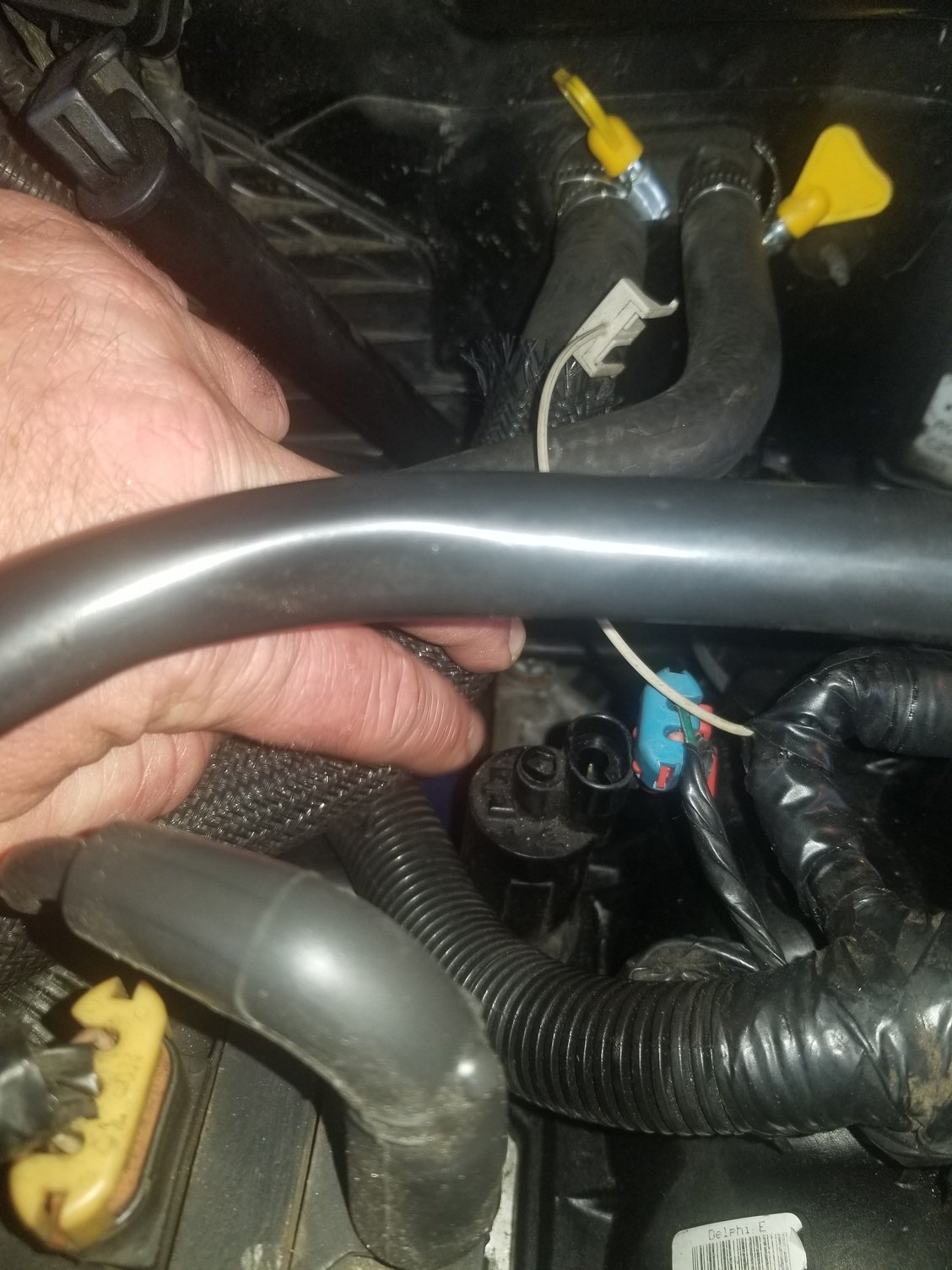

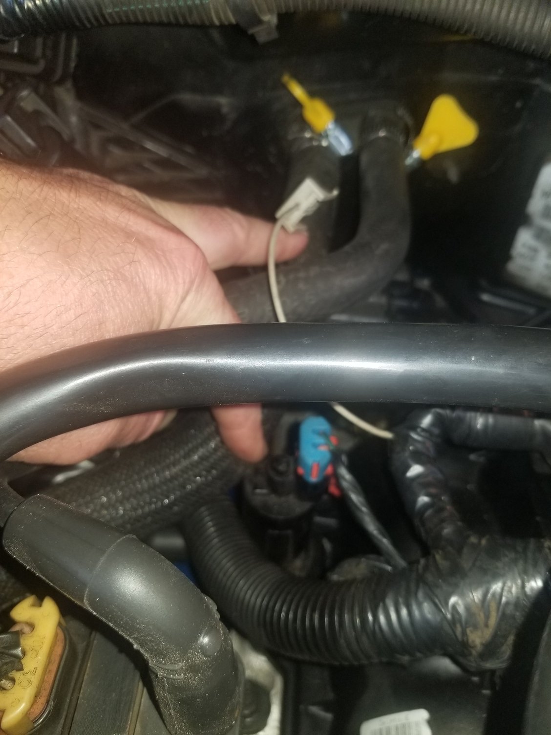

I'm most definitely willing to put in the time to get the blazer running correctly. I have been at it strong for the past 3 months. I appreciate all the information that you guys and gals have given me. I am at Whit's end with this damn blazer it is my daily driver so I can't give up on it like everybody in my family wants me to because they're tired of hearing about it too. So I just keep all the information to myself and do it by myself slowly one problem at a time with you guys's help if possible. I mean this thing has really wore me down. I'm going to post a picture where I think this may be one vacuum leak that I've got on top of the intake manifold plenum I will post a picture. As far as the catalytic converter goes I do not have one so that would be the grounds for the 405 code. I was thinking of doing an EGR delete on my motor but wouldn't that be the same thing as just unplugging the EGR valve electrical connector? Would that help in performance? The fuel tank pressure sensor connector voltage low has been a code thrown since day one since I've had it I'm just not too keen into dropping the gas tank again but I know that I'm going to have to to fix the issue. I've got a brand new mass air flow . But I do have a k&n air filter on my intake that takes oil that could have gotten the maf sensor dirty. The idle air control and the PCV I will be looking into today as well as trying to get you some more readouts on my fuel trims at idle and 2500 RPMs my scanner is doing something weird. Whenever I plug it into the port it was just showing a blank screen. If I keep it plugged in for it a few minutes it comes on. It also takes batteries which I suppose is where you can keep live data stored in memory. I'm not real familiar with reading the outputs of the live data but I know what some of it is but I don't really know what the usual parameters are for everything running. But we can get to that later I appreciate all your help and I'll get back to you soon with some more information thank youPictures to follow.....

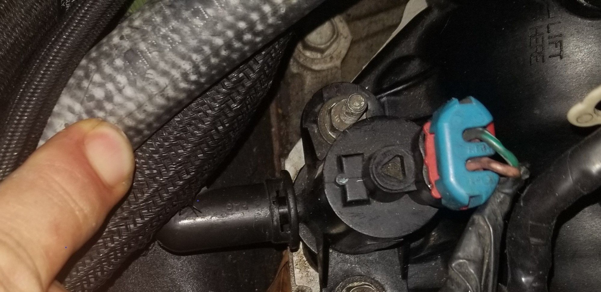

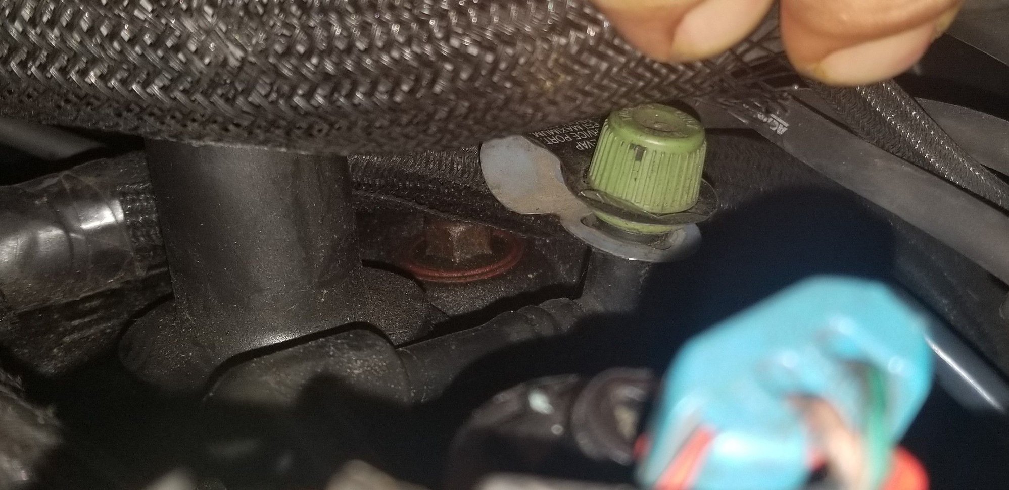

Isn't there some kind of a vacuum hose that's supposed to be on here with this connector that's looks to be broke off. Would cause and vacuum leak correct?

Live data is what your doing when you display the sensor values like in the previous post. O2 sensor graphing looks like this:

Yours looks ok as long as it has the connection at the bottom that runs back towards the distributor. There should be a white clip holding the line in place but mine broke. Also has a green Evap service port cap a few inches down the plastic line.
