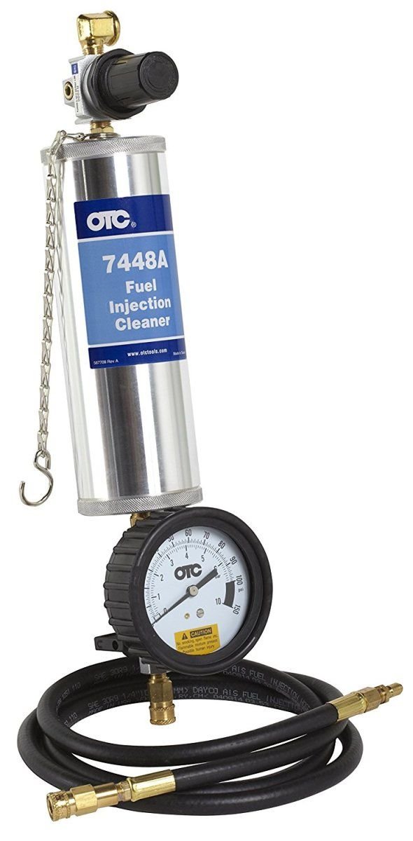

If your goal is to clean the inside of the injectors then your best best is an injection cylinder which pushes a concentrated injector cleaner through the injectors while the truck is running through the fuel schrader with the fuel pump off, no disassembly required:
I don't know if the parts stores rent them.
George
