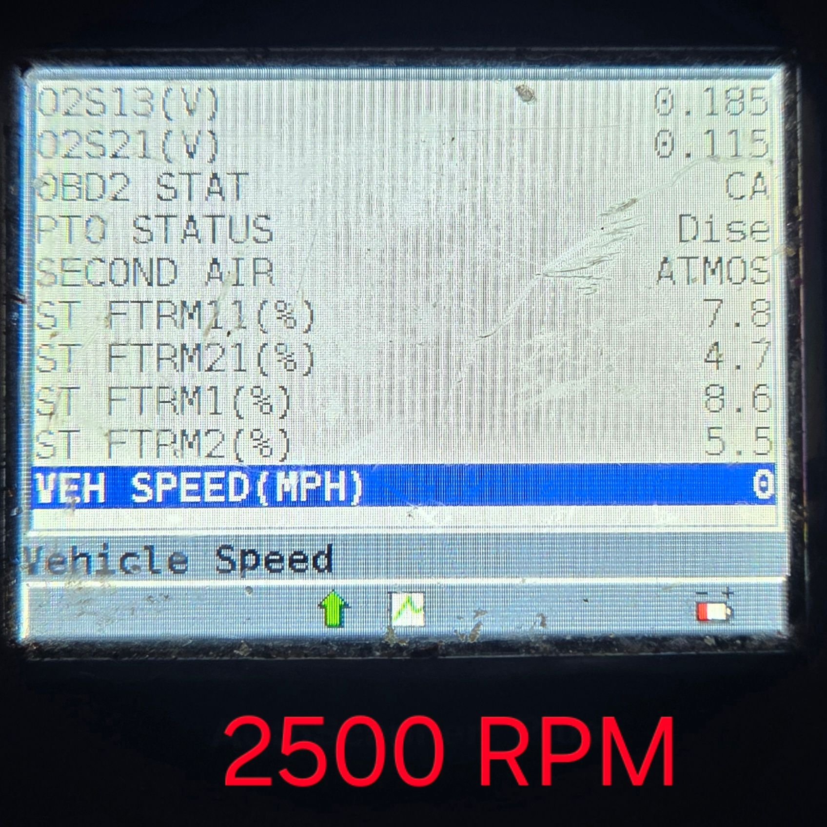

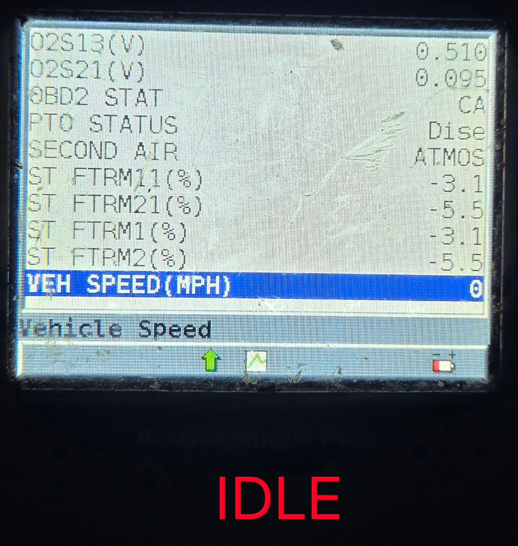

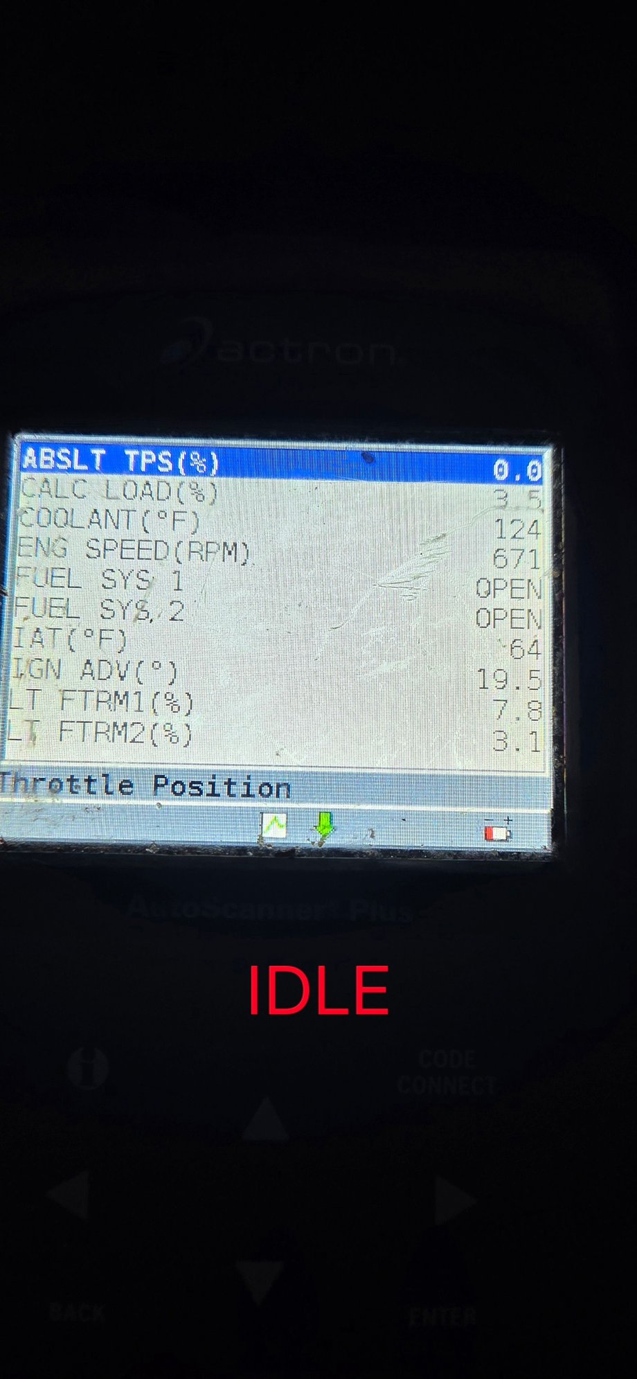

I apologize for being an idiot, but I think I need to order a better scanner to get the readings you want because I didn't see the exact acronyms you used on the live data screen but saw similar ones so I took them down and ill list them below, if I am correct and just need to get a better scanner tell me and as soon as I can get one ill run the thing and get the exact ones you said.
Old Jan 15, 2026 | 08:09 AM
GeorgeLG's Avatar
Posts: 4,635
From: Florida
We can at least get some stuff done with that scanner, including fuel trims. On any given bank at any given RPM you need:
ST FTRm%X1
LT FTRM%X2
where X is 1 for the driver side bank and 2 for the other.
besides, not quite having all eight numbers, the fuel system is still in open loop which means that it’s not yet being controlled by the O2 sensors. I see from the engine temperature that it looks on the coolish side, so try running the truck and warming it up to get it closer to normal operating temperature and see if it converts over to show that the fuel system is closed not open then repeat the numbers.
George

Ok, will do. I already employed a old kart racing trick and I have a piece of plexiglass blocking about 60% of the radiator because this thing always runs cool, it's always ran like 140-160 I believe, because the gauge isn't scaled directly where it sits that's a guess but it's definitely always on the pretty cool side so that piece of plexiglass was to help with heat in the winter but still only gets it to maybe 170? i guess it could get up to 180 but I've never seen it that warm. I'll get to that later today when everyone is at lunch or something.
Old Jan 15, 2026 | 08:50 AM
GeorgeLG's Avatar
Posts: 4,635
From: Florida
If your dash temperature gauge is accurate then it’s a thermostat problem not a radiator problem because the thermostat will just stay closed until you get up to operating temperature regardless of how good or bad the radiator works.
