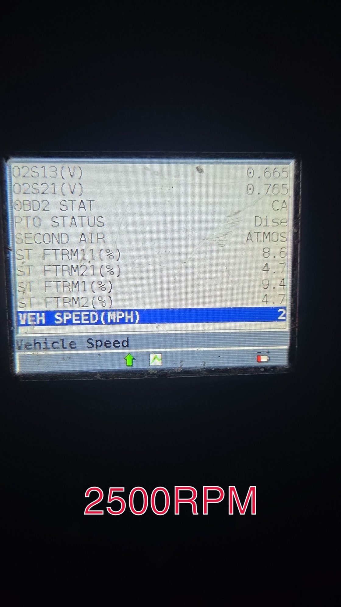

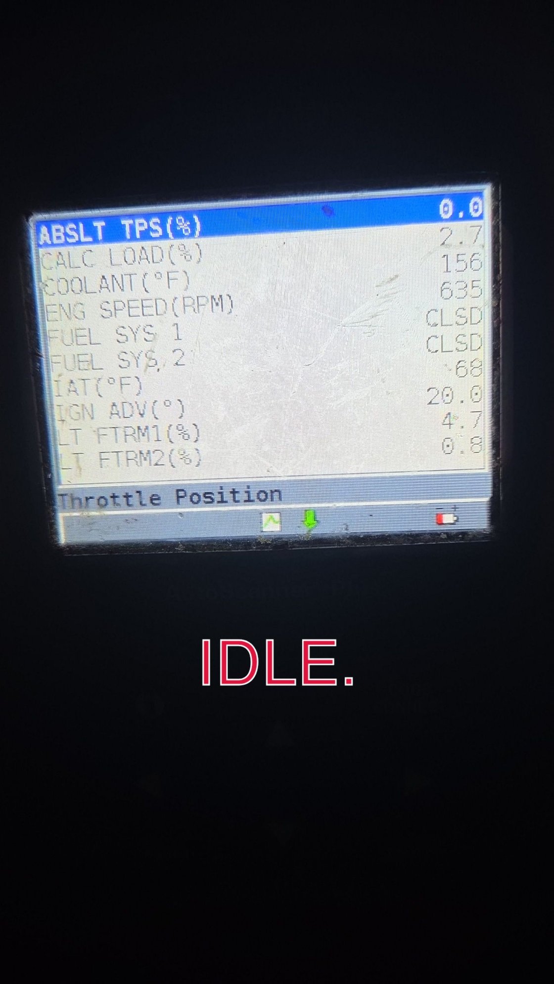

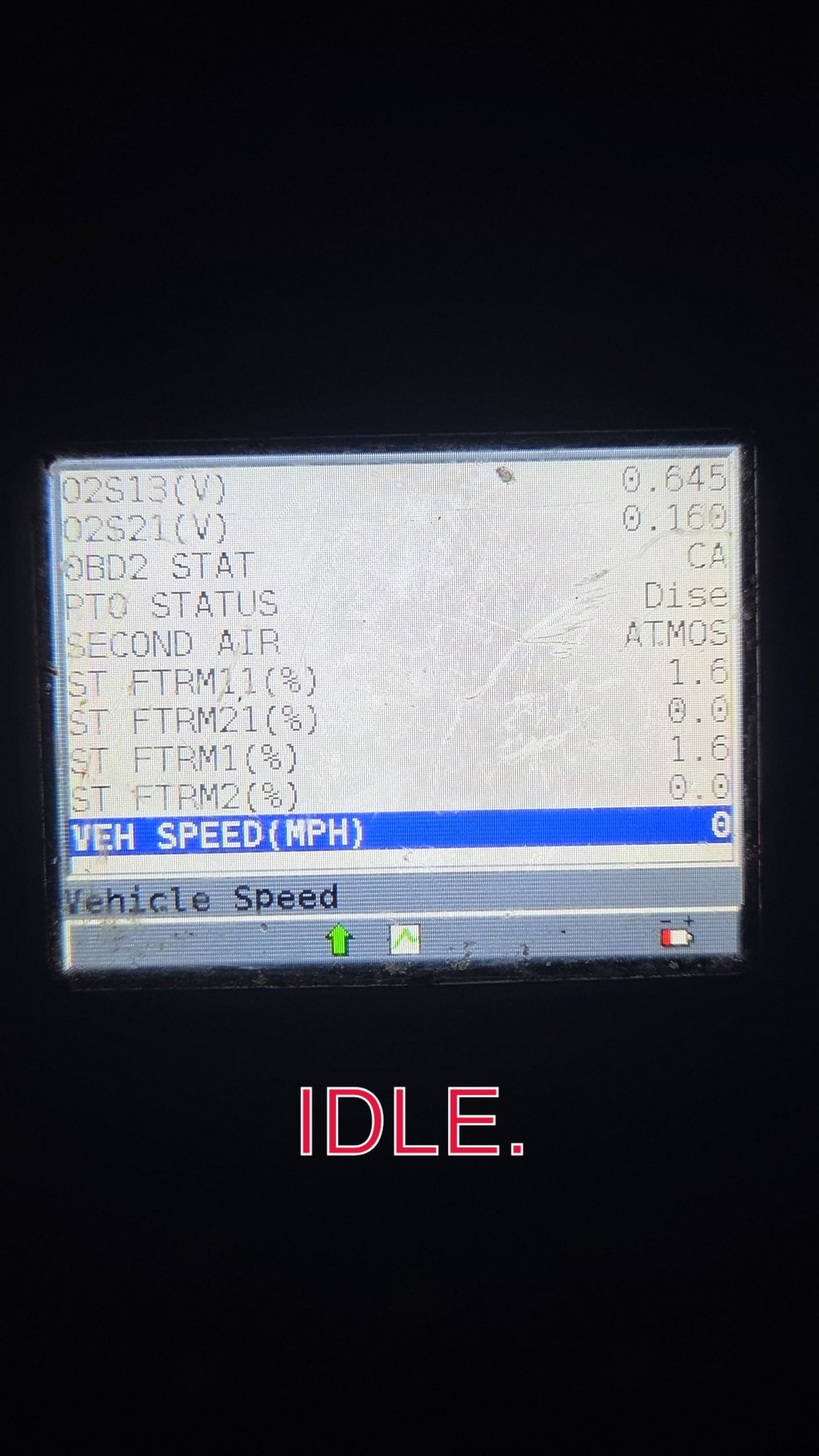

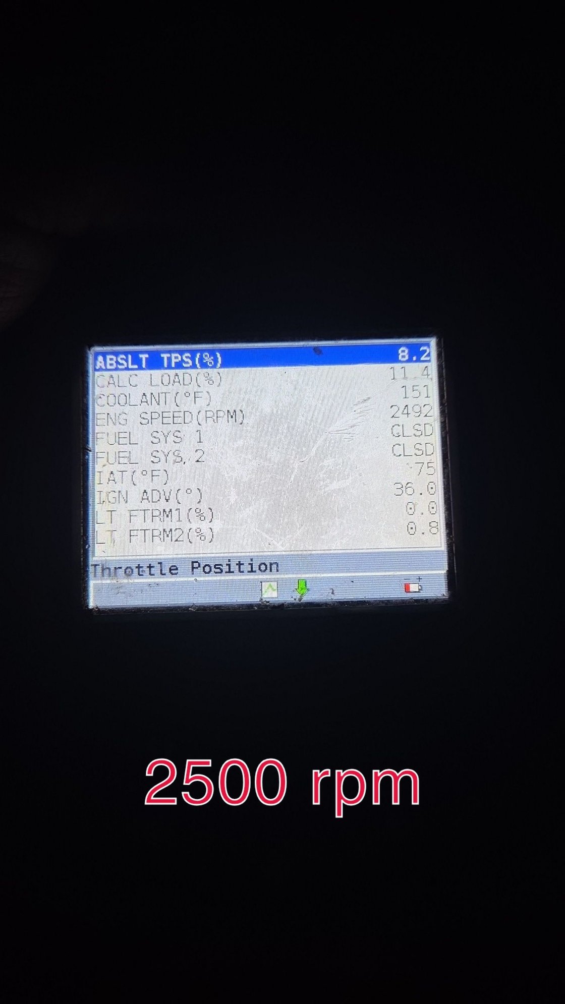

I ordered a thermostat, its running about 25° cooler than normal which I guess could be adding to the problem but I'm sure it isnt THE problem. I'll attach updated photos of the data after a 20 minute drive with ten minutes of warm up.

Your fuel trims are OK so your fuel delivery is not way out of bounds. It also suggests that you do not have a significant vacuul leak. We still need that 10 min leak down fuel pressure.

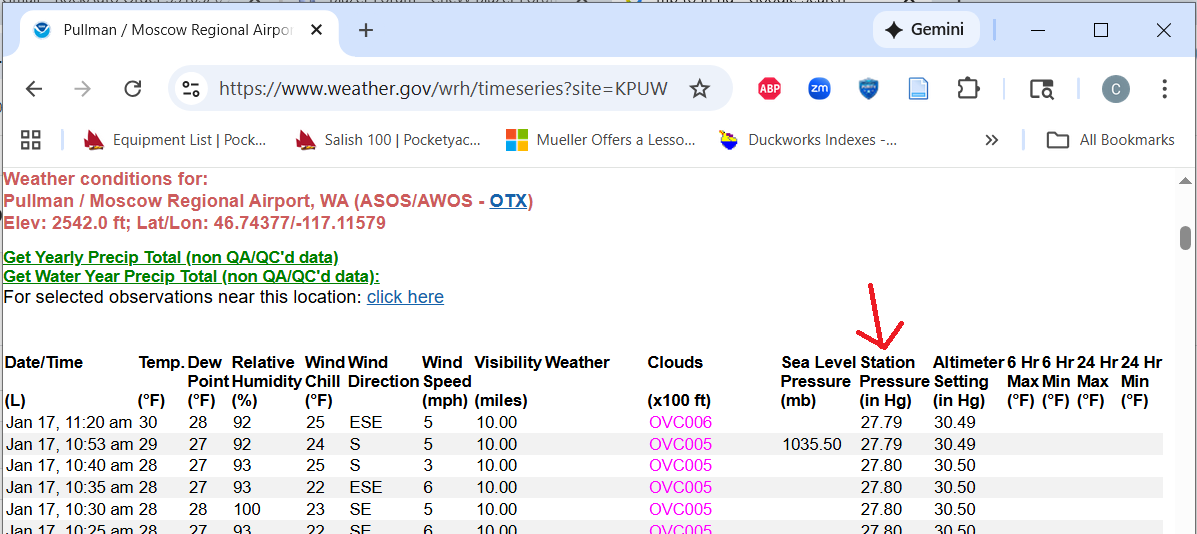

Let your truck completely cool down overnight and then with only key no start tell me the following values:
Barometric pressure and outside temp at your location from a weather source.
George
George, for the barometric pressure would it be the absolute barometric pressure he would need? I.e., The "station pressure" and not "sea level pressure" or "altimeter setting?"

"George, for the barometric pressure would it be the absolute barometric pressure he would need? I.e., The "station pressure"".
Yes, good point. I am so close to sea level that I don't think about this.
