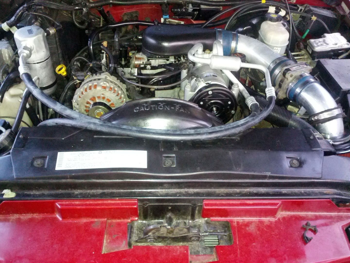

I'm running a similar setup with the Intrepid fans. Mine are just wired to a 3 way toggle switch in the cab controlling 2 relays for high and low speed. They're wired to get power with ignition, with switch in one position has them kick on low speed, one position high speed, and the other position is just override off, useful for water crossings as mentioned above and also tinkering around under the hood when you need the ignition on but don't necessarily want the fans running.
I'd post pictures but I'm at work right now and our IT department has locked down our internet connection so much that I can't get PhotoBucket to load up properly and grab the links... so I can post some later this afternoon. My end goal was to have the setup look basically stock, like the truck could have came that way from the factory, and it came out pretty well.
Old Apr 19, 2019 | 01:40 PM
Never know the wiser looking under the hood, unless you peaked around the upper fan shroud that I kept intact

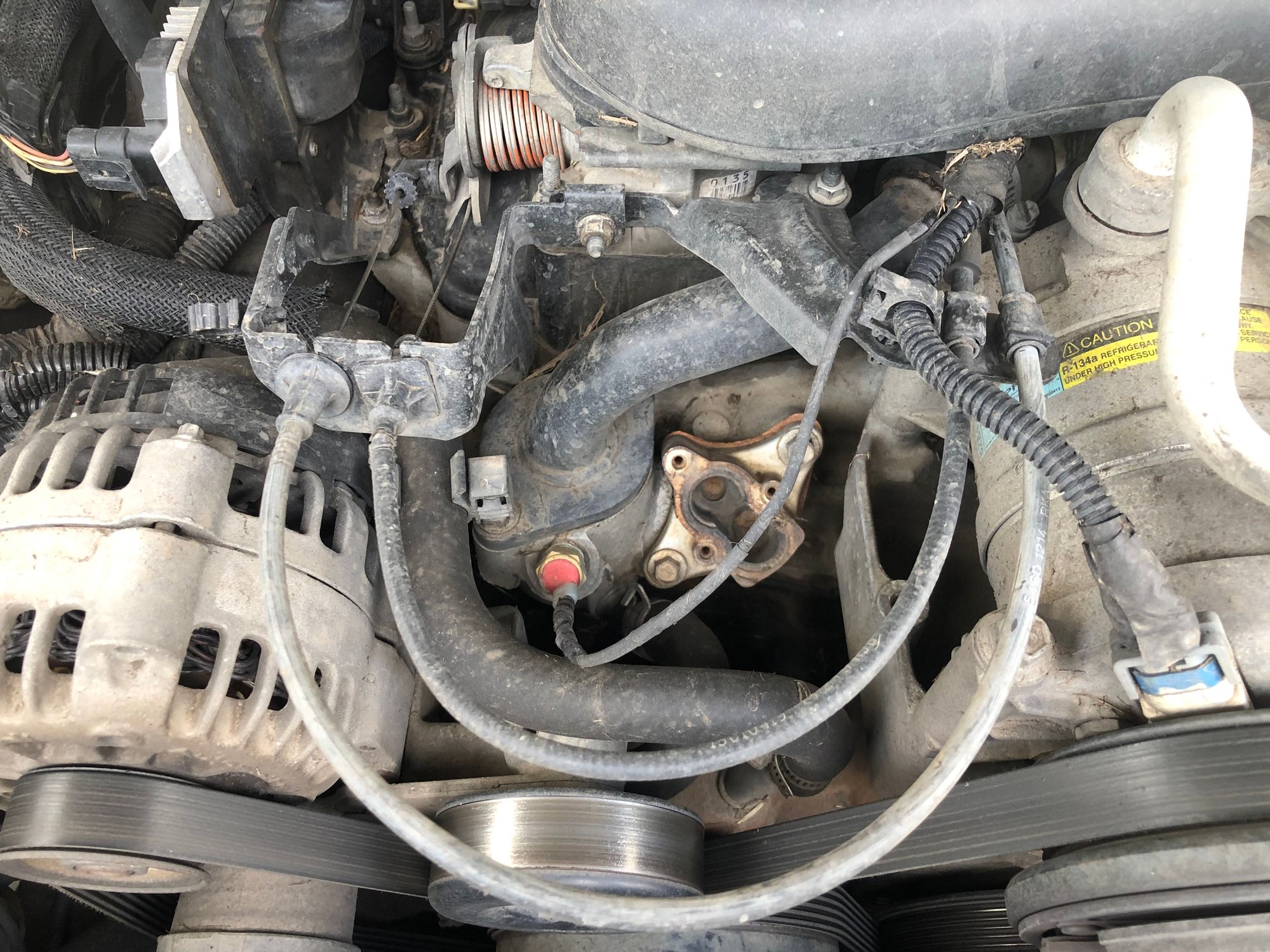

You'll have to excuse my dirty engine bay. I just got back from wheeling through some muddy trails and haven't finished cleaning up.
This is my coolant temperature switch that triggers a relay to turn on the fan when it reaches operating temperature.

Old Apr 23, 2019 | 10:29 PM
I tried a temp switch in the passenger side head for a while. Worked great, when it worked... Although I had the temp switch activating a relay, I had 3 switches fail in the matter of a year before I just gave up with that and wired them to a switched accessory power for the relay...
Old Apr 24, 2019 | 10:20 AM
El_Beautor's Avatar
Posts: 2,753
From: Southern, Alberta
You need to make sure that you use a relay with a flyback diode built in, or add one to your wiring. If you don't the relay opening and closing will kill the temperature switch with voltage spikes. The flyback diode prevents the voltage spike on the trigger line from the temperature switch and protects it. In case you want to know what a flyback diode is, here's the Wikipedia article on them, and here's an article explaining why they should be used in circuits with relays. There's quite a few people on the S10Forum who have run into the same problems as you describe, and using a flyback diode on the relay solves the issue.
I've been using my cheap $15 Amazon temperature switch for about 8 months now without issue.
