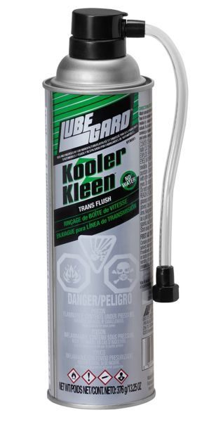

Sounds like a good deal. Make sure you flush the cooler lines before installing the other transmission. Blow compressed air in one line and then the other at minimum. The best would be to use a can of cooler flush to make certain the debris are gone. As far as towing just tow in 3rd gear and add a good plate type external cooler in addition to the factory cooler in the radiator. Good luck

thanks will be getting a can or 2 of it
