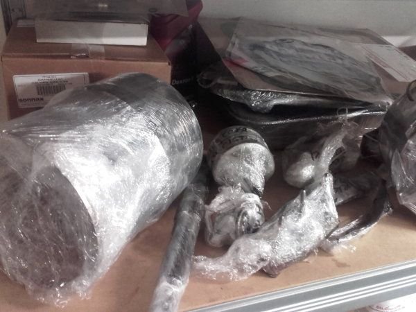

Today I've collected my order with the brake pads I have to do and already collected some preciouses:
I am nearly convinced to follow the performance build option. Well, maybe without a transbrake feature

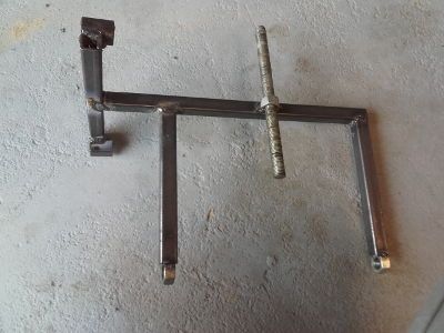

First thing I did was to weld the holding support for the transmission:
I've made a few mistakes here First is that I've welded it in way, where the center of rotation isn't the center of mass. Therefore, rotating the transmission isn't handy. But I can live with that. The second one - I should have weld the nuts stronger to the profile. I eventually put the welding joints on their sides. I have used the 20mmx20mmx2mm thickness profiles, they seem to do the job. Anyway, I am happy with the end result. My inspiration here were the brackets that are sold for over $150 on ebay.
So, the transmission landed into the bracket, I've put the box underneath, as there was still some oil dripping from the inside. I've started dropping the oil pan and generally doing things as described in the manual I have.

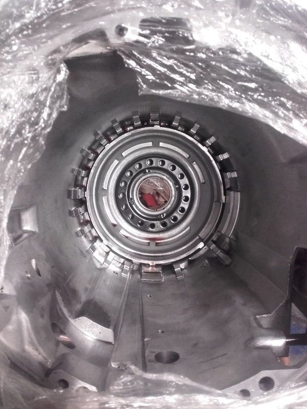

Slowly tearing it apart, I've filled in a big shelf of main parts wrapped in plastic. I am doing this rebuild in the meanwhile, so it may take several months, so I prefer to keep everything together and protected.
So here's a photo how it looks today:
