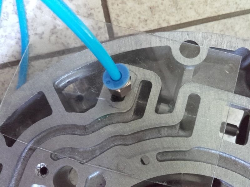

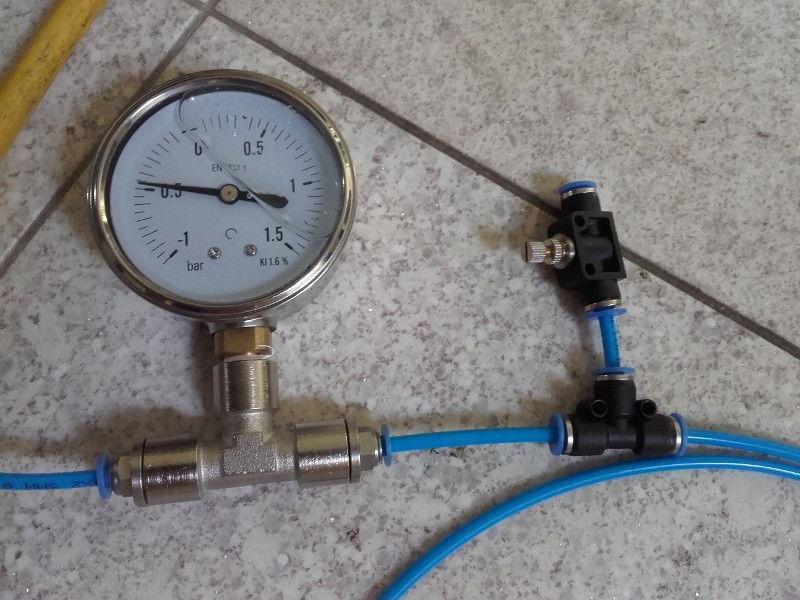

OK, so first thins first.
How is the Sonnax pressure testing device work? By looking that movie:
I've figured out it has a following setup:
Left to right: vacuum supply -> manometer (unfortunately I have to convert from Hg to bar and vice versa) -> valve for calibrating -> measuring plate
Total cost: $12 (not including the gauge I already had).
Adjusting procedure:
  • shut off the flow at a probing plate
  • adjust the calibration valve to get -25Hg (-0.85bar). The ambient flow to a vacuum pump is required to make the measuring method time independent (as on the picture above)
  • open the flow from the probing plate

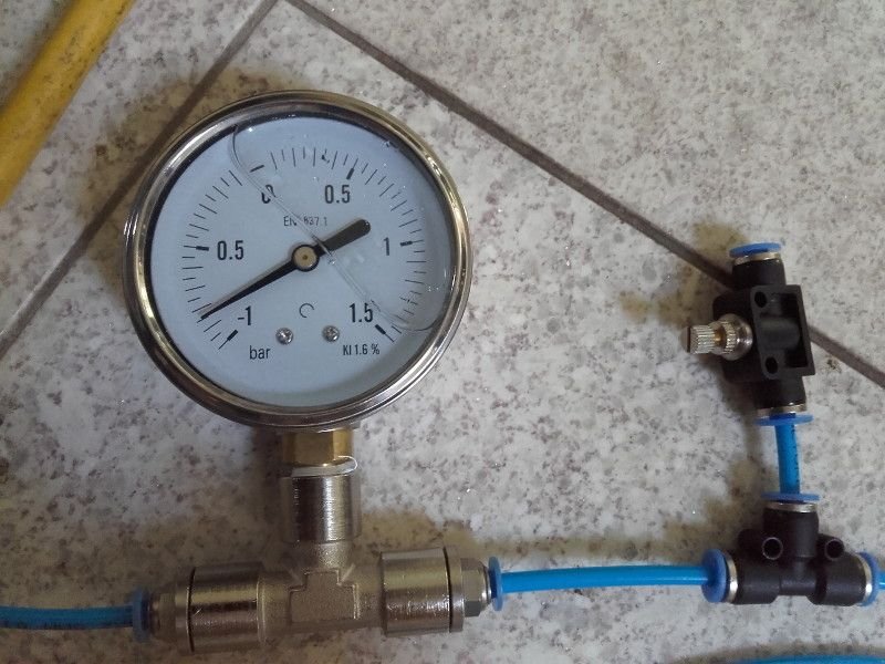

Measure the pressure:
Read the indication:
So, in my case, the pressure regulator valve builds up to -0.45bar, which is approximately -13,3Hg.
EDIT:
Sonnax has published a nifty PDF pointing the 4L60E vacuum test points(https://d2q1ebiag300ih.cloudfront.ne...f?v=1526932555)
Following the diagrams:
TCC apply valve: -19,2"Hg (18"Hg nominal) OK
Pressure regulator -13.3" Hg (18" Hg nominal) Worn
Boost valve -21.5"Hg (18"Hg nominal) OK
Now I know where I am at.

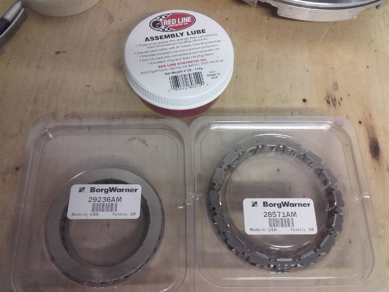

Meanwhile I've got the assembly lube (locally) and collected a parcel with sprags:
