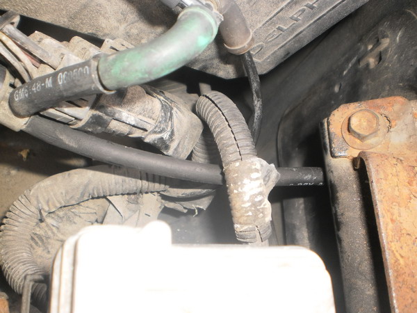

FIXED IT!!!
happened to be poking around my vac lines under the hood and found this loose and flopping about:

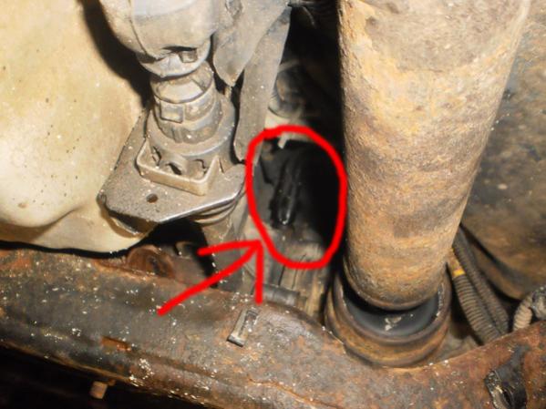

After some head scratching and looking about with a mirror I found it went here:

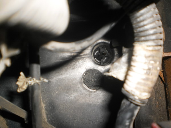

on this nipple hidden away underneath and in the fender:
I thought the 2nd gens diddn't have a vacuum reservoir - turns out GM just hid it in the fender!
Once that was re-connected I then determined the vacuum line was also split right down at the transfercase...again...

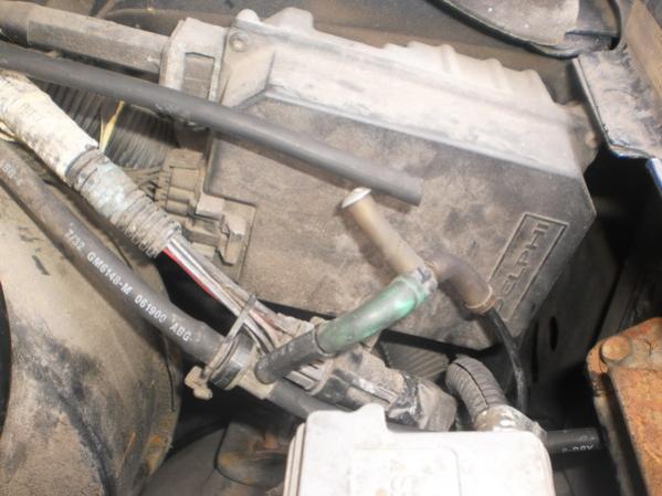

Did this as a temp fix till I can get a roll of vac line and re-run it:

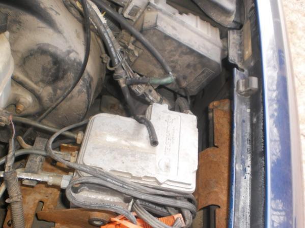

you can fold the line headed back to the t-case over double like a garden hose to see if the leak is back there - I set the vent to defrost and when i pinched the line it would finally switch on properly
The little skinny black tube on the right heads into the cab for the HVAC controls, the one I've got disconnected goes back here:
(transmission left, front driveshaft right - pic taken facing the rear of the truck)
My hoses under here are cracked/ripped in some places and folded over in other places - I'm going to run new lines
