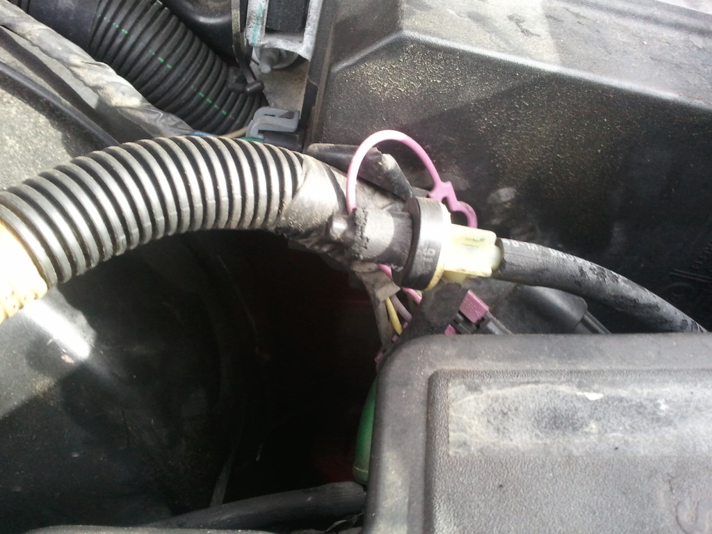

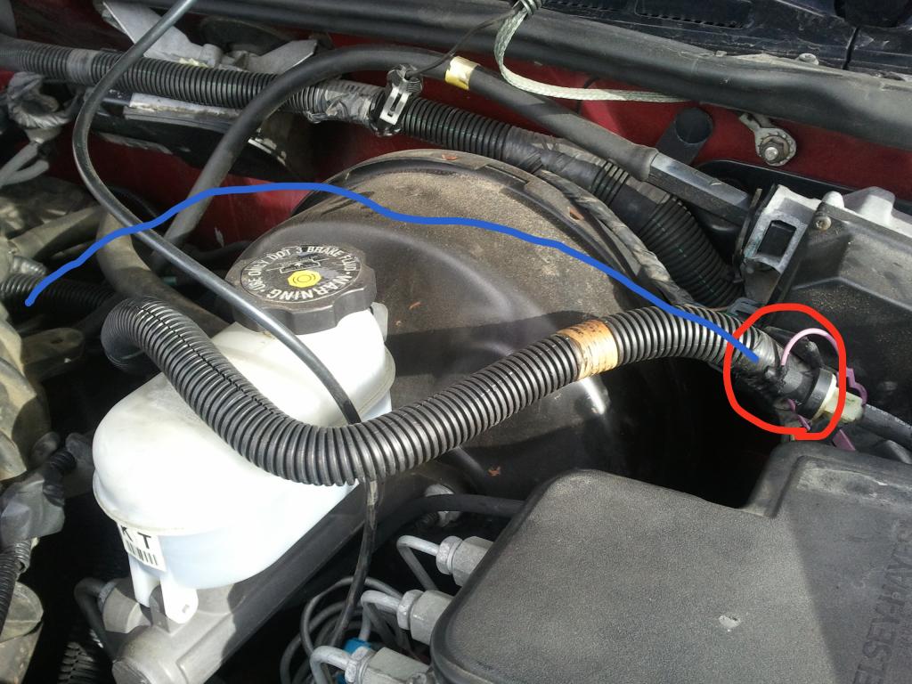

After looking at all the pics that have been posted and researching it more here on the forum I discovered this.
The whole hose was gone and I never noticed it when we did the motor swap. The hose goes from the check valve to the top of the manifold.
After I put a new hose on, the air will now switch between the defrost and the vents, and the 4x4 works. Who woulda thought huh.lol Now I am wondering how much the missing vacuum hose affected the performance and MPGs. We have been getting horrible mileage and I am not sure if this had anything to do with it.
Thank y'all for posting all the info and sharing pics!!
