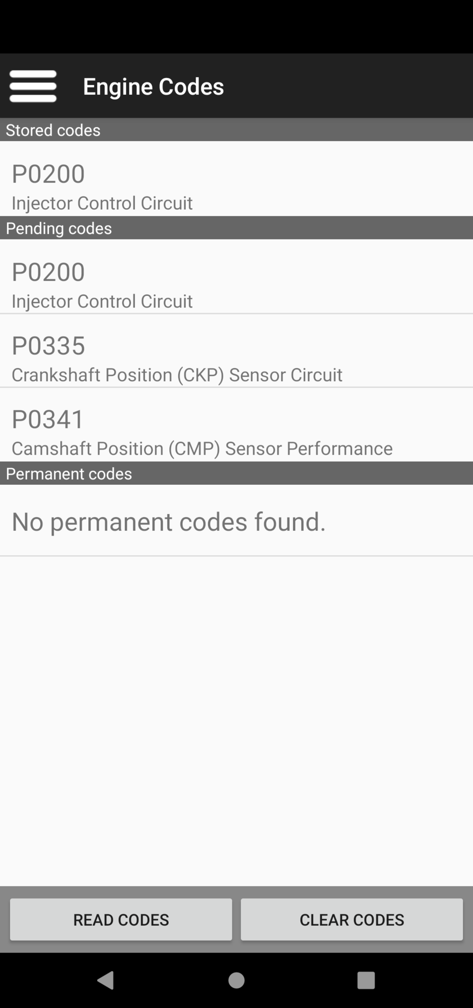

OK - lock it down on -3.8 and we will start to diagnose the P0200, which I suspect is your real problem. I take it that the SES light comes on, correct?
First clear all codes.
Run until SES light comes on
Read new codes and report please.

Old Apr 16, 2022 | 05:02 PM
  #40
Wytepirate's Avatar
Joined: Feb 2022
Posts: 45
Wytepirate is on a distinguished road
Also my CMP ret is at -31.2 now??
