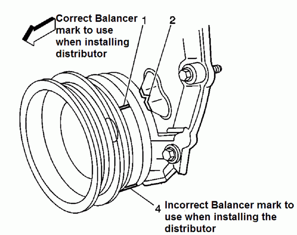

Originally Posted by Wytepirate
Ok I've got #4 cylinder at TDC compression stroke, and #1 cylinder is at TDC exhaust and the ting marks on the balancer are not lined up with the case marks. Are they supposed to be?
This is how it's supposed to look.
Is that what you have?

Wytepirate is on a distinguished road
This is the alignment of the marks with #4 cyl at TDC compression and #1 is at TDC Exhaust.
One mark is highlighted in silver and the other highlighted in blue. As you can see the pointer on the case is sitting near half way between the two marks.
Old Nov 16, 2022 | 12:09 PM
  #59
Yeah, that's not right. Just to reiterate, how did you confirm that #4 is at TDC? Did you end up removing the timing cover and lining up the marks on the gears?
The best way to find true TDC is with a piston stop in the spark plug hole and a degree wheel. Unfortunately, most people don't have either. If you're positive it's at TDC now, and the marks on the balancer don't line up, then the outer ring on the balancer has probably slipped. But the fact that it doesn't run when it's set that way leads me to believe that it isn't really at TDC when you think it is. Have you tried lining up the marks like they're supposed to be, and installing the distributor according to that?

The distributor has been set by using cylinder leak tester hose to feel air blow out when #1 came up on compression stroke. Then I lined up the balancer marks like your illustration shows. I set the distributor to the #6 stamped into it's base. Truck wouldn't run at all. If I moved distributor 1 tooth clockwise it would run but poorly.. looking at where these marks are at TDC I can see why..My best guess is that the balancer ring has slipped a good bit.
