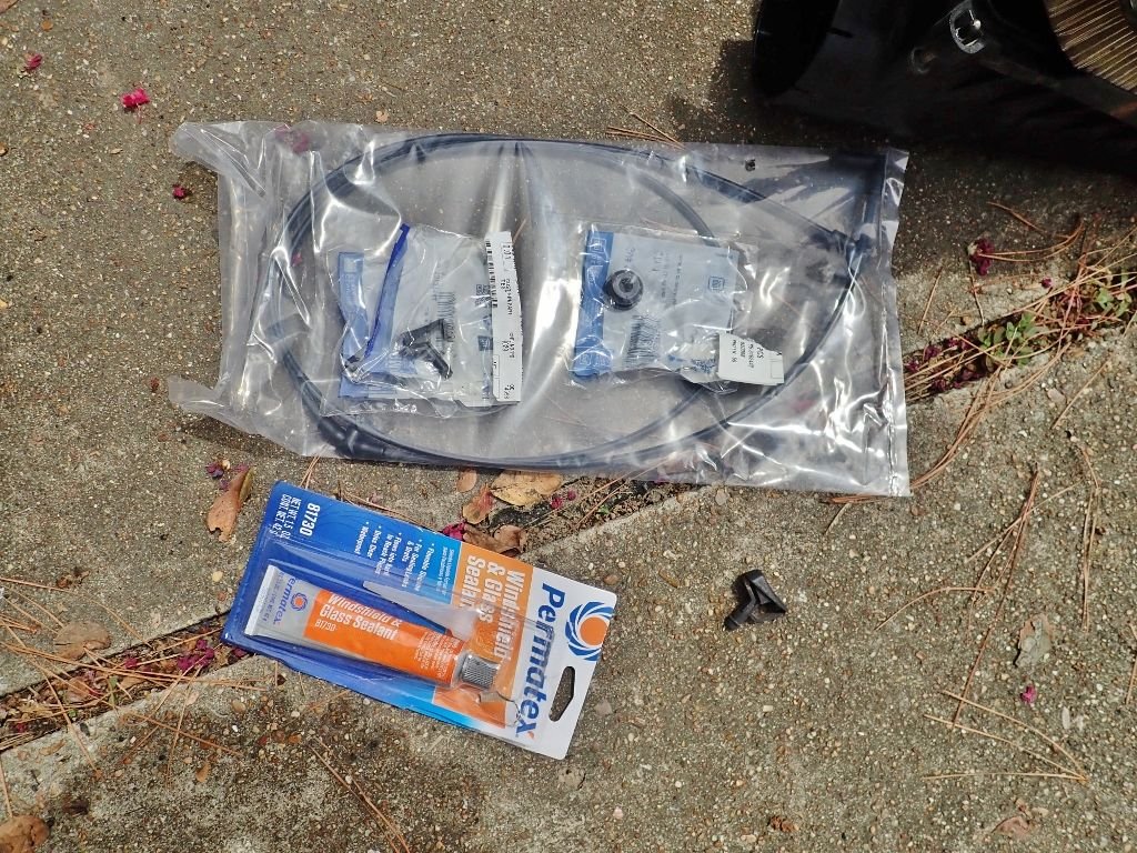

First step, order the parts.
Plastic hoses get brittle after decades in the Texas sun and develops cracks. This hose runs from the water tank pump to the two spray nozzles on the hood.

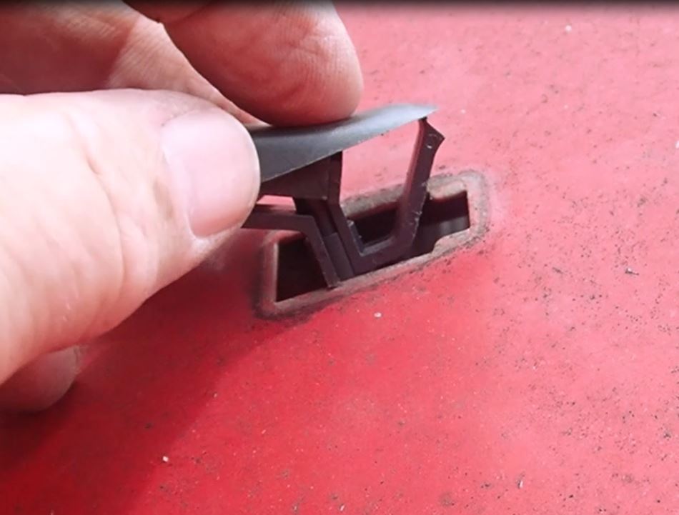

Two spray nozzles on the hood. I didn't like the price on the squirt nozzles, but it's what everyone was asking. I tried cleaning mine out by plucking a single strand from a wire bristle brush, and using that to poke inside the hole to clean it out. But it didn't help. So I spent the money on two new ones.
A week later, all the parts had arrived, and I'm ready to do the job. Plastic water hose and spray nozzles. With some silicone sealant to make sure old rubber seals are waterproof. The rubber grommet was for the air intake, unrelated to this fix.

Installing the new spray nozzles in the holes on top of the hood. I finally figured out that you tilt the front down and insert it first, and then snap down the back.

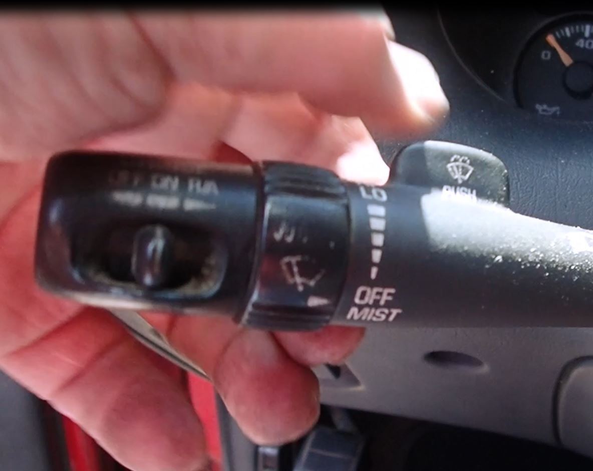

Everything reassembled. Tank filled with water - no leaks. Phew! The final test - click the window washer tab and see what happens. It works! It scared me for a second before I realized it had to pump the water up from the tank through the new hose - there was no water already primed in the system. Ta da!
