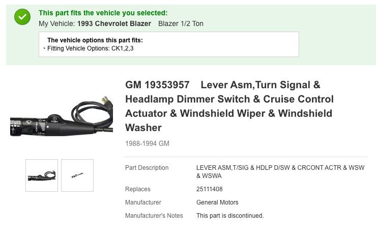

The multi-switch on my 1993 has cruise control on it. I can't seem to find a replacement part anywhere - all of the ones I can find do not have the cruise button on them.
Just wondering if cruise was an original option in 1993? And was it located on the multi-switch stalk on the column?
I found this, but it says it does not fit my vehicle (though it looks identical):
Amazon Amazon
Any help would be appreciated (wipers only work at highest speed right now).

I missed the forum it was in. To answer your question, yes it was available in '93 K5. It appears that all the GM cars trucks used the same stalk for that time period for that type of cruise control setup. Attached is a pic from the '93 K5 service manual. So if it looks like the same stalk you have, is for GM and for under $20, I'd personally go with it.

Thank you for the photo! Much appreciated! Any chance there was a part number attached to that information?
I think I might order the one from Amazon, it can always be returned if it doesn't work...
Thank you again for taking the time to reply!

It seems the correct part number is: GM 19353957
