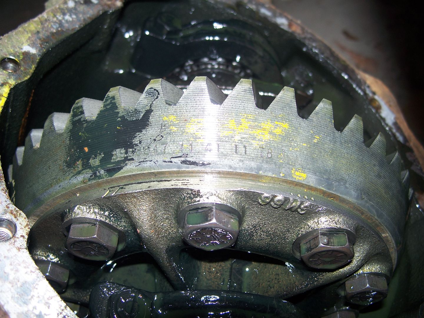

Posts: 41,345
Here is a picture (see below) of the numbers that abig84 is speaking of. You may have to rotate the ring gear around to find them.
This picture shows a GM Corp 10-bolt front axle, but if your rear axle is stock, it may be a 10-bolt as well:
Here is a shot of a GM Corp 14-bolt Full Floater I have in the shop now:

You can probably count the teeth.

yeah sorry i wasnt more specific on where the numbers are i was probably posting from my phone and hate typing out long answers. if your able to see all the teeth on the ring gear and the pinion gear thats just as good as finding the numbers on the ring gear.
