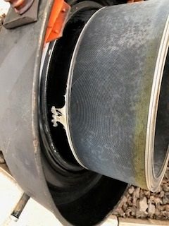

This might be silly but I can,t find a picture of the inside of the factory air cleaner. does anyone have a picture of the inside?
Mine has a large factory looking air filter or spark arrestor inside glued in. So basically It's going through two filters.
The reason I'm questioning it is because the install looks like some one just used silicone to keep it in place.
Yes i just bought this and its running very rich and wont pass emissions. plus it idles good and runs good until I go for hard acceleration and then it bogs down.
Just starting with basics before I have the carb rebuilt and replace cat converter
86 k5
I have already done the plugs, wires, cap and rotor.
Currently replacing all vacuum hoses too.
Thank you in advance!

Where is the 2nd filter you mentioned? From those pictures, it looks like that is just one filter, the big round one which is the factory style filter. As far as what that gum looking stuff is at the bottom of it, who knows.I would definitely be replacing that filter as it looks to be way past its useful age. Those pictures are quite small though.

That's the deal i was talking about.
then there is a normal filter that we all think of that goes on the outside of that.

all I have ever seen is one. i don't know what the hell that is. if it was factory or what. and someone just left it there, but between that and a normal filter i'm pretty sure i can conclude there was an air restriction

I think that's sort of a charcoal canister in there, meant to catch fumes from the carburetor. I've seen them before, but it's been a while.

I just looked at RockAuto and there are filters for your application that come with a poly-wrap which is essentially a foam pre-filter on the outside of the paper main filter to collect larger debris, but I'm not sure that is what I'm seeing in your photos.
I think we can all agree that you need a new filter in there though! See where that gets you and let us know!
