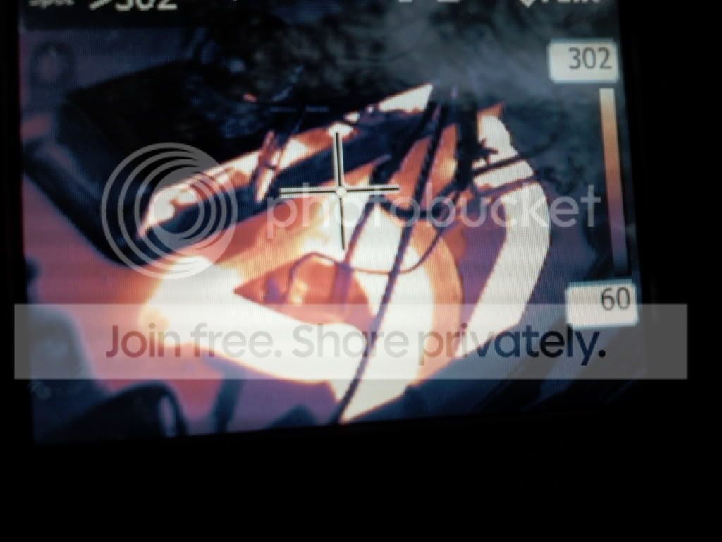

oh and i found another problem... im only running on 6 cylinders too. my dad came home and he gets to work with some pretty sweet toys and he brought home a thermal camera.
numbers 5 & 8 are not firing and i am hearing a bit of backfire so i think that is the problem. im checking the plugs and the wires today. pretty nifty toy huh?

so after taking the cap and rotor off and cleaning them up a bit im now on all 8 cylinders.
