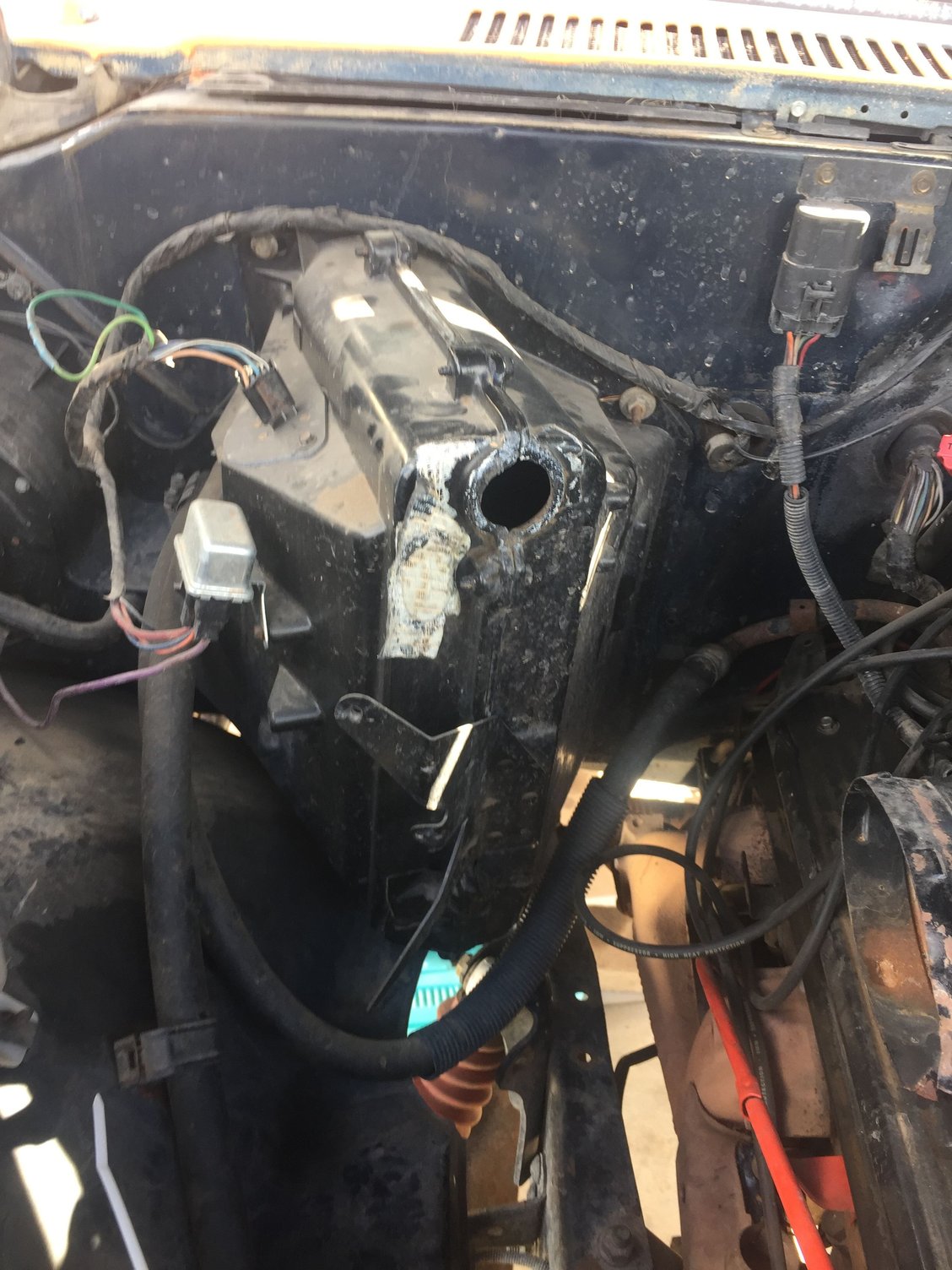

Hi all, long time browser first time poster. Anyways a few months ago I picked up a lifted Blazer( pics to my profile to come later) and I made a mistake. I live in AZ and somehow in my excitement for how well the engine ran mechanically I overlooked the fact that it is missing the A/C components in the engine compartment. See attached pictures. Now after having to explain that to the wife, and getting over my frustration and negative attitude towards the individual I purchased the vehicle from, I decided to buckle down and look at what it would take to just replace the system. I've looked into Vintage Air but I think that's a bit pricey, as according to my LMC parts books all the parts i need run under 1k. I just don't have the knowledge or know how to do such a project. Does anyone have a guide on this or am I going to have to start getting quote from local mechanics? any and all advice would be much appreciated. Thank you.

It basically looks like you're missing 90% of the A/C system and what you do have (the compressor & clutch) will likely need to be replaced.
You will want to make sure that you have all of the electrical connections necessary for the system to operate. You will need the compressor clutch & the pressure cut-off switch connectors. If you have both of those connectors & associated wiring, then you can move ahead with ordering factory replacement parts from where ever you choose (NAPA, LMC Truck, etc) You will basically need all of the lines, an accumulator, compressor w/ clutch, evaporator, orifice tube, condenser, a pressure switch, and the mounts for the condenser. If the lines do not come with new seals, you will need the seals as well.
What is the year of your truck?

Thanks for the info! My truck is an 87. Guess I need to check a wiring diagram to make sure everything in there.
