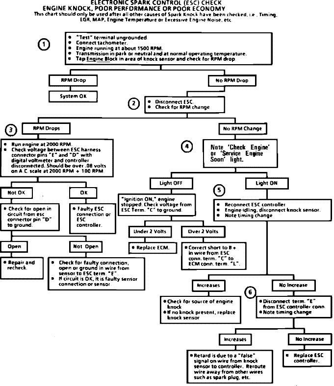

It is not just one sensor. It is a combination of sensors. The knock sensor tells the PCM when/if to retard the timing based on whether it senses pre-ignition. The throttle position sensor and MAP sensor tell the ECU what the engine demand and load are for proper timing. The coolant temp sensor also plays into this as the ECU changes fuel demands and timing based upon the coolant temperature.
Timing should be set by first disconnecting the EST connection at the distributor and running the engine up to operating temperature. With the engine at ~600RPM, set the timing to 8 degrees BTDC #1 using an inductive timing light.
Which piece did you replace? The module under the rotor inside the distributor, or the ESC module located to the passenger side of your brake pedal mounting bracket under the dash?
Attached Thumbnails Engine Troubles Computer/Smog-86_esc_diag.gif
