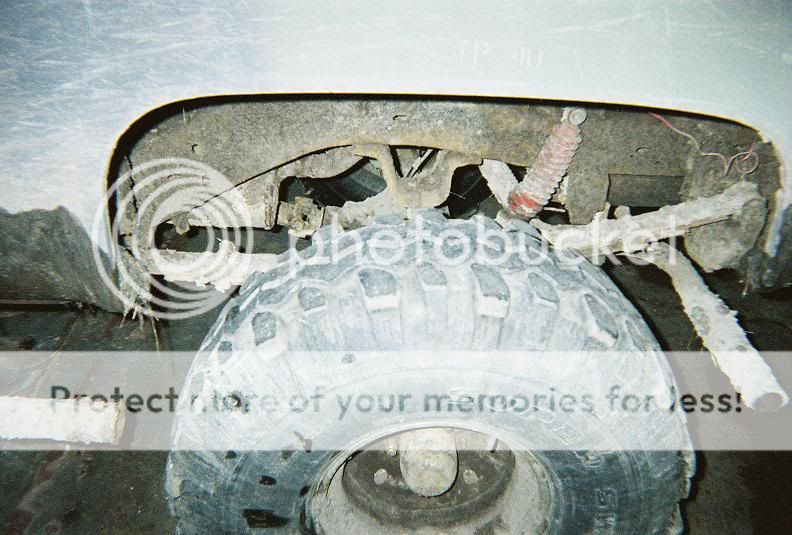

seen every which way. usually on k5s they exit out the sides cause if you have that back window open fumes will get in. also from years of offroading you never want your exhaust sticking out the back, thatll be the first thing that breaks or bends.

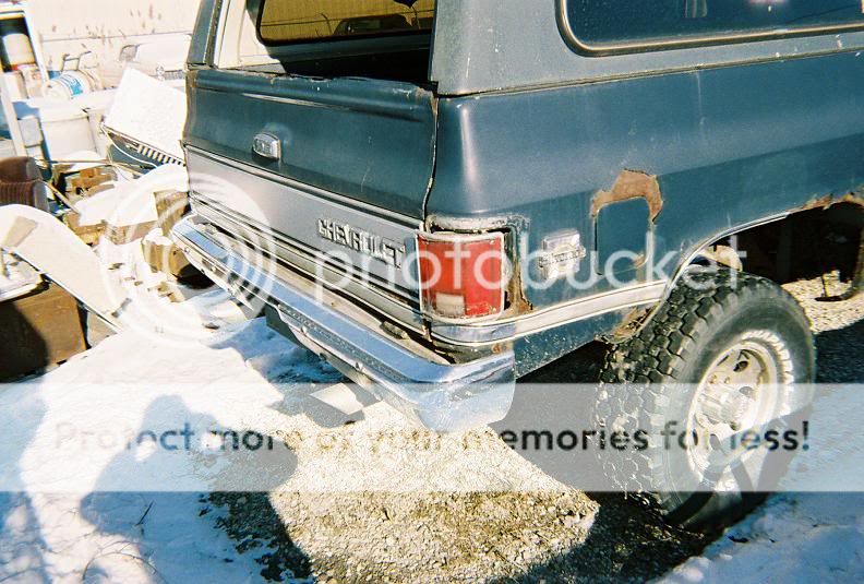

heres a pic of it exiting behind the rear tire on a k5
and heres one coming straight out the back
sorry for the crappy pictures. most the ones i have are from the front or sides

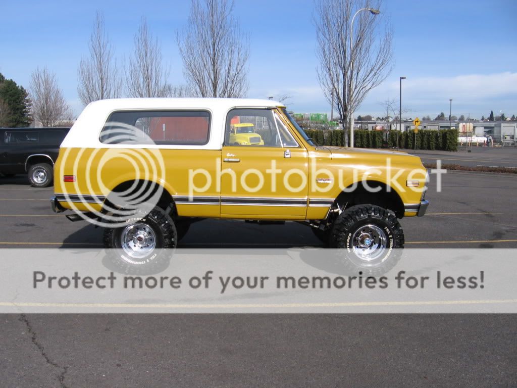

Typically you want them coming out the sides as in the first picture. However I've seen them angled at a 45* like you mention and they looked pretty good. I don't think they had issues with fumes, of course he didn't drive with his rear hatch open much...

yeah id recommend out the sides, simply to keep fumes out of that back window. that blue truck i posted above was actually a parts truck i bought, i got it running and took it to my bosses farm and just beat the heck out of it and noticed fumes coming in through the back window cause it was busted out, had to leave the windows down all the time
