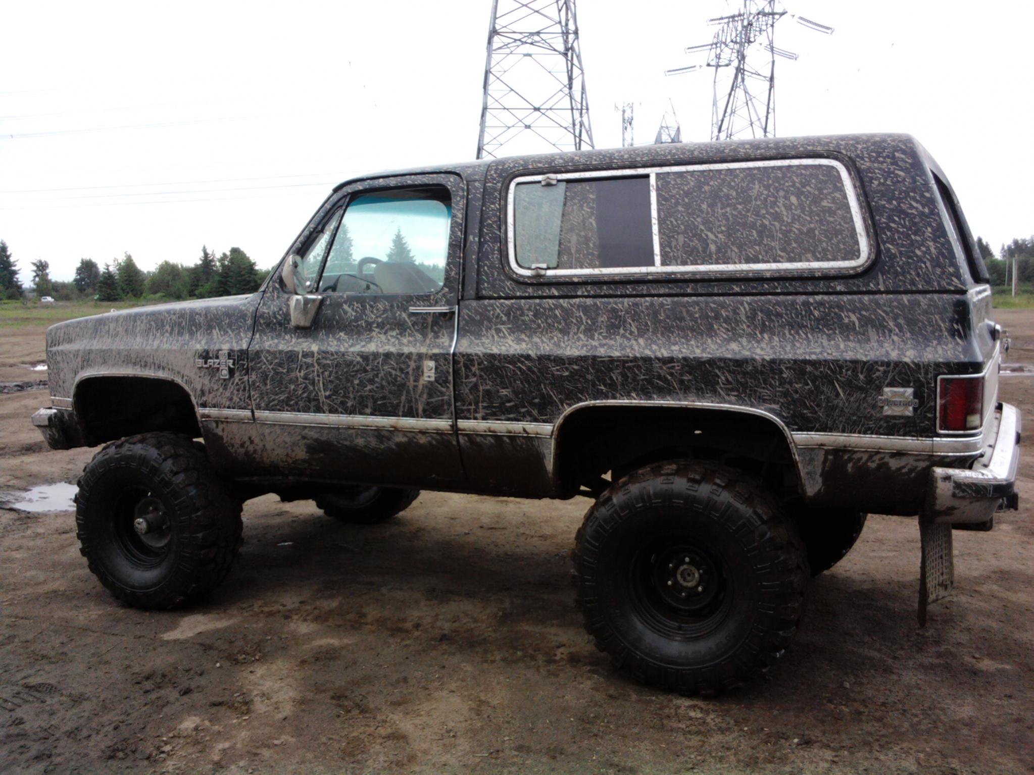

ok here it is 87 350 auto she runs good untill wormed up then she losses power on take off after a few she pickes up and goes with out aney help she sat for a year so i replaced ecm,tps,o2,knock,coolent temp sencer,all new dis. in and out,plugs,wires,new ful pump,intake gasket,esc,iac,rebuld on tbi,oil pump,rod berings, when i droped the tank cleand out put back she seemed to run wors after that. I am soooooo lost. and there is no codes. im abought ready to replace the prom and map sense thats all thats left. im going to rebuld the moter so i dont mined having all new on the out as well. but I do need this runabilty fixed.
