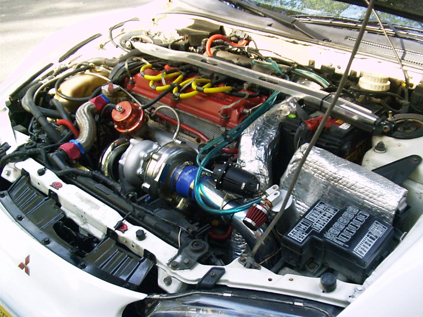

Well I just went out and used the prime connector to test the pump and nothing happened.Then just for the hell of it I put some jumper cables from my cars battery to the fuel pump connector and I cant even get my fuel pump to turn on.So I guess Im gonna drop the tank and see what happened.Would a bad FP keep the CEL light from commin on?This **** is gettin crazy!!!
[]if I get the pump working correctly,and the truck still dont start,I guess I'm gonna try gettin a new computer.And I thought my car was a crazy project I finaly got that runnin perfect
