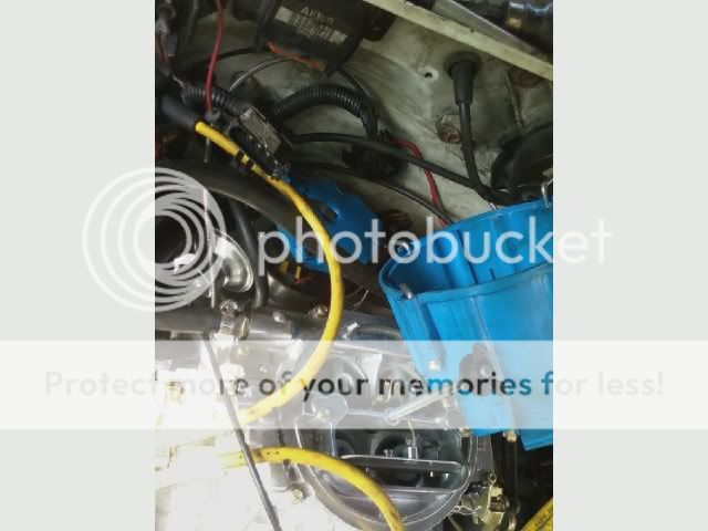

All fixed now. Had to re-clock the whole setup -- just wasn't going to work in that position. Ended up realizing that if I had removed the vac. advance, the stator assembly would be free to wander around at random, probably within a 50° range with the advance weights! NOT good. So I left it in place & re-clocked the whole assembly.
Now the vac advance is facing the passenger side, & the control wires are facing the carb. Jumped it 3 positions on the cap, so all wires had to be swapped around again, & my magic-marker numbers wiped clean with acetone & re-written. Had to pull it all the way out to turn the oil pump drive to it's new position. At least finding TDCC was easy this time - just watch the rotor. The first time I forgot to check the pushrods when I installed the intake manifold to see whether or not I was going to be on the compression stroke, or overlap stroke. I ended up yanking the #1 plug & installing my leakdown tester, then rotating the engine around. Good thing I did, because that time I was on overlap. But back to now --put it all back together & she runs better than ever! Even better than when it was FI in the Jimmy!
Almost forgot - I found out my eBay dist. setup is a Pro-comp ... probably a 6001-6.
Turns out my static timing was about 20° advanced .. and I couldn't retard it one degree due to the vac. advance hitting the cable mount for the carb. Now I have plenty of adjustability both ways. Might even play around with the vacuum advance at different settings as well. Plus I have ported & direct vacuum fittings on the carb. So many different combos to run, and so little time.
Feels like a new truck now. It's so quiet & smooth. With the new torsion bar mounts, there's no more horrific bar-on-frame, metal-on-metal BANG over big bumps. My driveway has a dip in it that will put any suspension to the test at speed ... and I came into it 30 mph, & she just soaked it all up, quiet as a mouse. VERY HAPPY!
Now I have to start all my other projects that have been on hold for the past 2 weeks. Got to rebuild a front diff in a '05 Polaris Sportsman 500, & replace a valve, rocker arm & adjuster screw in a Honda powered Cub Cadet mower. Busy busy busy!
Here's a vid I shot today after the timing repair, & a pic of the new position before I had it back together:

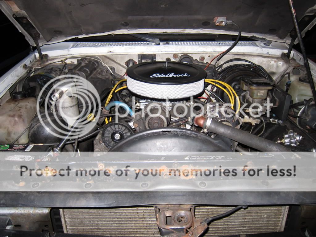

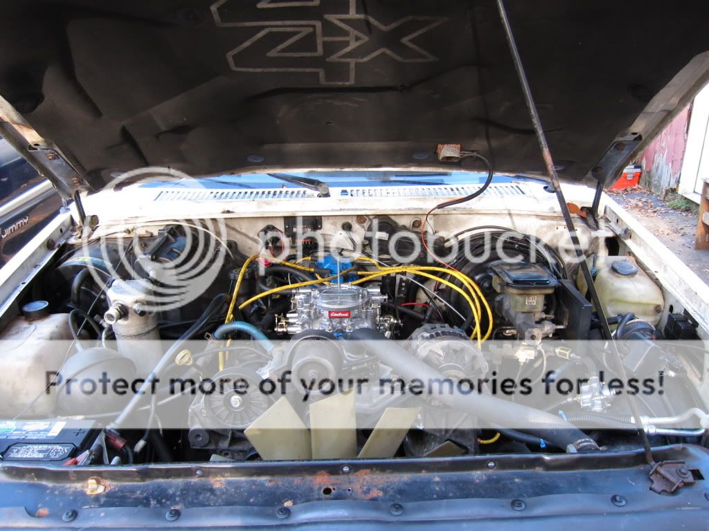

Drove it about 75 miles today round trip. Filled her up, & went shopping for more plumbing supplies to fix an issue that popped up (gotta expect a few of those).
3 issues - the first was that there was insufficient clearance between the upper radiator hose & the alt fan. I don't know how this hose didn't burst - must've been just a mm of material left! Under power, the engine torques toward the passenger side, opposite the direction of rotation of course. When that happened, the clearance went NEGATIVE, & put a nice slice in the hose. So I found a 1.25" 45° copper elbow at the store, & clamped that in place. Not pretty, but issue solved.
Next up was the upper fan shroud. Using the Jimmy fan, the original shroud was too small, & the Jimmy shroud has long since been sold off. So had to do lots of painstaking cutting, trimming, & melting down shavings to repair sections that got too thin. It's better now, but has become so thin that it has no support, & is just lightly contacting the fan under power. I'll shim the shroud up with washers tomorrow. No biggie there.
The final issue was the original TBI air cleaner. Just wasn't going to work no matter how hard I tried. The hood was putting so much pressure on it (zero clearance) that when the engine torqued under load, it would force the air cleaner off the plastic spacer. Had to use the open Edelbrock 14" x 3" filter that came free with the carb. Was going to sell it on eBay, but turns out I need it now. With that setup, I had to use the tallest spacer I had - went from 1" to 1-1/2". But with either setup, the threaded rod that came with the carb was too short - so I extended it by cutting the head off a bolt & welding it. Now everything fits perfectly .... and as an added bonus the hood now opens nice & easy without all that tension on it.
Pretty much all done now. All I have left is pitman & idler arms. I used the 3 year old TRW idler out of the Jimmy last year when I first bought the Blazer. Only had 40k miles on it .... and it's TOTALLY smoked. About 2" of play in it. And I use expensive Amsoil synthetics in all my vehicles. What a junk part that was! Will replace everything with Moog, like I did when I replaced the ball joints & tie-rod ends. Should last a bit longer than 3 years now ... I hope ....
I did end up hooking up the vacuum advance. Runs pretty damn good now! Passed a few cars today. Made it up to 75 MUCH faster than it ever did before. With the old engine, I would never make an attempt to pass anyone. It used to buck & shoot black & blue smoke out so thick it looked as if the street was on fire!
So it starts right up, runs beautifully, is smooth as glass (gotta love that counterbalancer - really makes a difference!), and is now simple to fix with just a flat head screwdriver. VERY happy with the outcome. Just needs a good wash.
