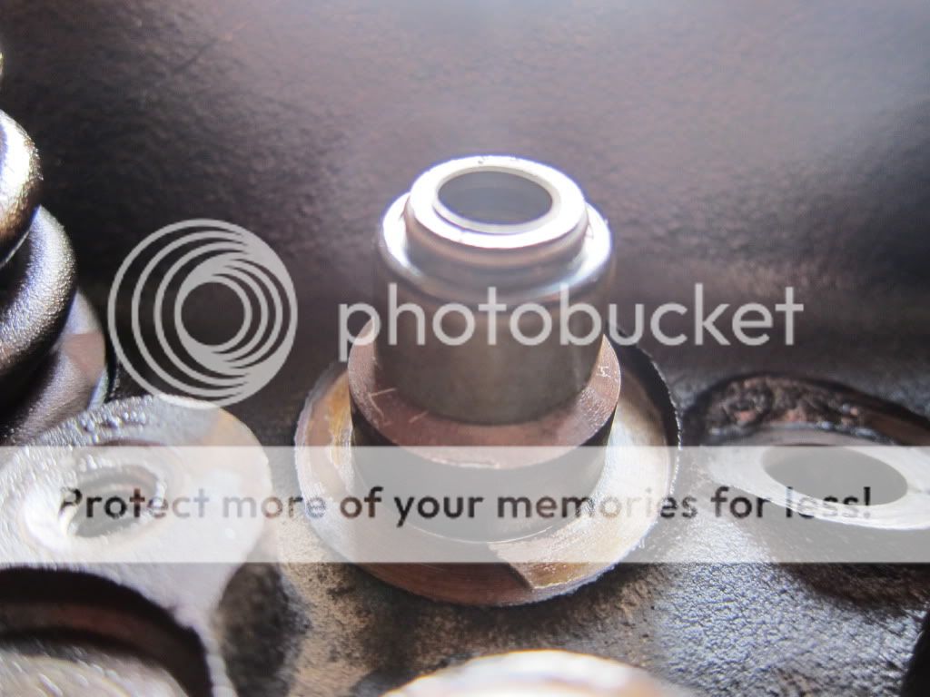

Whelp, she's all back together now, aside from some minor interior repairs I need to do today. Yesterday I got the exhaust all bolted back up with new donut gaskets at the Y, bolted up the crossmember, replaced a Moog upper ball joint on the passenger side that failed after 2 years and 12k miles, and then buttoned up all the loose wiring & topped off the fluids.
Went for a little drive last night, and I'll have to back off the timing a bit - was pinging like hell. I'm thinking the new head gaskets bumped the compression up a tad, as the distributor was installed precisely the way it was removed.
So anyway, she's got new head gaskets, rear main seal, front crank seal, valve seals, timing cover gasket (and yes, you can re-use the cover no matter what it says), oil pan gasket, valve cover gaskets, Comp Cams timing set, and a Melling stock volume oil pump.
I had originally purchased the H/V pump, but I had a clearance issue ... so after re-thinking the whole thing I decided to just go back to the stock volume. Plenty of pressure anyway and less drag on the engine. That gigantic Comp timing set is enough drag! Look at the pic below - that's the stock timing gear on top of the Comp set for comparison. It's 3x thicker!
Good thing I changed it though. Was a ticking time bomb. I think the spec for chain freeplay was a half inch or so, max. Well .... I had 1 SOLID INCH of slop! Not good. Wouldn't have got many more miles out of this thing, especially with cold starts and a carburetor - was due to jump time any second.
Anyway, here's some pics of the process. Enjoy!
