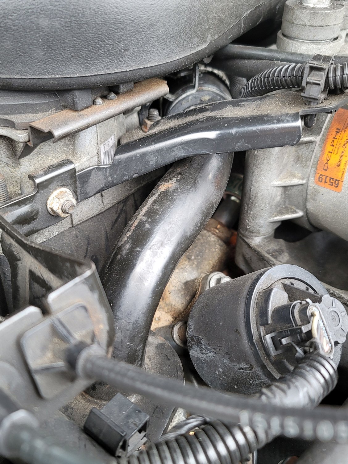

It is either pooling or leaking here. Not sure what this hose is but its in the front of the engine and there is a visible trail to the back of the engine...does this engine tilt forqards or backwards? Im hoping backwards, because that would hopefully mean this fitting is leaking.

That large metal tube going off to the right is your thermostat housing (on the intake manifold end) and goes to your upper radiator hose. There's a rubber gasket on the thermostat that seals it, and it's not uncommon to have a leak there. I would drain the coolant, flush if necessary, then replace the thermostat with a new gasket. Also check the housing for rust or corrosion that would prevent a proper seal.
And the engine is supposed to tilt toward the back slightly, so leaks at the front could easily run off the back.

Gotcha and its actually pooling up right under neath the fitting screwed in to the manifold, i think its the uppper, on my picture. One of the pictures you can see numbers on the hose. Thats where the pool is, like directly underneath it in a little gully in the casting.

more pics, you can see the floresant dexcool.
Old Apr 2, 2021 | 12:07 PM
That hose with the numbers looks like EGR, not a coolant hose. It shouldn't be leaking from there, but it could still puddle there.
