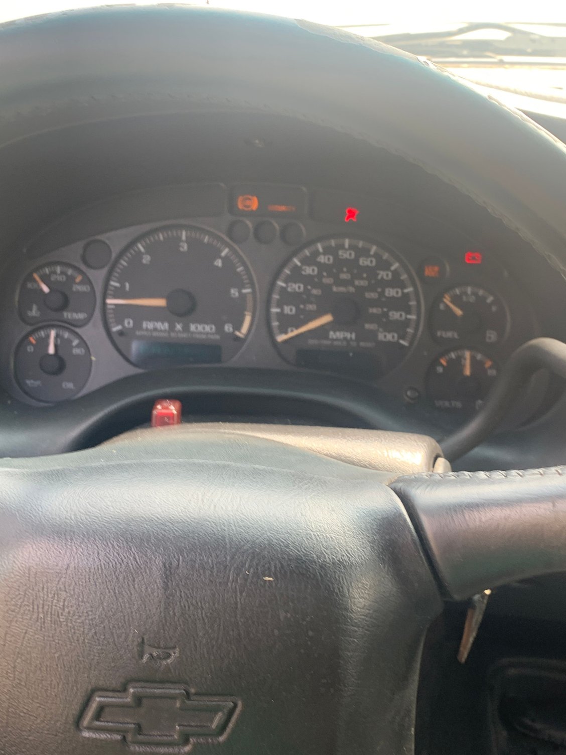

I need some help my 2002 Chevy blazer gauges wont work right and my dome lights wont shut off. My truck wont start it acts like it wants to start but dies right down after, I got it to start a while back then I bought a new computer and did the key relearn thinking that’s what it was and it started for a while but the temperature gauge and the gas gauge are still not working. I went to get the alternator tested it it’s still good Then just today i went to go start it and it won’t start and those two gauges are not turning on at all every other gauge in the truck works except those two

The dome lights stuck on and the gas gauge and temperature gauge won’t work I think it might be a bad ground wire

I replaced the ecm and I just got under it and started looking for ground wires that were fried or bad and I moved a lot of them around and now it’s starting but I my gauges are still not working right so I think a ground wire is bad and my dome light is even brighter cuz the back one shut off so I pulled the fuse that way it’s not one anymore but it’s still going to pull power
