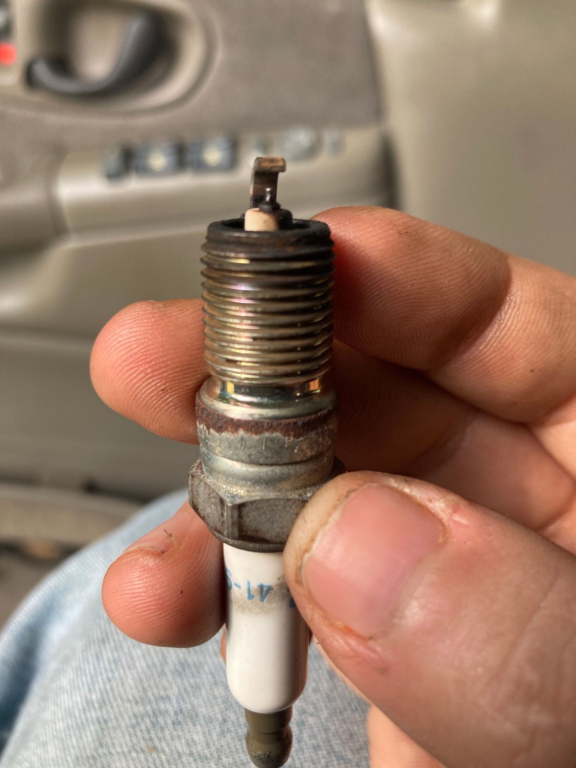

Ok so I changed the map sensor and only code I have now is cylinder 2 misfire. I pulled the spark plug and this is what I see. It’s burnt looking on top and rusty in the middle as you can see. What could that mean?

One cylinder having a light misfire problem (no flashing CEL) is unlikely to cause a vehicle to not be able to accelerate. Since you are looking at misfire counters you need to be sure that CMP retard is within spec. You can also look under the old distr cap for carbon tracing indicating a distr timing problem.

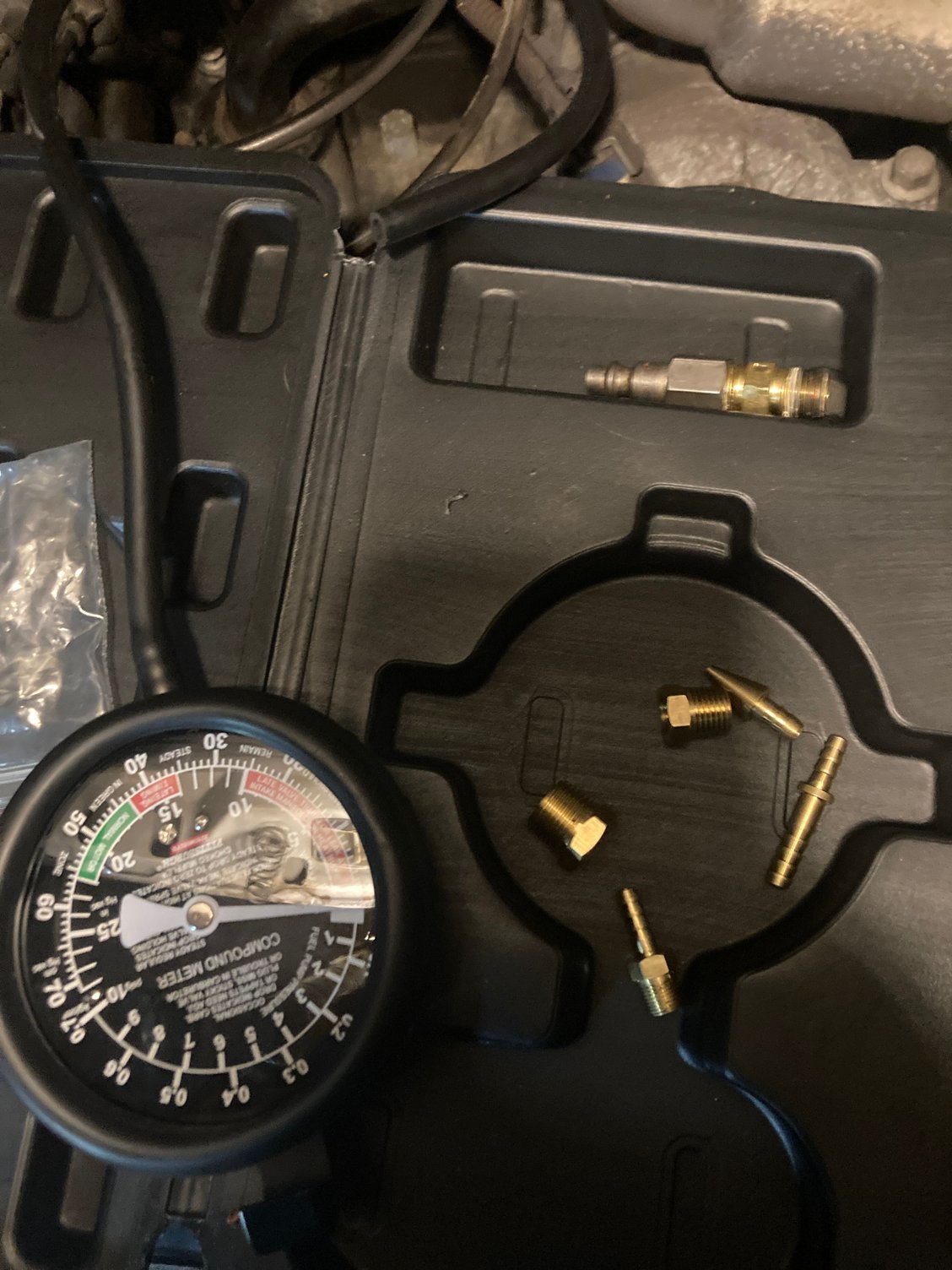

Ok I just tried to test fuel pressure and it stayed at 0. I assume I have this setup wrong? I put one bolt on it then stuffed the hose into the end of it
Old Aug 21, 2022 | 07:08 PM
GeorgeLG's Avatar
Posts: 4,642
From: Florida

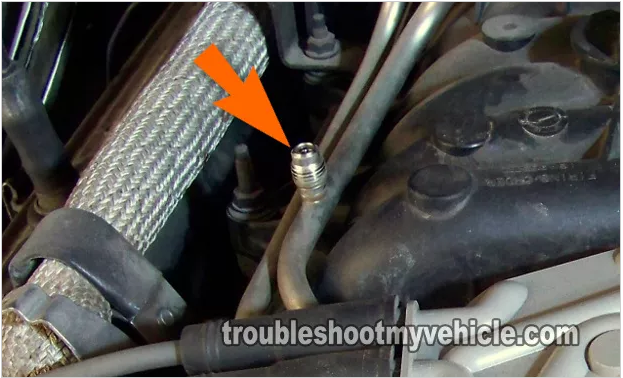

You want to attach the threaded portion of a fuel pressure tester like this:
To the fuel line schrader port that looks like this:
at the back of the intake plenum near the distr like so:
Everything must be threaded, tight and leak free.
George

these are all the attachments I have. I can’t find a threaded one that will fit. Bad kit maybe?

I’ll buy another fuel pressure tester tomorrow, but I went ahead and checked my vaccum. I ran it from the T on the right side to the back of the intake. It stayed right there
