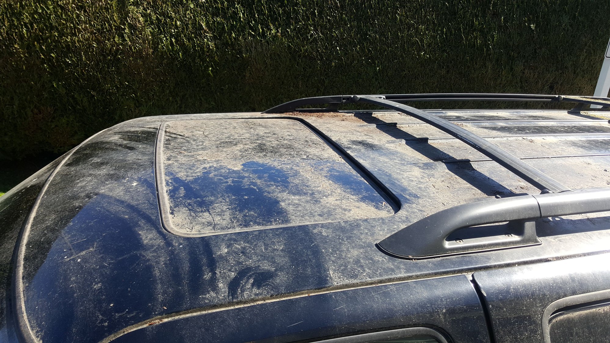

Few blocks from my house there was four door Jimmy / Blazer that has been parked for years.
It was parked under Cedar tree buried under 18 inches of rotting ceder bows and leaves, completely green with algae and 3 flat tires!
After sweeping roof off

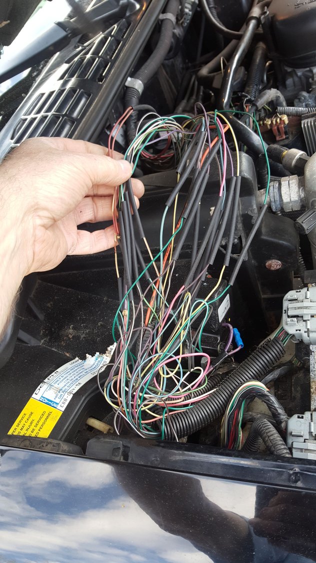

Found the problem, mice had chewed through both cables leading to ECM, heater blower, engine harness between MAP sensor and coil.
On next days off head to pick a part and get harness's. Lucky they were just about to cut harness pull engine. Paid 50 bucks and took almost entire engine bay wiring harness.
Basically mice had chewed through right side engine bay wiring. There are lots of wires going to ECM. Took a whole day to test splice donor harness and double check it.

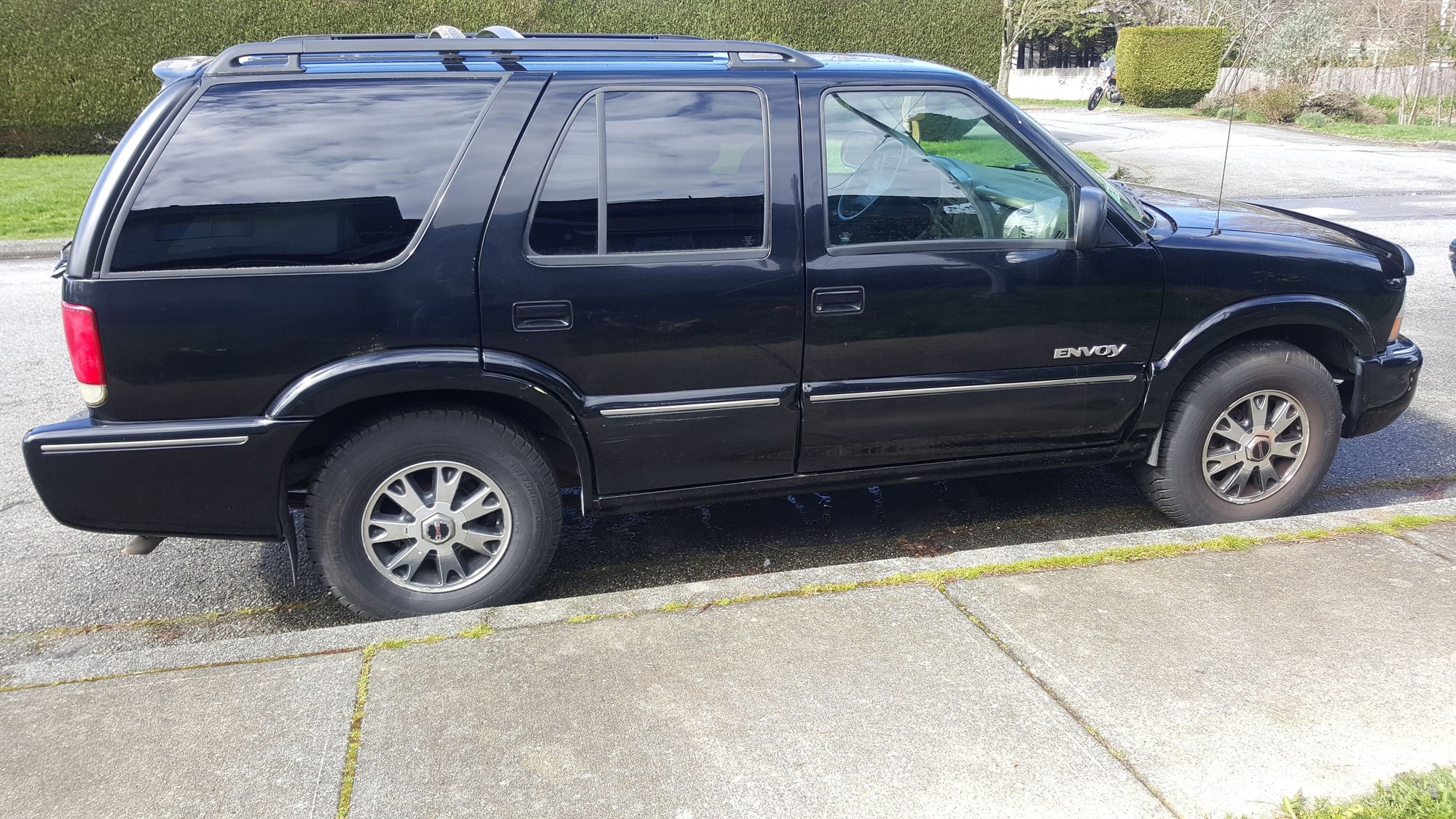

Shot of either and She fired up immediately. All the gauges dash idiot lights work. Aired up tires, they looked new, sidewalls appeared not damaged. Drove it up and down the back lane. Went to ICBC to transfer ownership and put insurance on it, done, it was my Envoy.
Drove her home and put the pressure washer on it and vacuumed interior.

After rescuing her she needed new radiator and battery. Other than that she was good to go. Check engine lamp has remained off except for transmission slipping. She passed emission tests.
Put rebuilt transmission in last year at 280,000 km. $3600 dollars later I have good reliable vehicle. Know transmission is worth 3 times what its worth, but would not be able to replace her for $3600 bucks.
Recent picture
Recent picutre
She cleaned up well

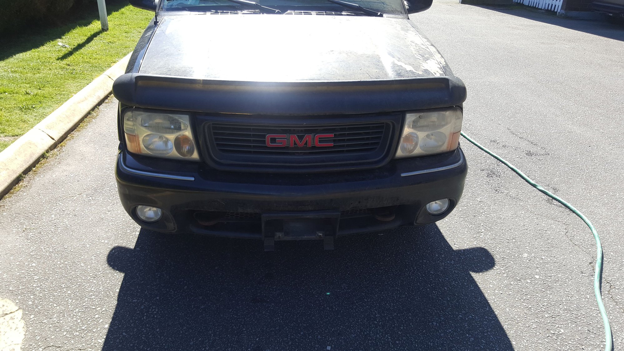

The HID bulb is unique to Envoy and Diamond Edition. No other GM used this HID setup.
GM was developing HID's, before there were industry standards for there construction.
Engineers used same focal measurements same as 9006 halogen bulb.
Bulb looks like a D1 / D2, but it is not! Placing D1 or D2 bulb in housing results in terrible focus.
OEM factory Ballast, igniter and bulb is one assembly, hard wired together with bulb cemented into igniter.
Replacement is only available as kit containing conventional ballast and special bulb with correct focal length, only available from GM. $750 bucks each. There are still 3 or 4 assembly's available Canada, when I checked couple years ago.
When HID fails many swap out the HID's for halogen composite lenses from standard Blazer / Jimmy.
I had one HID fail. It turns out that cheap HID 9006 conversion bulbs are EXACTLY the same focal length as factory HID bulb.
Factory HID igniter / bulb was screwed onto lens housing with torx security head screws.
to make 9006 HID bulbs fit requires cannibalization of factory igniter mounting ring to hold bulb in.
Presto you have working correct focal length HID's that pass inspection. In Canada to pass requires vehicle to be OEM with HID and bulbs must be color temperature of 4300K, same as current OEM bulbs. The various blue colored 5000K, 6000K and 8000K degree bulbs are not legal. Have read that human eye is optimized for 4300 degrees K, The higher you go up the color temperature scale there is less visible light!
Factory HID design replicates halogen North American light dispersal with 10% of the light directed up and to right to light overhead highway signs. So they do not have the sharp cut off that modern European lights do.
Factory HID's are very a well engineered and don't bother oncoming drivers. They light entire road in front uniformly, very well indeed! Hardly use the halogen high beams as they do not add much more distance or brightness (HID's remain on when hi-beams on). Done lots of night driving between Vancouver and Prince George. HID's are very effective with Elk and Moose, as there almost invisible with halogens until your right on top of them. HID light reflects from there fur, compared to halogens where most of the light is absorbed.
