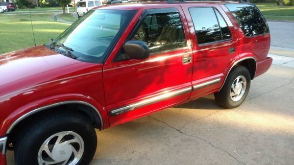

Hi all gonna try and keep this first post short...
New to the forum and recently bought a 2001 blazer 4x4.
A few years back I had another 2001 and I really enjoyed the vehicle although it had it's issues. I ended up selling it pretty cheaply because I didnt want to pay to fix it. (Ended up getting a fairly new used rogue).
The new blazer I got is in really good shape interior and looks like it has been kept up pretty well mechanically as well. The engine light was on and the guy gave me some spiel about oh it's a low fuel pressure code and probably needs a fuelpump soon. I took it with a grain of salt because what the hay, it looks good and runs pretty good maybe a little shimmy in the front and a little rough idle.
Well upon pulling codes I'm afraid that I might be going the whole nine blazer yards with spider, fuel pump, ebcm, vacuum leaks, wheel bewrings, 4x4 dash switch, etc...
Did I make a mistake? Pay out the nose to have it fixed? Save money and try and diagnose and fix myself? Sell it ?(for probably a loss)?

Clean looking Blazer.
When I did my LIM gaskets, I upgraded to the multi-port FI system
