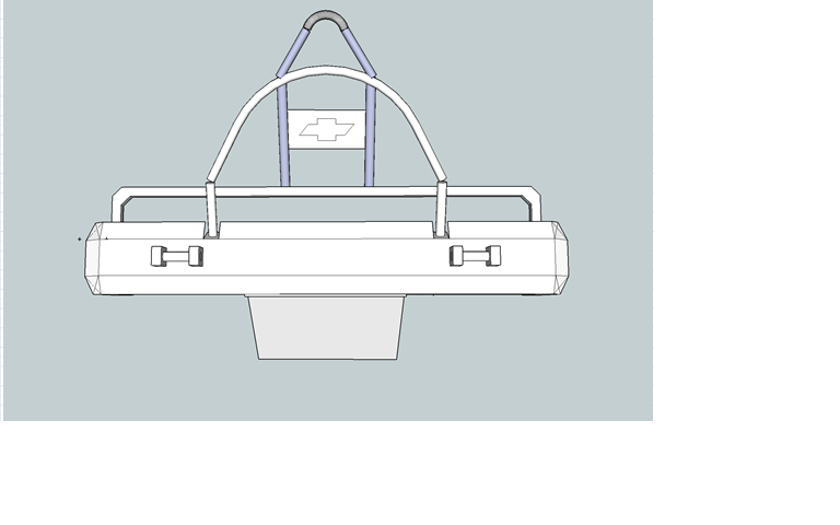

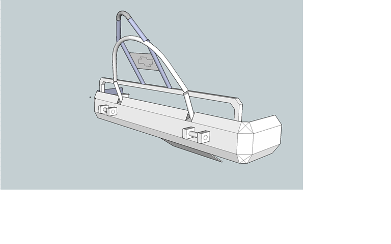

Been doing some quick rendering on a new bumper that I plan on building soon. My front end was tore up in an accident I got in a few months ago. I don't see a point in putting OEM parts, when I planned on creating something that better suited me. I'm either going to seal the bumper up and make it a reserve air tank/water tank, or put storage doors on it for tow ropes, emergency kits, and tools.
Looking for suggestions, all critics are welcome!

mine is kinda like that. i bought it used off someone. it too is a storage tank for air which ive had this truck for like 5 years and never used it once also if this truck is going to be a daily driver i wouldnt go crazy with that stinger being to high, its gonna get annoying with that thing blocking your view all the time.

Yeah, it'll be on a daily driver. It's definitely not to scale. That Stinger is almost 25" above the top of the bumper. Still getting use to the program.
The stinger is there, as an idea, not completely sure if I'll want it in the end. It'll most likely be built with square tubing also. I am unable to find a shop that'll bend the steel without charging a load of money.
