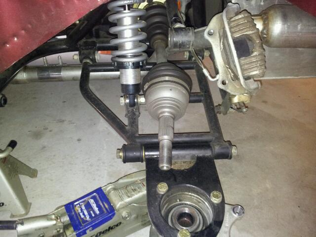

Hey guys, new here. Trying to help a friend identify his stub axle. It's supposed to be based off a 95 S10 front. Can you guys identify this? Also does it look dimensionally correct if so?

Looks similar but hard to say without dimensions. What is the application? A custom car of some sort?

Yes it is, it's being used for a IRS conversion. He wears out bearings in 500 miles. It was machined by The Driveshaft Shop years ago. He's a new owner of the car. The splined section is supposed to be 95 S10 and the CV side mates to Nissan pattern. Nissan IRS in a MGB powered by a Ford 302.
There's a miss fit.
You can see a shiny wear area at the front #1 point the diameter looks short from what I've seen for an S10. In the lower pic, you can see a gap, the stub axle is not seating.

A second question, what is the proper torque specs of a hub bearing for a 1995? I see conflicting number? Did they, GM mess up saying 180 lbs?
