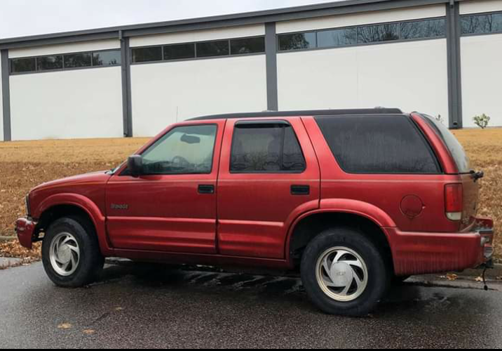

Got a 2000 Bravada. Has an injector issue, so I'm planning on doing the MFI spider upgrade. Also gonna replace the cap and rotor (ac Delco only, of course) as well as the thermostat while I'm in there. Any other known issues with this year?
The biggest trouble is that I'm having to do an abandoned vehicle title, which sucks since all of the DMV centers in Virginia are closed right now.

Very nice. The body looks straight and the paint looks good. While doing the cap and rotor , take a close look at the CamPositionsensor which hides under the rotor. Look for cracks and any corrosion. It can cause mysterious problems.
