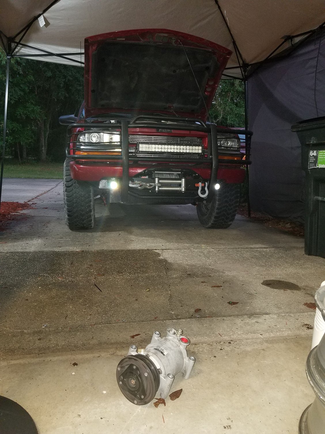

The only difference you may find is the placement of the high pressure switch on the back of the compressor, at least going by photos on Rock Auto. My 04 has the switch on the back of the compressor, the photos online show it capped off. But all that holds in either the cap or the pressure switch is a C-clip, so it's a quick and simple swap to accommodate either.
I think it's capped off in the pictures just because the new compressor doesn't include the switch. I bought a new AC-Delco compressor for my 2000 and that port was plugged. I had to transfer my switch over.
That is true. The first compressor I put on my Blazer when I bought it was a brand new unit, and I honestly don't remember if it had the switch in it already or not...
The most recent one I installed was a like-new replacement unit from a junk yard, so no modification was needed, direct bolt on plug and play, relatively speaking...
