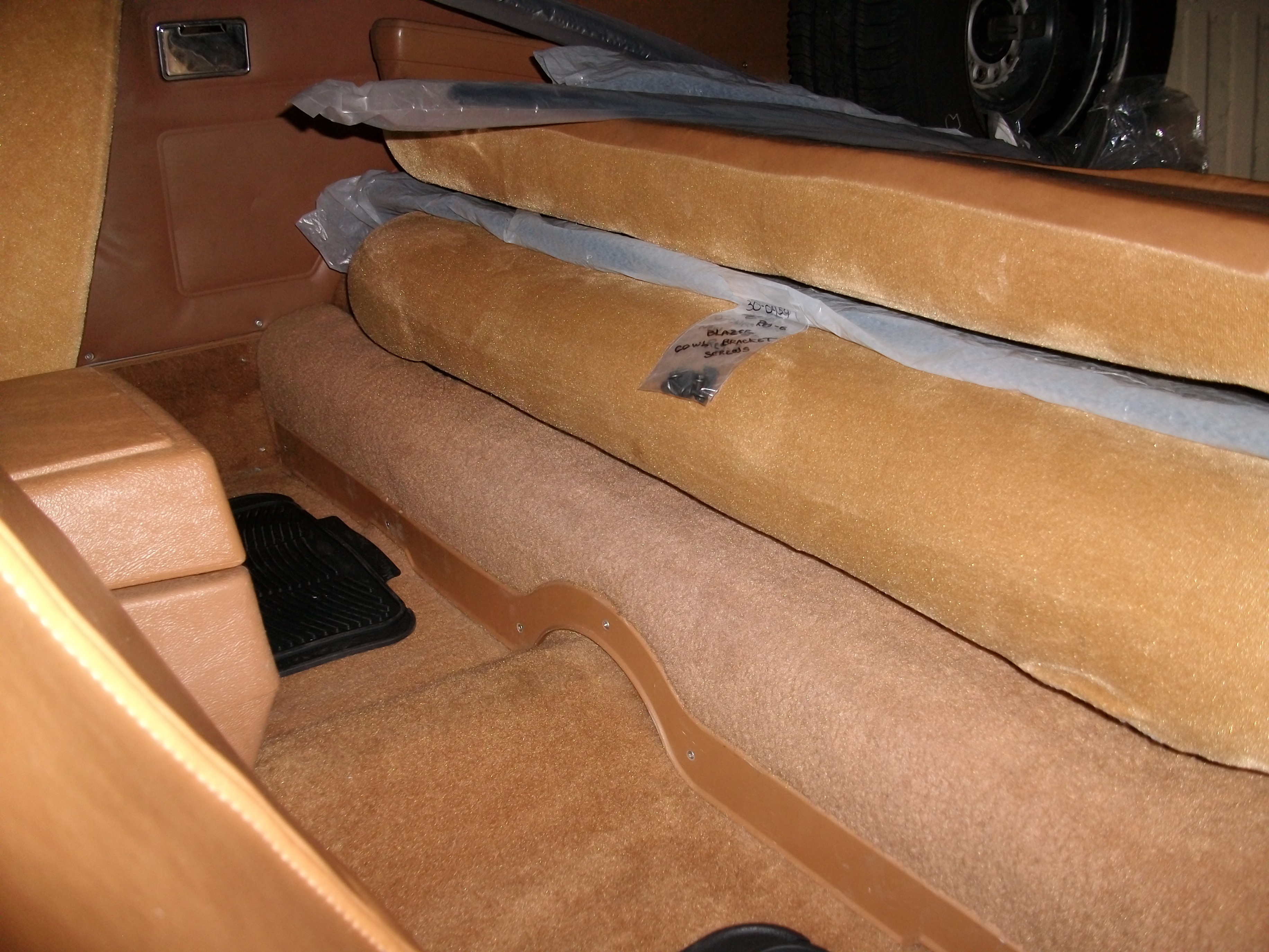

After all the work I've done on my K5 Blazer, The spare tire rack makes so much noise I can't hear the $1800.00 audio system I had installed. I took the spare tire off, ordered from LMC a new set of the bolts that hold the rack to the floor and wheel well and chased the threads with a tap so their clean, I painted the old rack after making sure it wasn't cracked anywhere.
I cut out of a old milk jug new plastic gaskets for the 3 feet of the rack and used Loctite 242 Blue thread-locker on the new bolts threads and put it all back together, waited 24 hours like the instructions said to do and then put the whole thing back together. It's much better, but it's still kinda aggravating. The whole tailgate has been repainted and the interior is in excellent condition looks like new with a shampoo and wash.
Anyone else crossed this bridge ?
Attached Thumbnails Noisey squeeky inside spare tire rack ?-1988-k5-blazer-interior-color-004.jpg   Noisey squeeky inside spare tire rack ?-1988-k5-blazer-interior-color-003.jpg   Noisey squeeky inside spare tire rack ?-1988-k5-blazer-interior-color-005.jpg
