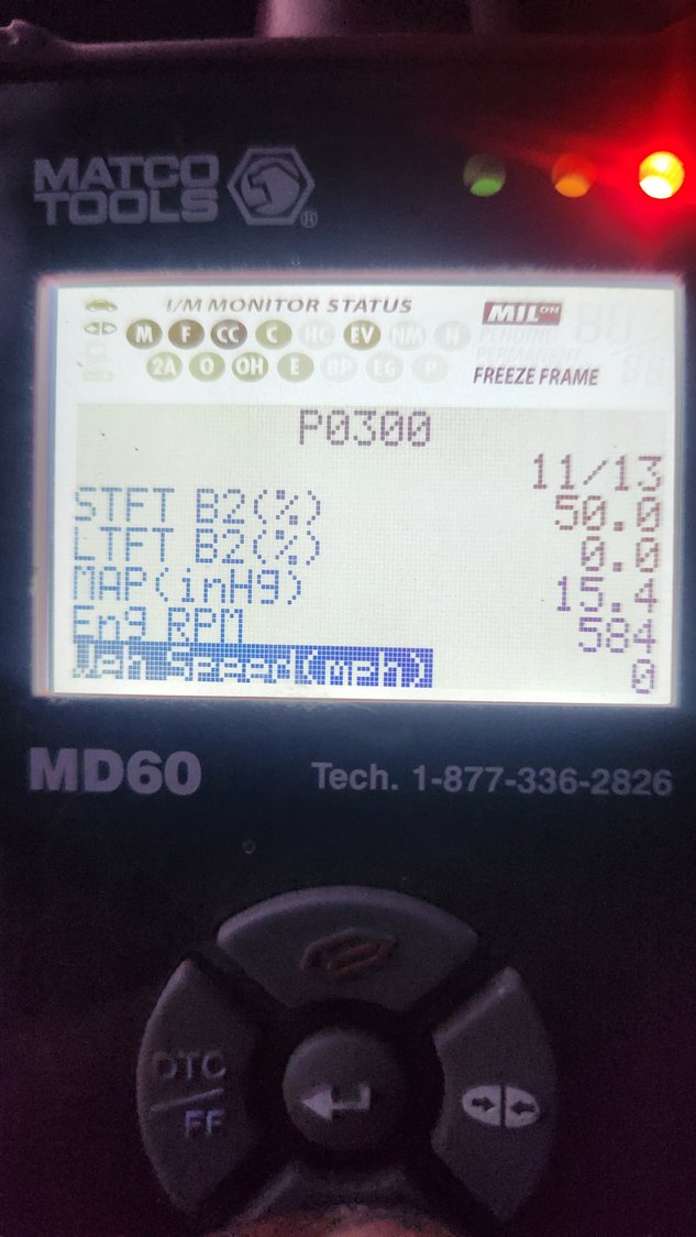

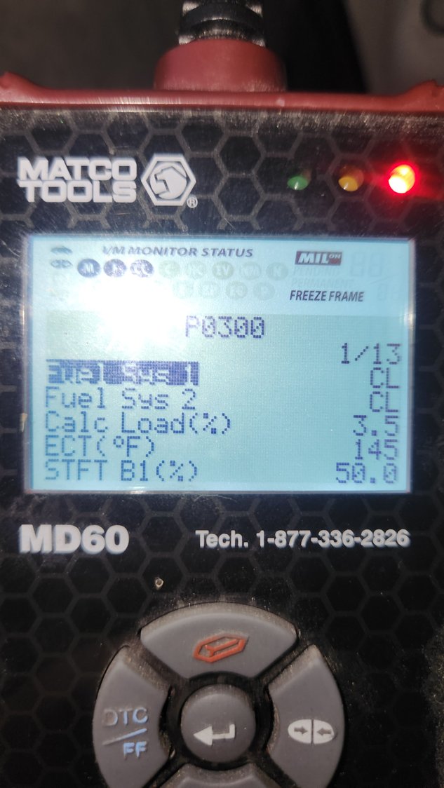

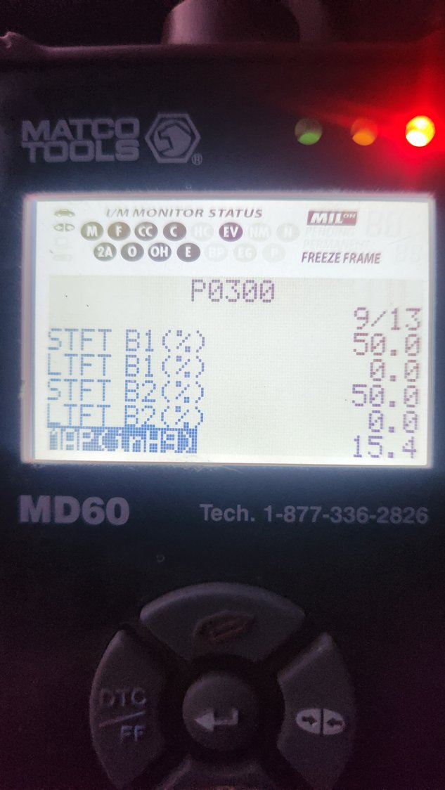

Thanks for replying, when I sprayed the starting fluid it backfired I guess you could say out the throttle body as it it was cranking. I do have some freeze frame data as well. Hopefully it shows up here. Short term fuel trims are definitely outta whack. I am hoping to get a fuel pressure tester this weekend and verify pressure and leak down. Will report back on that.

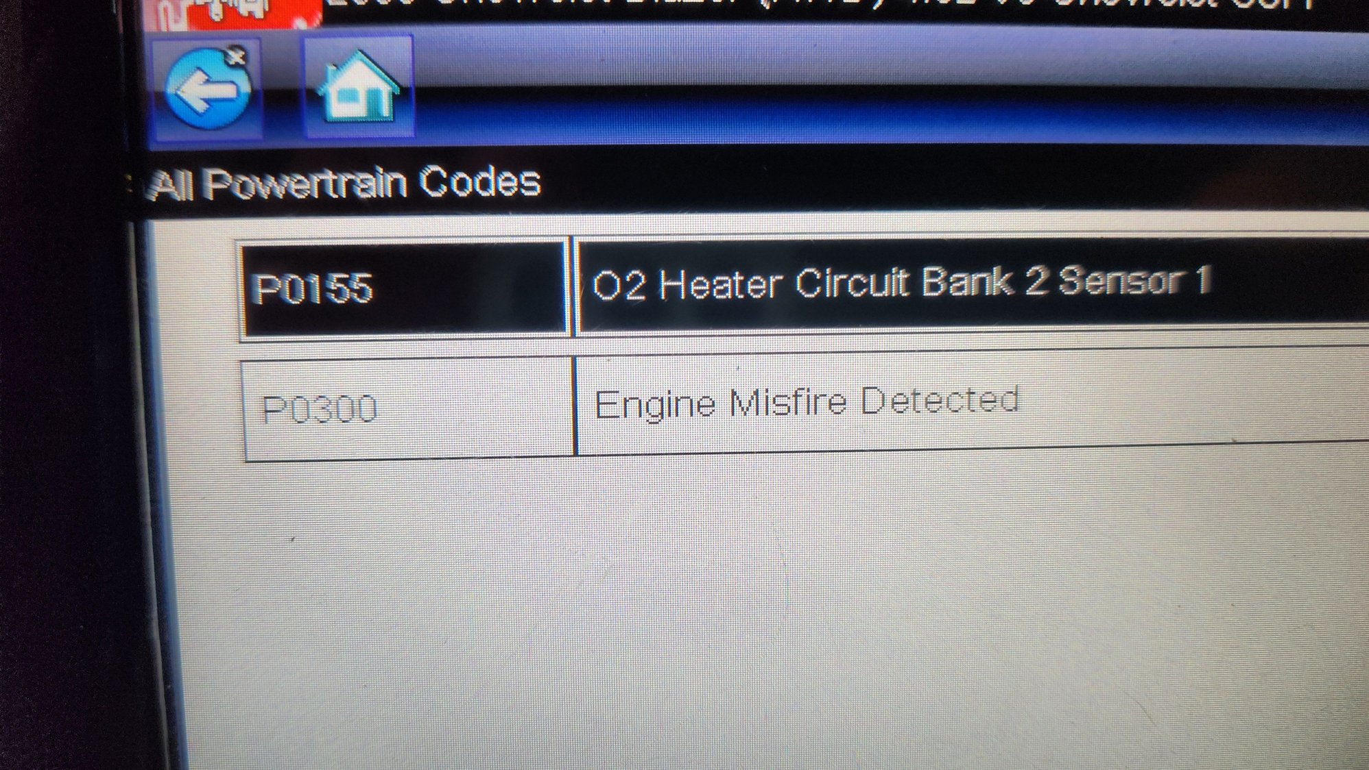

I was able to check fuel pressure today and got a new code as well. Key on while pump primes 62psi. When pump stops priming holds about 60 psi.Turn key back off, 58psi holds for over 10 minutes no noticeable change after 10 minutes. 56 psi while running. I drove it down the road and the check engine light started flashing. It was like driving down a bumpy road felt it in the whole vehicle lol. I got back home and read the code again and got p0155 bank 2 sensor 1 Could an oxygen sensor be causing all this mess? Fuel pressure doesn't seem to be the "issue". The freeze frame shows the misfire problem starting while the fuel system is in closed loop. No freeze frame data for the o2 sensor code.

  6. A bad O2 sensor can cause problems yes but your code is for the heater which means slow warm up and less likely to be the issue. That said can you graph the O2 sensors or at least look in live data to see if the front two are switching between 0.2V and 0.8v and the rear sensor is flat lined between 0.5-0.8v?

Thanks for coming back to the thread and the info. The light came on a few seconds after start up. Freeze frame showed closed loop. It came on while in the garage. Do they start closed loop then switch to open loop or vice versa, I can't remember. I can only see freeze frame with my little scanner. I'm hoping this week and friend will be able to come by with his Solus and we can watch live data. Will the better scanners show which cylinders are missing as opposed to my cheap one? Could there be an issue with the spider injection system that the computers wont pick up?

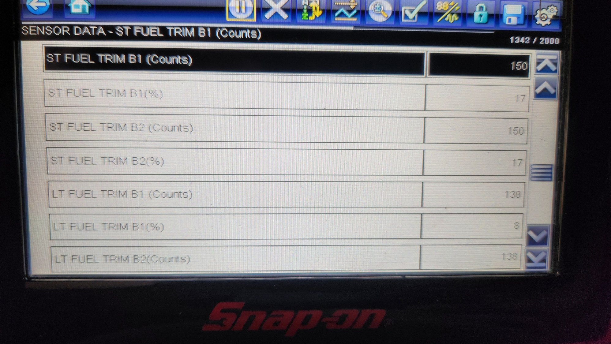

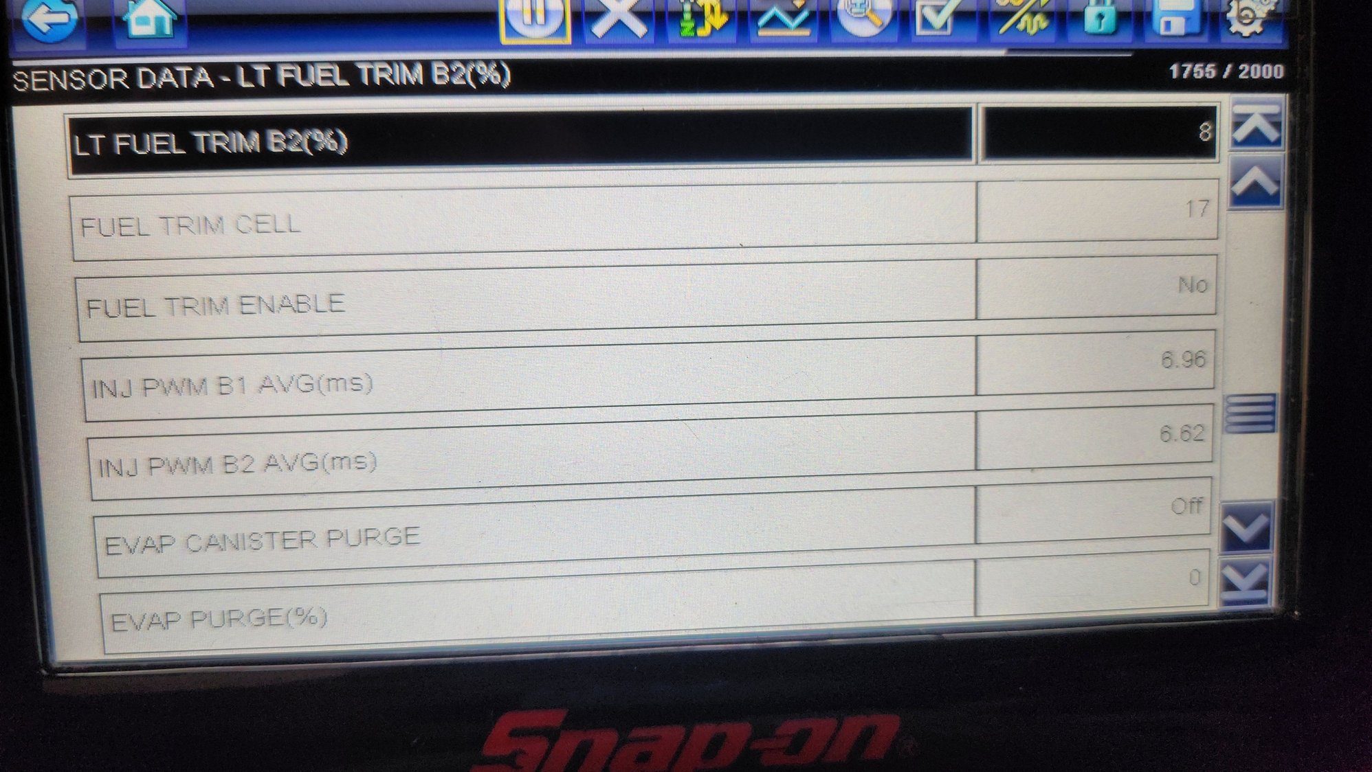

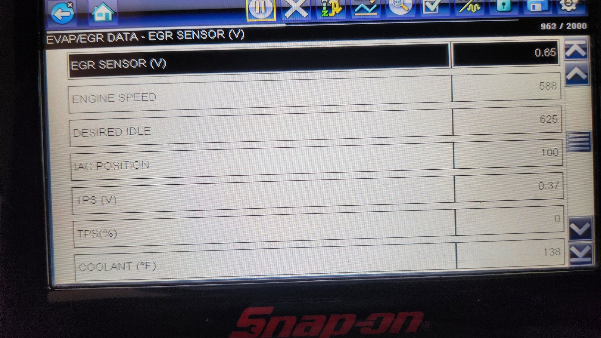

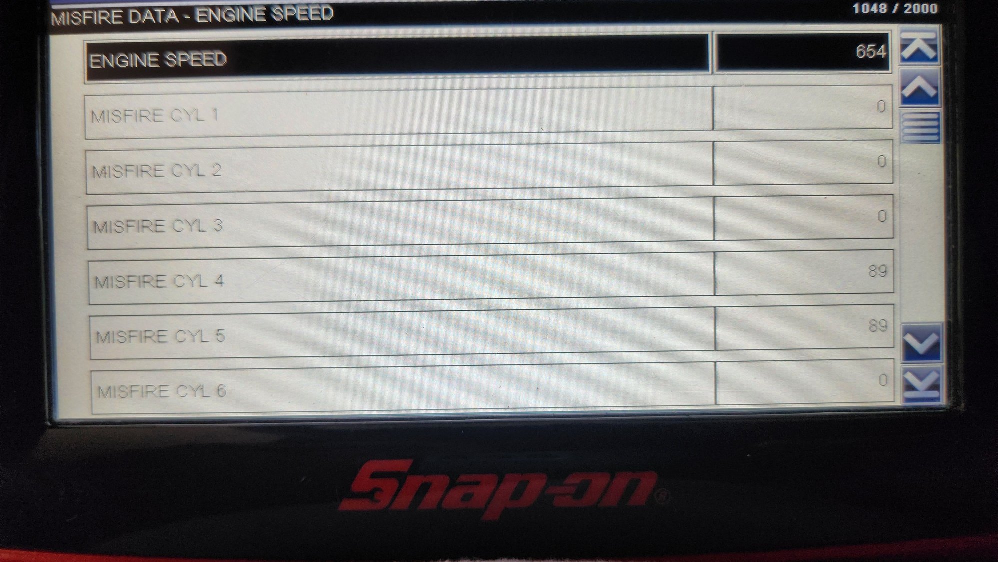

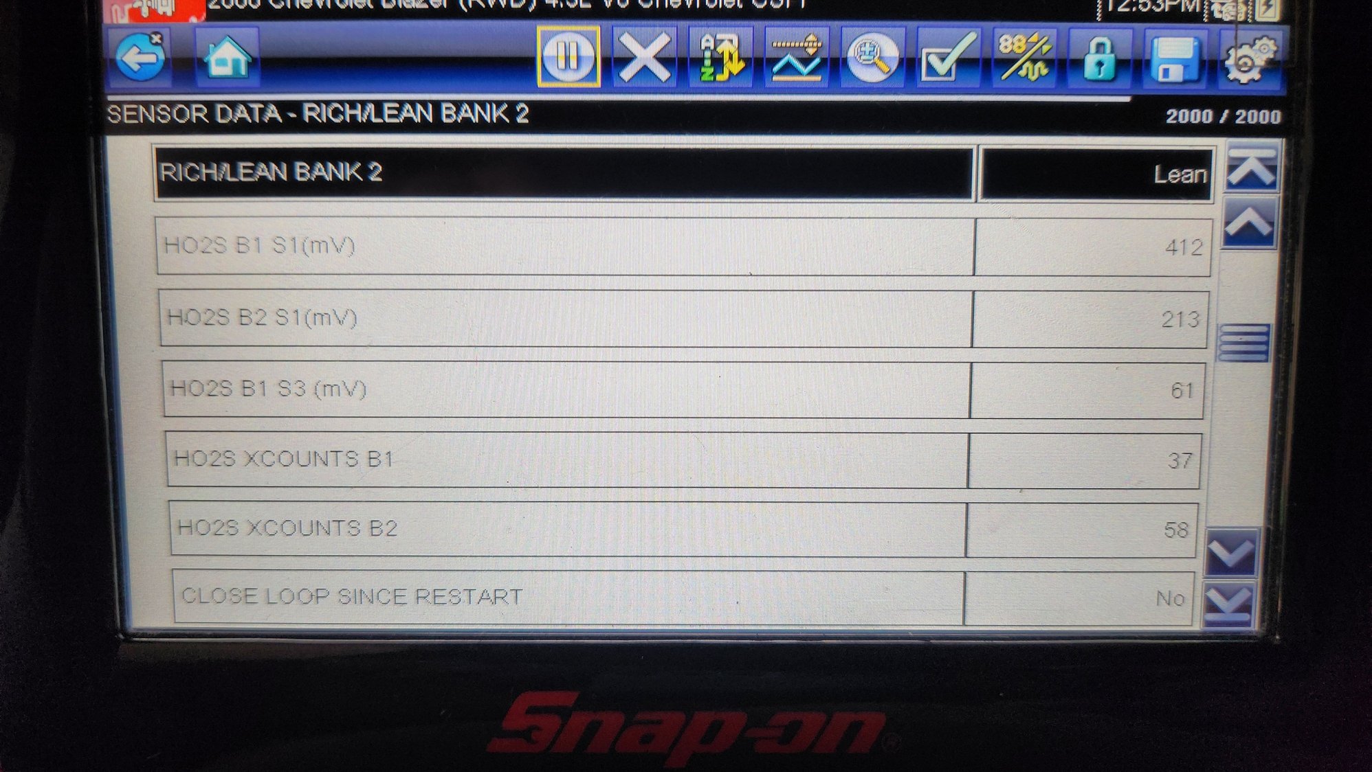

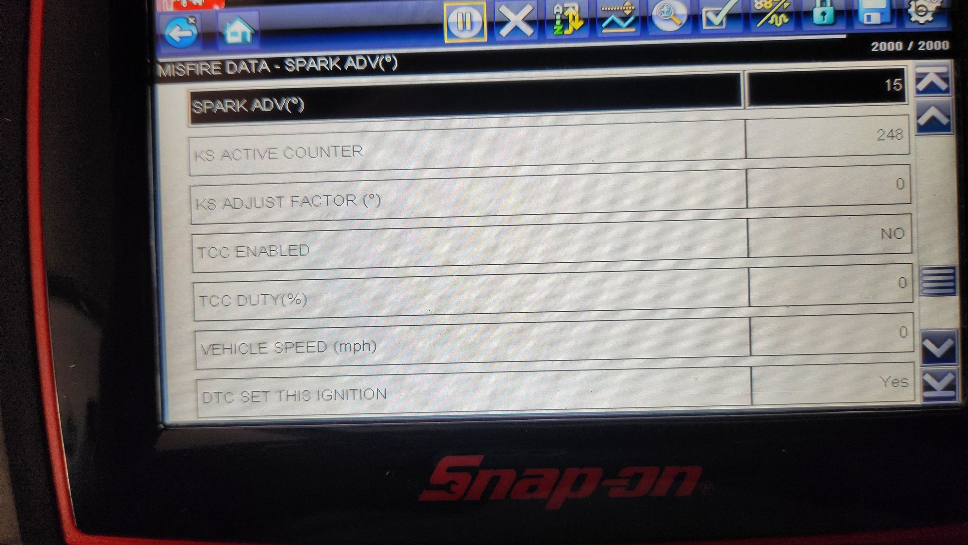

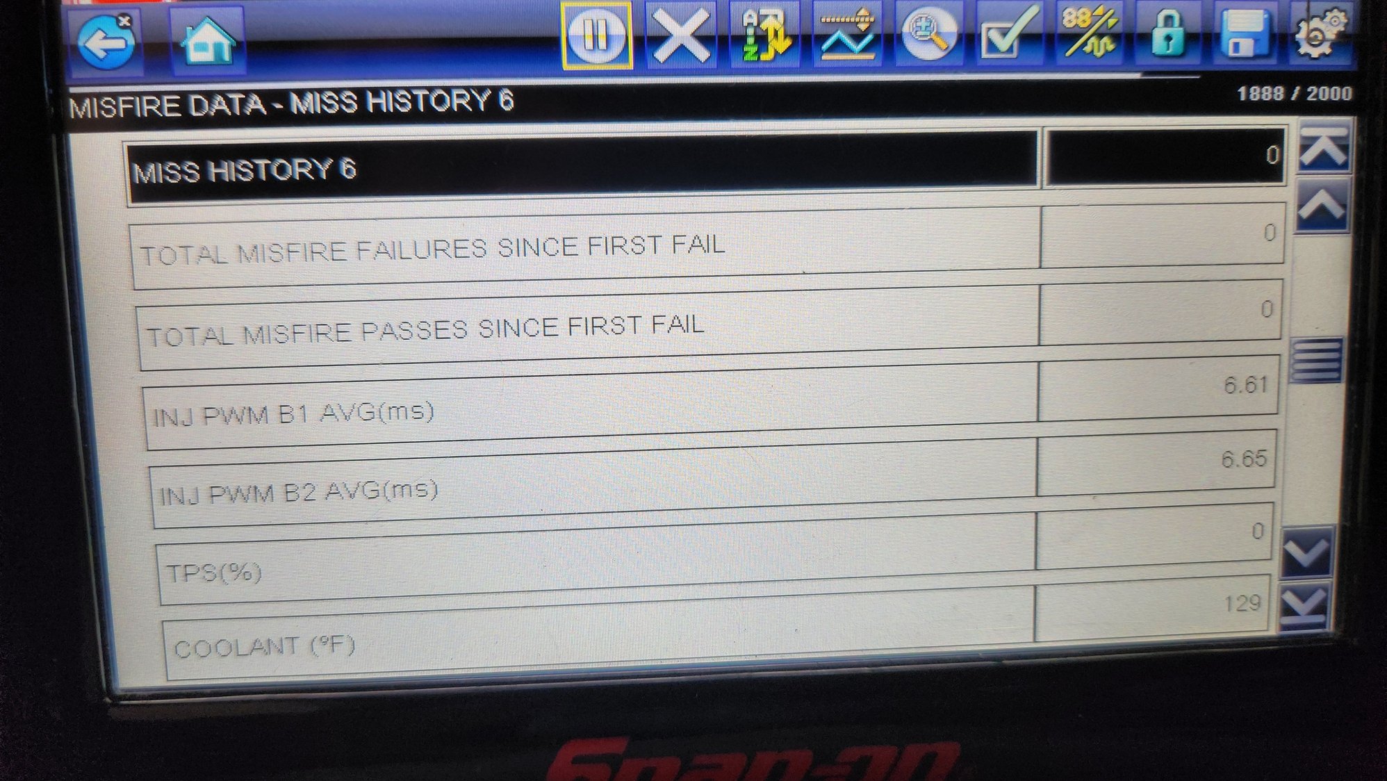

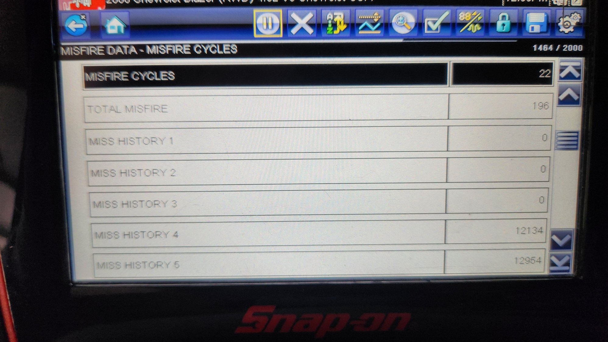

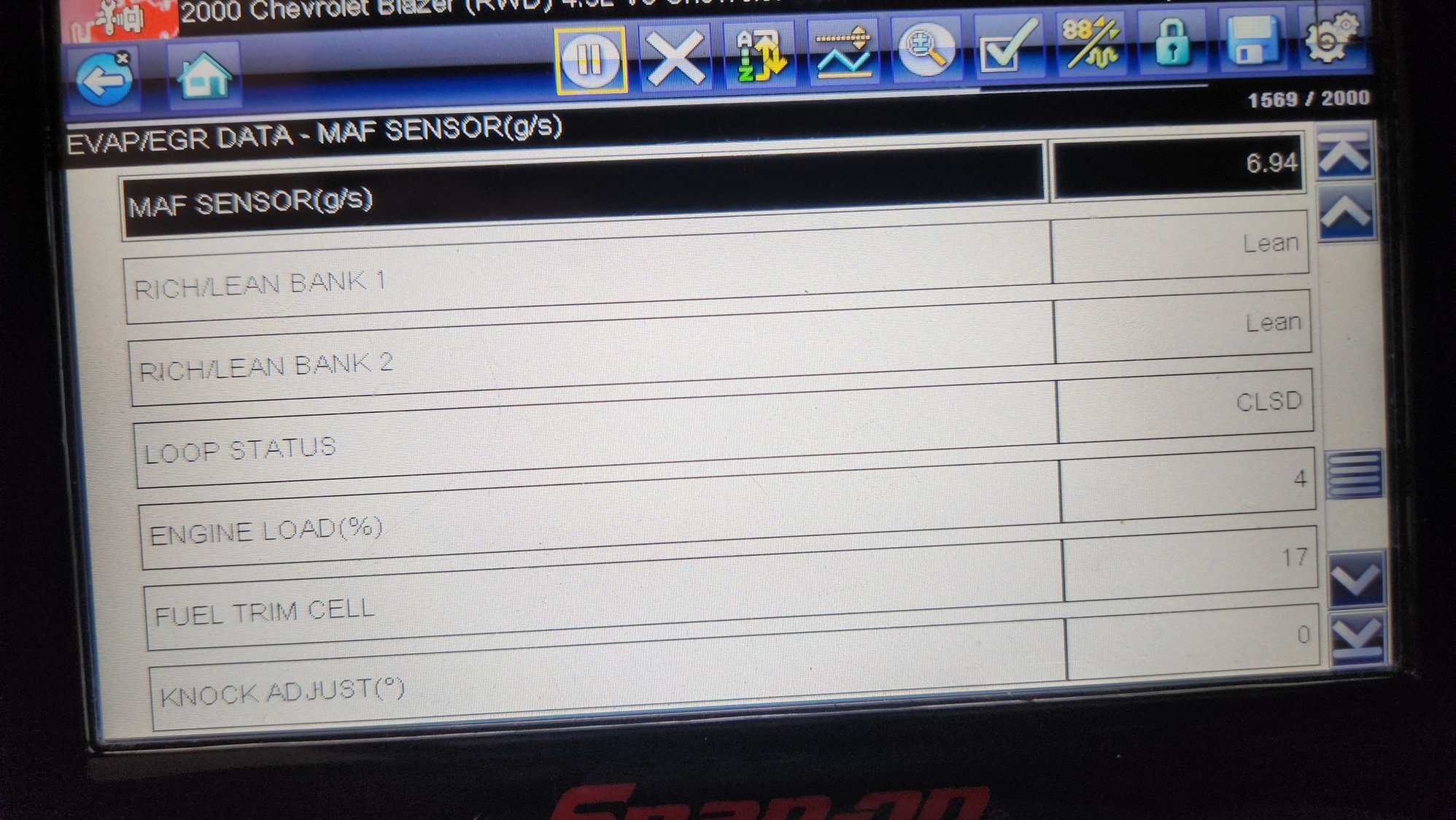

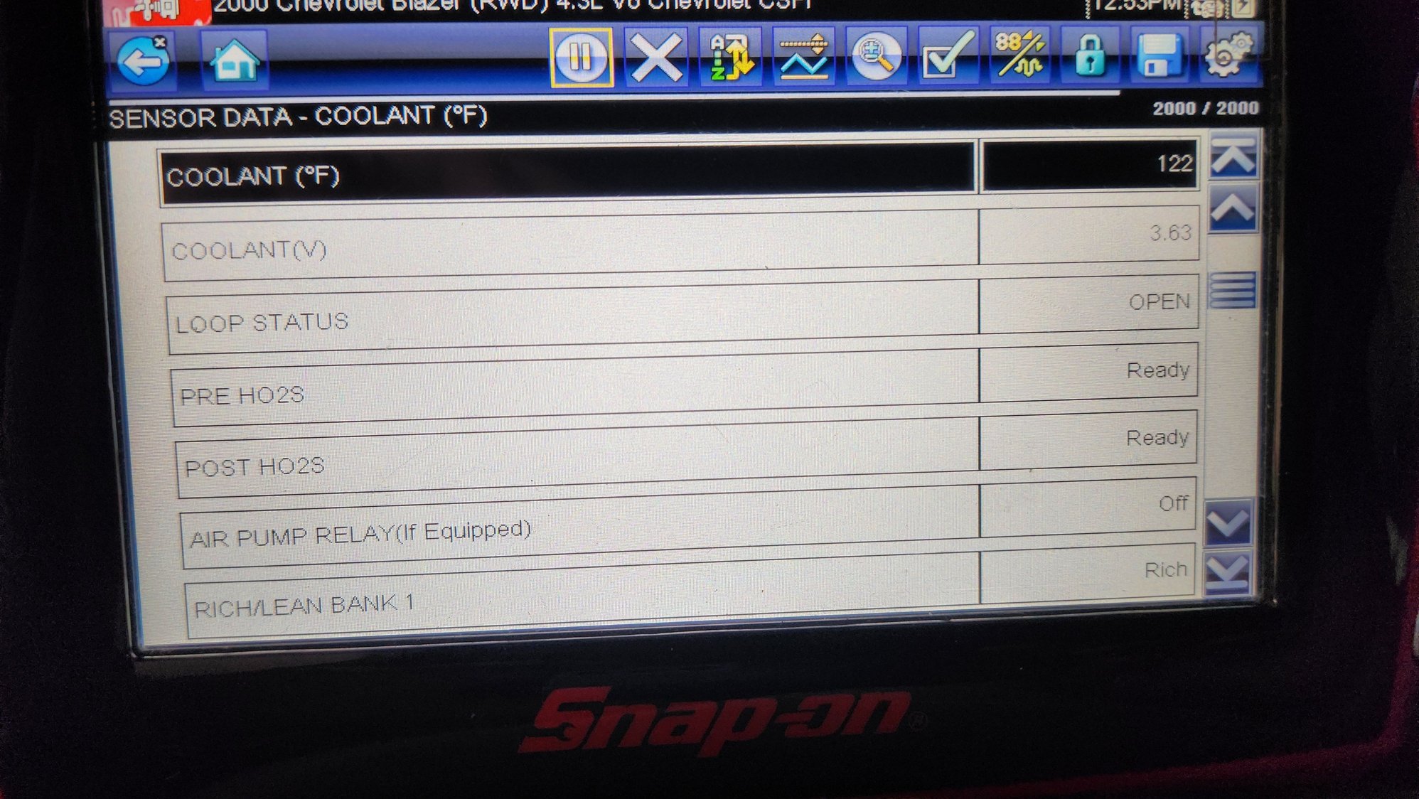

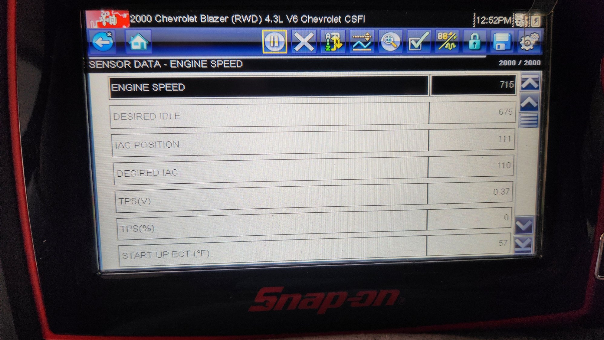

Heres some live data I was able to get off the Solus Ultra. Looks like cyl 4 and 5 are the culprits. I took pics of the screens, sorry if I doubled up on any.

Old Oct 27, 2025 | 04:01 PM
GeorgeLG's Avatar
Posts: 4,658
From: Florida
Originally Posted by GeorgeLG
Fuel pressure is not the problem, but at least we ruled it out because its a common issue.
  1. Your fuel trims do indicate a major fuel control problem
Need all 4 numbers, one got cut off
  1. You mentioned closed loop. If you start cold and watch live data, does the truck start running crappy at the moment of transition to closed loop?
Need this answer
  1. What cylinders have the highest misfire counts?
This says there is a problem in both banks so not likely the O2 sensor. Check your ignition wire routing and connects at both ends. Mist the engine around the wires in the dark with water to look for arcing. Pull 4 and 5 in turn and check for 1" of strong spark with a regular cadence. If all that is good then its likely either mechanical trouble (need a compression test) or the spider
