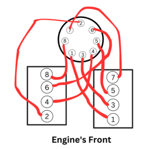

Plugs, wires, cap, rotor were all replaced after this issue started. All wires are ran correctly as well as the cap and rotor. I used Autolite single platinum AP605's. If I missed anything let me know. Ive never used a scanner of this caliber before but have over a decade on the parts counter but have never really had to go this deep before. I TRULY APPRECIATE you helping me get this figured out.

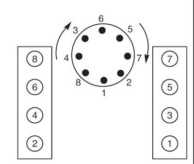

#4 & #5 show high miscounts and they are next to each other in a 5.3 firing order --- in a 5.7, not so.
A 5.7 has a different firing order/compression pattern --- neither of which (eg; 5.3~typical v 5.7~typical) did I see posted yet - but I'll play along.
5.7
1 8 4 3 / 6 5 7 2
5.3
1 8 7 2 / 6 5 4 3

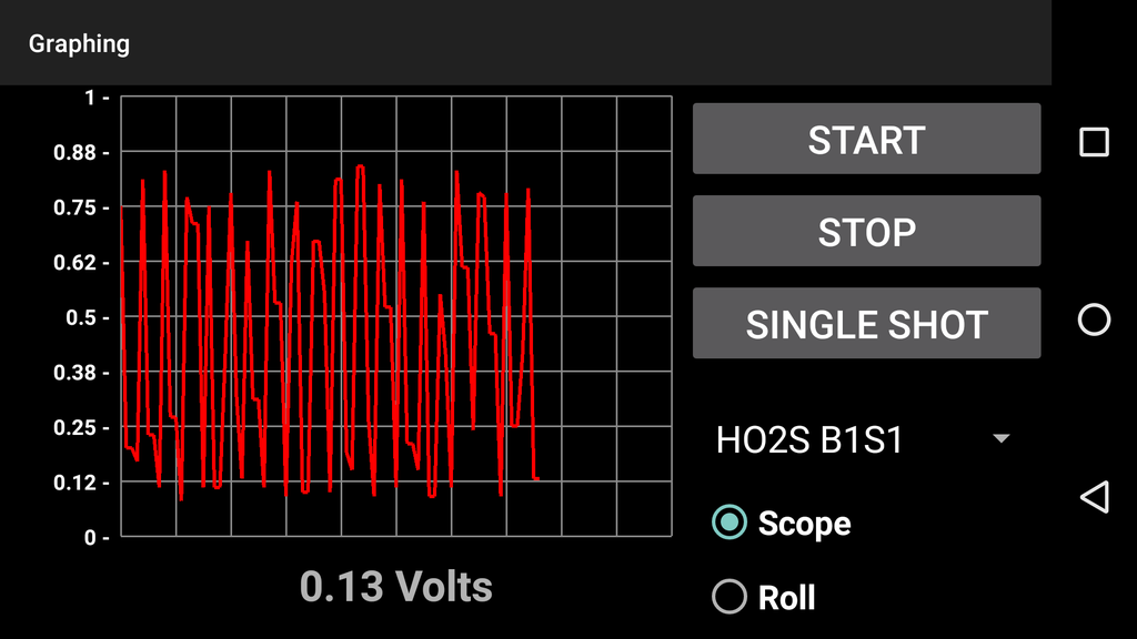

The 2 front O2 sensors switch between around 0.15v and 0.85v around once per second at idle. When you graph them they look like this:
If you dont have graphing ability then you can watch the values switching in live data at idle. The rear sensor should flatline between 0.5-0.8v. If it also switches there is a problem. The fact that there is no change when switching to closed loop also suggests however that its not the O2 sensors.

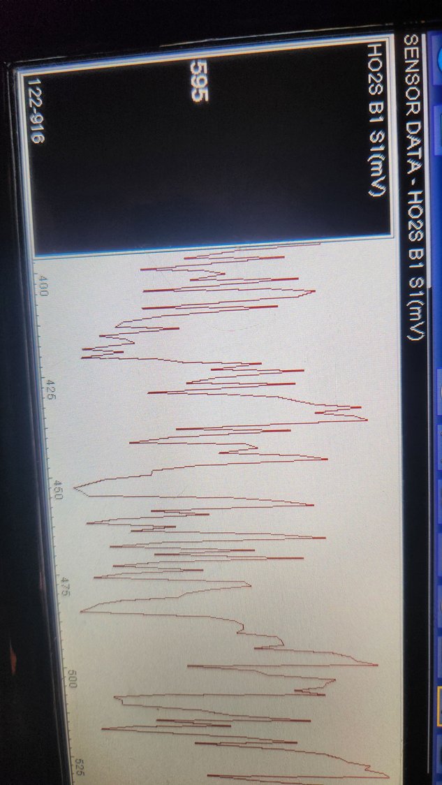

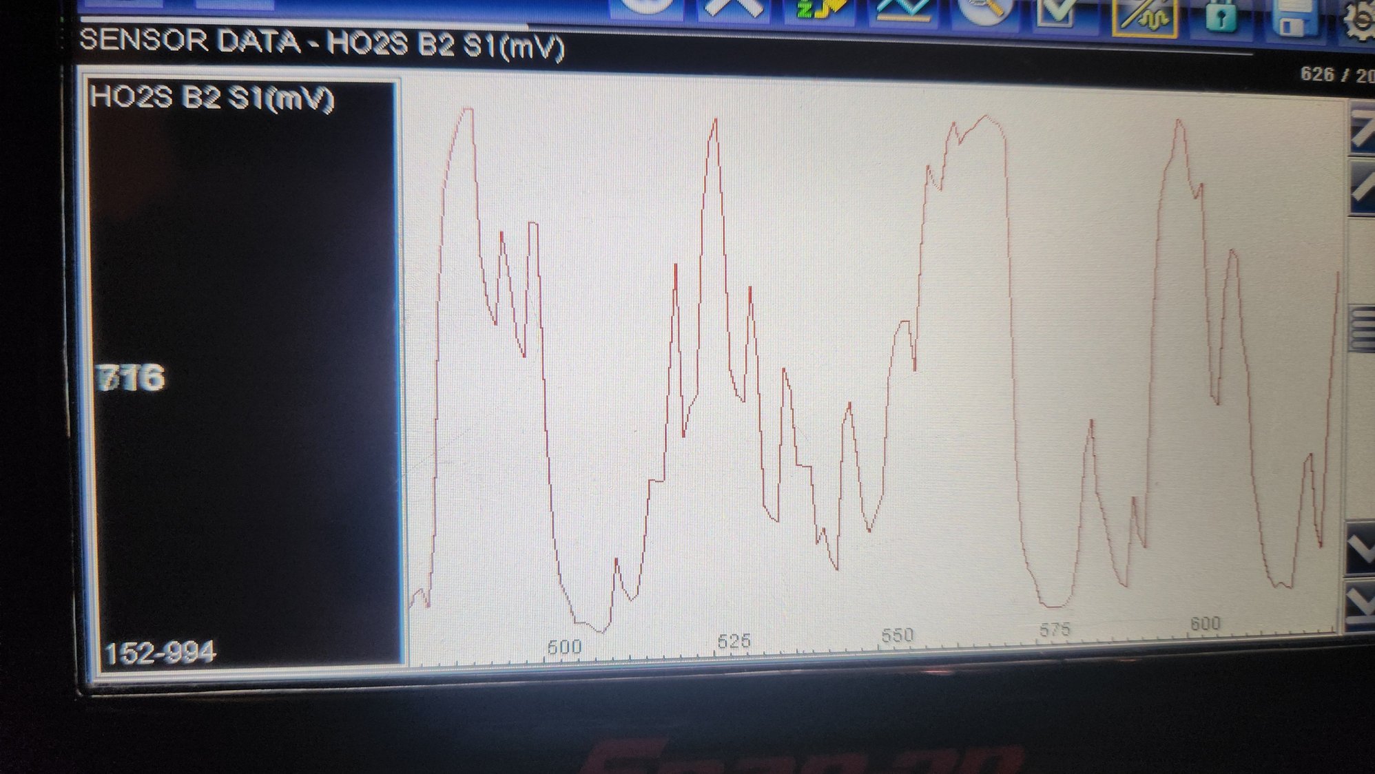

I was able to graph the o2 sensors. [Pics below]. I took pics of B1S1, B2S2 and the downstream sensor as well. I would rather someone look at the graph and decipher whats shown. I have a vacuum gauge, however no connectors that are suitable to go from the brake booster hose to the gauge. I fashionedan uncut nozzle from a tube of rtv [dont think it worked], it was either sucking by or i have minimal vacuum, and a large leak i havent identified yet.I wont be able to look at it again until Saturday. I'm also going to borrow a smoke machine to help locate any leaks that might be present.

B1S3 is your downstream sensor. If the engine was warmed up and in closed loop then this sensor shows a problem. It should be flatlined not moving around. Lets ignore this for now because this in and of itself will not make the truck run bad.
B2S1 is the passenger side precat sensor and its not switching right. The question is always whats actually wrong, the sensor itself, the wiring, the engine computer or the fuel delivery. Since that the one with the heater code we should test the heater circuit and then replace that sensor.
B1S1 looks better but not perfect

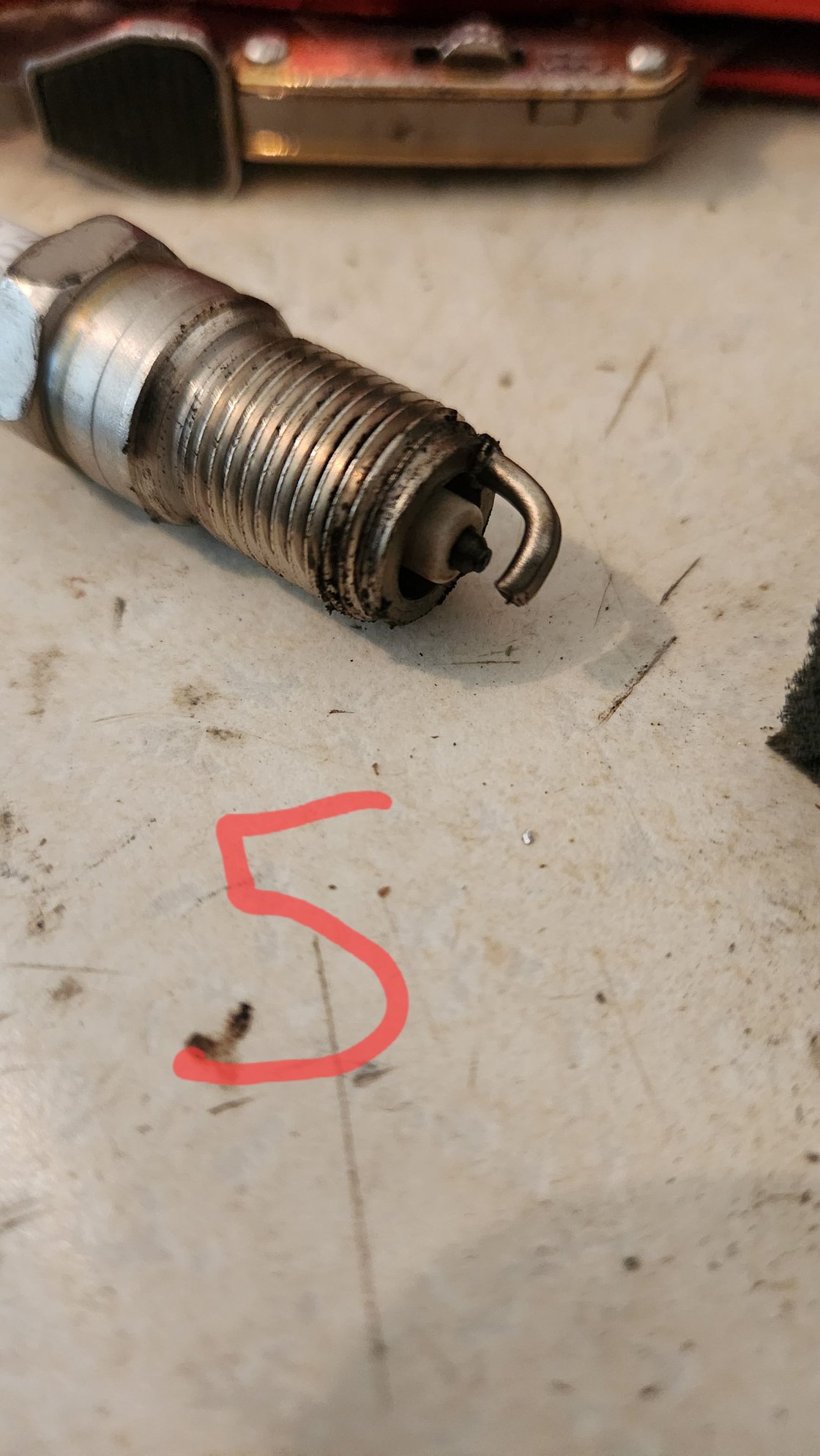

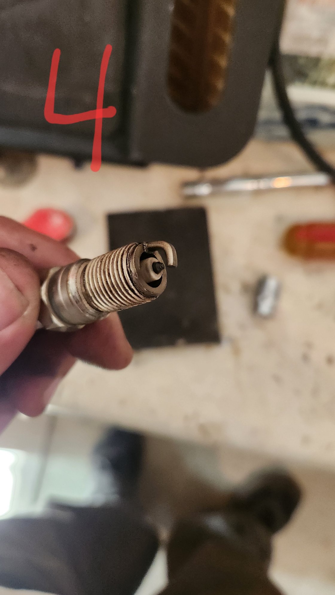

What did those plugs look like?

Old plugs were worn, gap was worn to .060 and of normal color. I did spray around with the ether and had no change in engine speed. I'm hoping that the smoke machine will show something this weekend, pop the plenum, slap a new gasket on and laugh about such a simple issue causing so much trouble. For everything to be fine when parked then all this showing up is really got me baffled. Is there anything I can do spider wise without a whole bunch of disassembly while im at a stand still with the vacuum tests? I have to drive it in and out of the garage when messing with it. Old blazer has over 300k on it, id like to keep it running as its my daily driver 76 mile round trip to work everyday. Im unsure if the spider has ever been replaced, i did remove the throttle body and replace the gasket hoping it would fix it just because it was cheap. I did see the lines on the spider and they are black in color, I've seen some replacements with white lines but unsure if that means anything or not.

At 300K I am leaning back towards the compression test. I am surprised that the plugs on #4 and #5 did not look different.

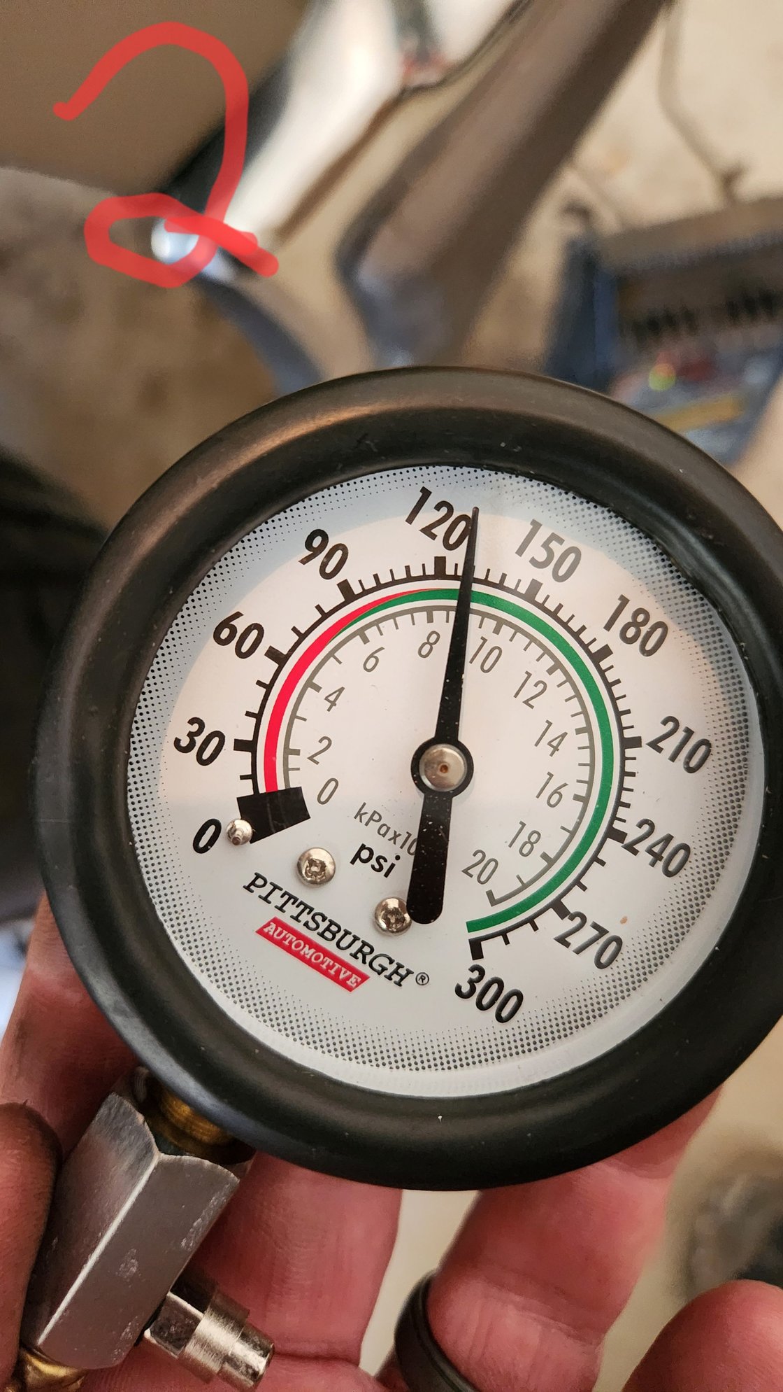

COMPRESSION TEST:
compression may be a little low but not terribly sure.

Those compression readings are pretty low. Please do all six cylinders, engine, warm, all plugs out, throttle open, fuel pump relay pulled, same number of compression pumps on each attempt for each cylinder if any of the answers are more than 10% below the high cylinder, poor teaspoon of oil in the spark plug hole and repeat the test.
if all the values wind up hovering around 120 psi then you got a well worn engine at 300,000 miles but if none of them are 10% different from the high value, then it’s not a cylinder problem. That said with that kind of engine wear things will never run completely smooth. Let’s wait and see what kind of total test results you get, but if nothing is catastrophically indicated then we move onto the spider.
