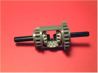

This may sound silly, but when I was a kid in the 80s, Lego came out with their "Technic" sets with gears and wheels and u-joints and stuff. I had a set with a plastic differential for building cars and trucks. To this day, whenever I think of how a differential works, I go back to that Lego set...

To be more accurate, 2wd is really 1wd, and 4wd is really just 2wd. With regular open differentials, only one wheel on each axle will be receiving power, which is the one with least resistance (traction). The only way to have true "four wheel drive" is lockers front and rear.
Yes, like these:
