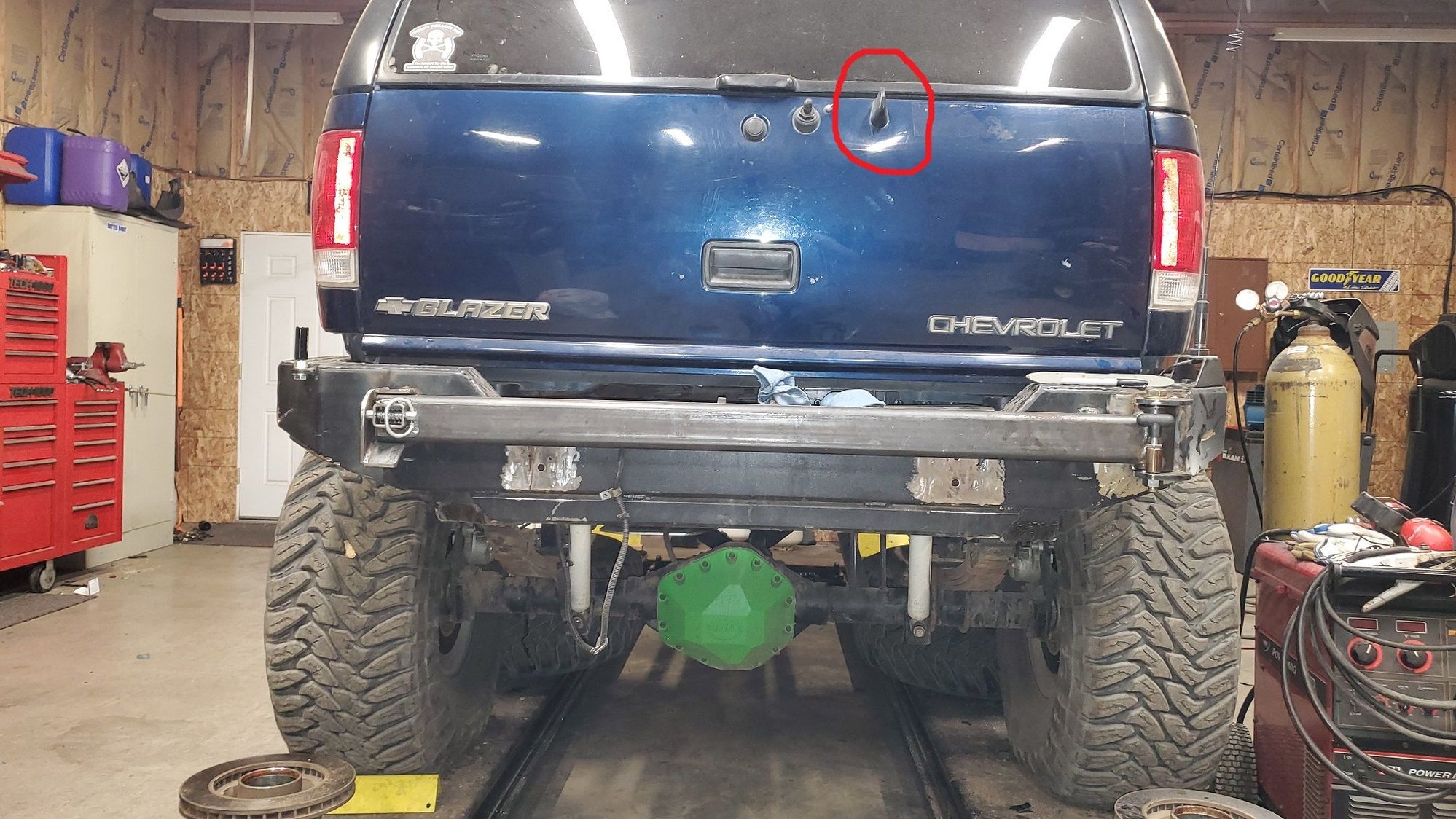

I found an old picture with the thing I'm talking about. Does yours not have this? You might be able to find one in a junkyard, but you have to unscrew it from inside the door. That's why I cut mine off with a Sawzall. Otherwise, I'd give it to you.

looking at other pictures of my model it looks like my rubber hook is too low for some reason ill check on that. ill get back to you about it thanks dude.
p.s. your blazer looks sick dude cheers

Yeah, that's weird. That little block should lift it off the glass at that point. I wonder if you just slightly bend the blade (straighten it out a little), if it would then hold it off the body. Maybe build up that block a little bit somehow?
