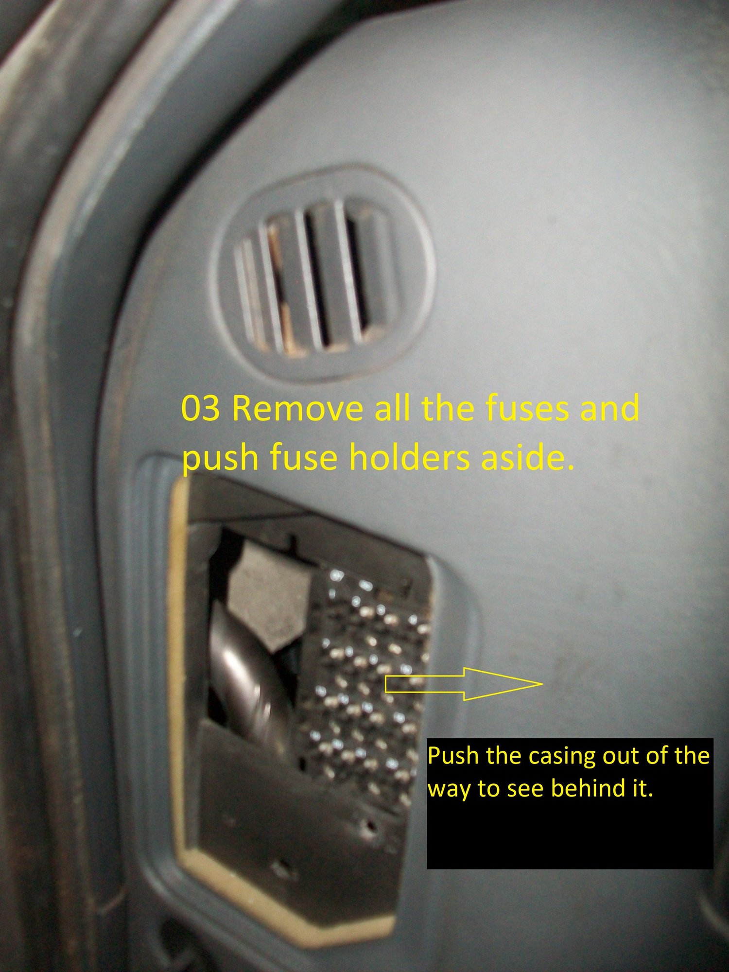

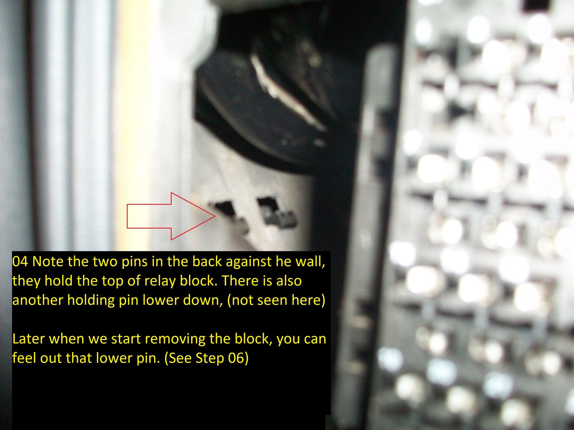

Old Aug 3, 2019 | 10:00 AM
Tony Marquez's Avatar
Joined: Aug 2019
Tony Marquez is on a distinguished road
Default Finding & removing the body realy block
I have a 2000 GMC Jimmy, which I assume is similar to the other GMC products of this area for locating the Body relay Block. This process takes about 30 to 45 minutes or longer depending on your situation, can even be done in less time. All you need is to remove a few panel bolts and screws, a flashlight and long flat blade screwdriver. Just follow the attached images. Good luck. My apology for the misspelling, if you have questions, let me know.
It is best to review all the steps before doing this.
