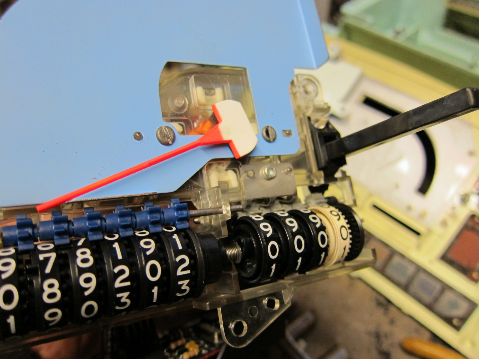

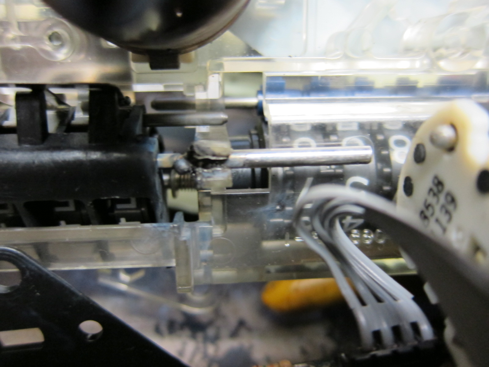

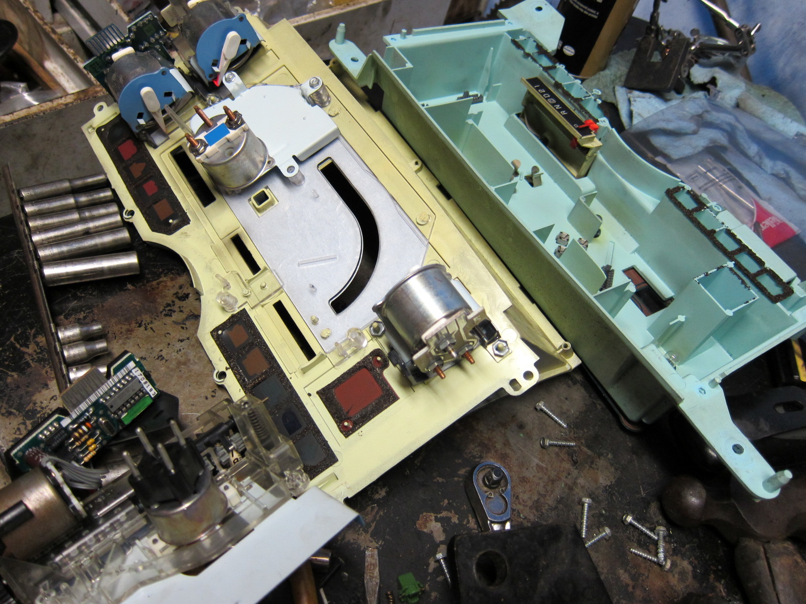

Originally Posted by mr.vls
My Odometer recently failed at 475805 and I had a spare dash cluster so I removed the Odometer with the Speedometer mount from the cluster. I had never worked or messed with an odometer before. I removed the odometer/trip meter from the plastic mounting base from the spare dash cluster. I tried just setting the miles and re-inserting the number wheel back into the housing. It was impossible to set the numbers and have all the wheels index properly on not lock up. I watched how the Trip Meter Indexed every time when the numbers were set to Zero when pushing re-set button. With all of the numbers lined up on Zero the wide cogs on the index wheels had to drop in at the slot in between the number 7 in each wheel. I was able to advance the numbers from zero by removing the idle gear and drive motor from the mount and using a socket and drill motor on the drive gear advance the numbers very rapidly. It took me a while but I advanced the odometer to the current mileage and I was able to successfully transplant the replacement odometer into my existing dash cluster. All the numbers line up perfectly and advance as they should and the trip meter resets to zero each and every time. (I used a Metrinch Socket that loosely fit over the drive gear and it did not damage the plastic gear teeth at all) The wide cogs for the trip meter drop in at the number 6 each time the numbers are reset. Each Cog has alternate wide and narrow teeth.
Been there, done that! Except mine failed because of tampering. The second I checked the oil at the eBay seller's house, I knew that 77k miles was a BIG stretch - more like 277k.
I welded a tiny bead on the little pin for the trip meter. Worked for a few years at least.
