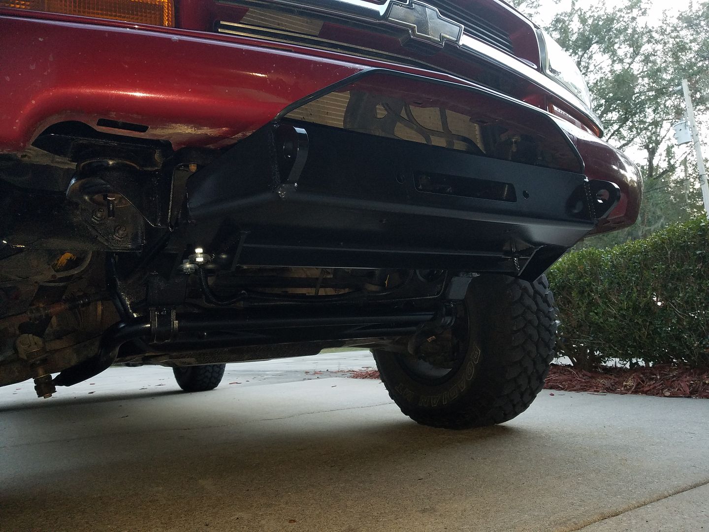

Looks really great! Did you purchase it as a direct fit and if so, what other years would it fit. I like it. Gives you what you need but doesn't take away from the aesthetics of the vehicle. Kind of like a "sleeper"!
Bought from 4wdFactory.
https://www.4wdfactory.com/store/pro...nch-Mount.html
Direct fit bolt on for the most part. I had to drill two holes in the frame rails (one on each side) for some extra bolts to secure it a little better, and cut up the bumper a little as you can see to actually be able to get to the winch to flip the free-spool lever, and I also had to cut a little material to actually fit my Smittybilt XRC8 between the frame rails on the mount, but that's going to depend on the winch. The Smittybilt was just a hair to wide to fit without any modifications. But all in all not too bad. I like that it's a bolt on and can all be reverted back to stock if I ever chose to do so without cutting off any welds

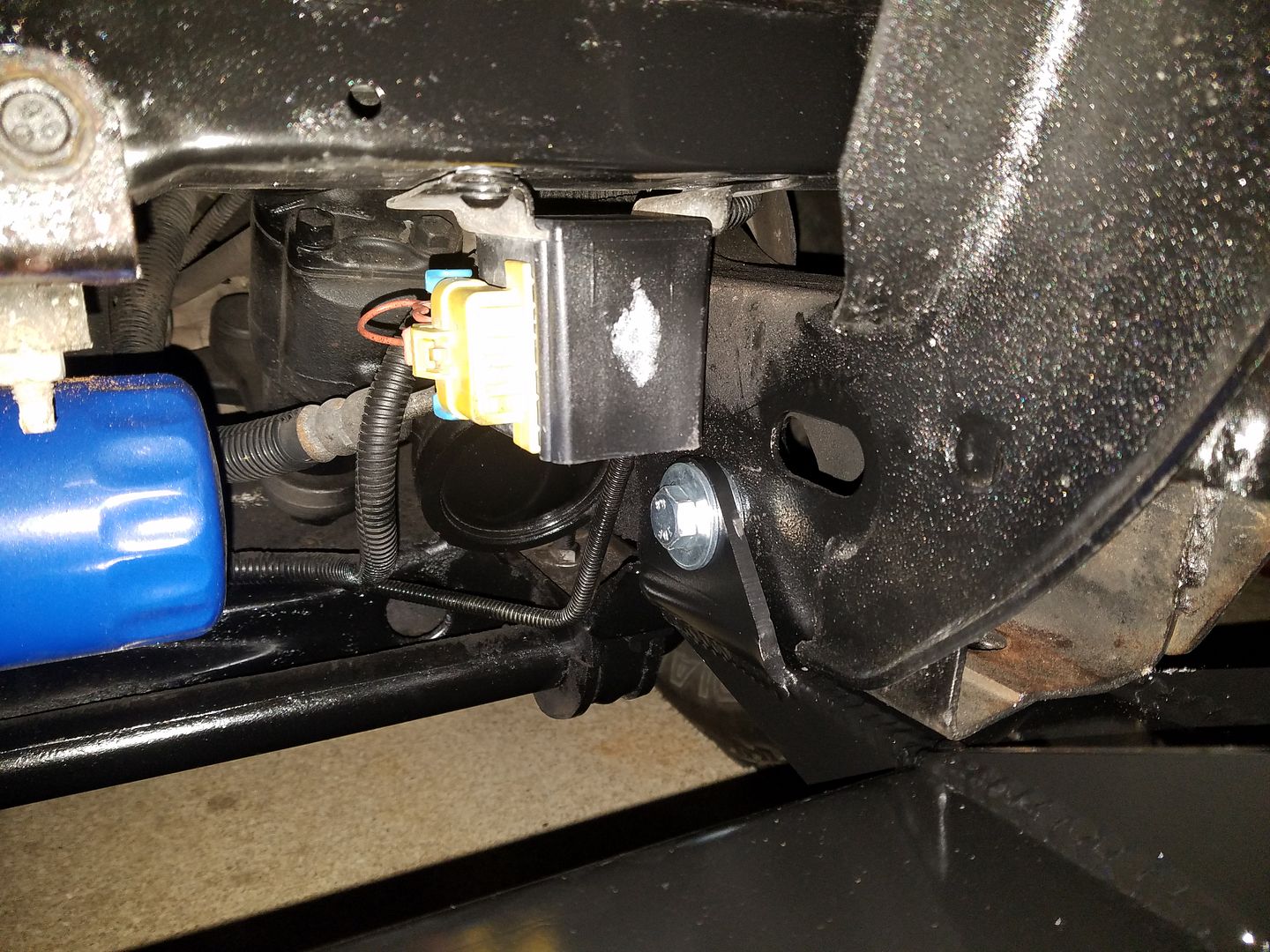

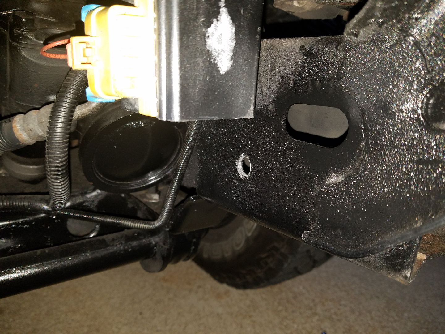

Tucked the winch up in between the frame rails finally, mounted solid to the truck and bracket. I love how this bracket keeps it all tucked in under the bumper There definitely won't be any quick thieving of this winch lol. I still need to fab up a bracket to go between the winch and oil filter...
My GOD that assembly is heavy... Had to hold it up and have the wife thread the bolts in. It's great that she's willing to help me work on it when I asking, she knows that once it's done we get to go wheeling, and she might even get to drive
So the hard part is DONE. Tomorrow I plan on getting it all wired up and bolting the brush guard back on as well.
Talk about a TIGHT fit... Where I clearance the bumper brackets, on the passenger side, there is MAYBE a single MM of wiggle room left.
The driver's side has all the room in the world
There's also plenty of room to reach the free spool lever, after clocking the gearbox end over a little.
