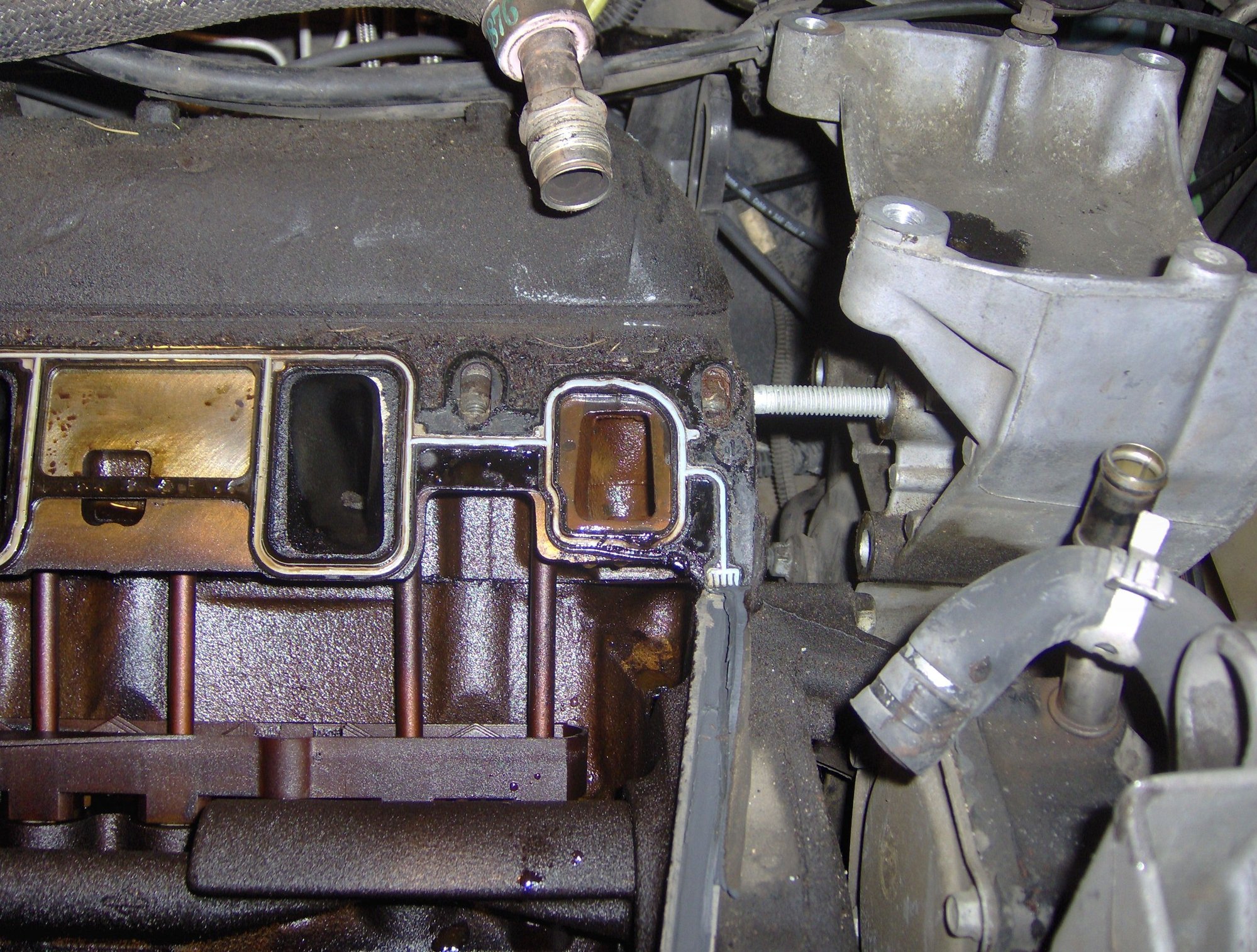

l didn’t get this done today, actually it was done in August of this year. I had the shop replace my lower intake manifold gasket. I had them use the Felpro gasket. They showed me the old one when they removed it. It was cracked and torn in a couple of spots, but it looked like it was a Felpro gasket. It had the same stiffness as the new one. I know these are not the original gaskets that came with these blazers from the factory. l purchased the Blazer less than a year ago with 127k miles on it. This made me question how long ago was the gasket replaced?

There are more than one LIM Felpro gasket that can be used on our motors. There is the original style plastic one and the preferred upgraded one with the metal frame. It sounds like it was the plastic type that was removed from yours. I'm pretty sure mine were original when I replaced them and they were black plastic. That would be bad if even the replacement plastic ones ae failing in a short amount of time. Then again, the act of removing them, can damage them.

l hope the one l had installed was not plastic. I paid for five hours of labor to have it installed. Someone told me there was only one type of LIM Felpro gasket currently being made. I got it at an auto parts store. What color is the metal gasket?

Look up the Felpro gasket kit MS 98002 T. This is what I used along with new intake manifold bolts.

The one l got was the plastic one. I know the metal one is better, but someone did say the plastic one can last 10-15 years.
