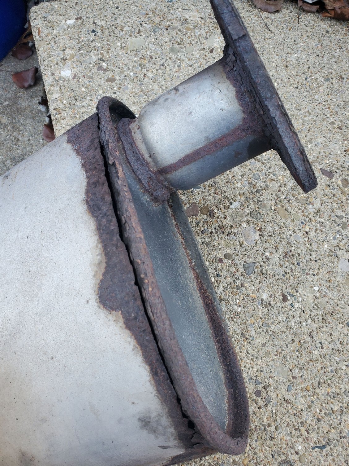

Today I did an oil and filter change. Also replaced the muffler since the old one was finally rusted through on the bottom front edge. Luckily easy to replace. Took maybe 20 minutes.
Look at that thing! WOW!
