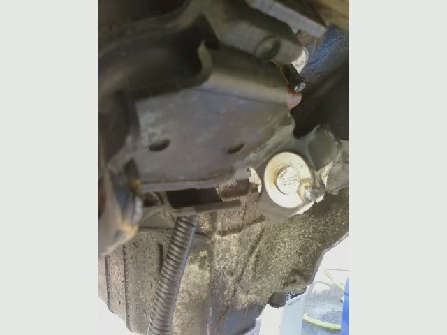

I had no choice with this one, because I'm using the '00 Jimmy Vortec, hose, and radiator, but kept the first gen alt/power steering setup. The hose hit the fan blade of the alternator whenever I gave it a foot-full of throttle. Using the stock '00 motor mounts, and they're very flexy - the engine moves around quite a bit in there. Torques about 4" to the right under hard throttle - found that out after going through MANY air cleaner spacers ...
Heck, im running 1995 series motor mounts on my 96. The stock '96 mounts were bad so i transfered the ones off the '95 parts motor (engine was already out) then when we were putting the motor back in we discovered the 95 mounts were too narrow to go over the 96 chassis brackets. Had to torch off the '95 frame brackets and bolt them in to the '96 chassis. (With the engine hanging there over the work area) the next guy is in for a surprize if it ever needs mounts again...

Yep - the first gen mounts are quite a bit more narrow. I had to shim these mounts with washers so they wouldn't crush, or end up with slop, when I tightened the bolts. Tacked them in place so I wouldn't fight with them on install.
Attached Thumbnails what have you gotten done on your blazer today?-blazerproject-enginemountwasherweld.jpg

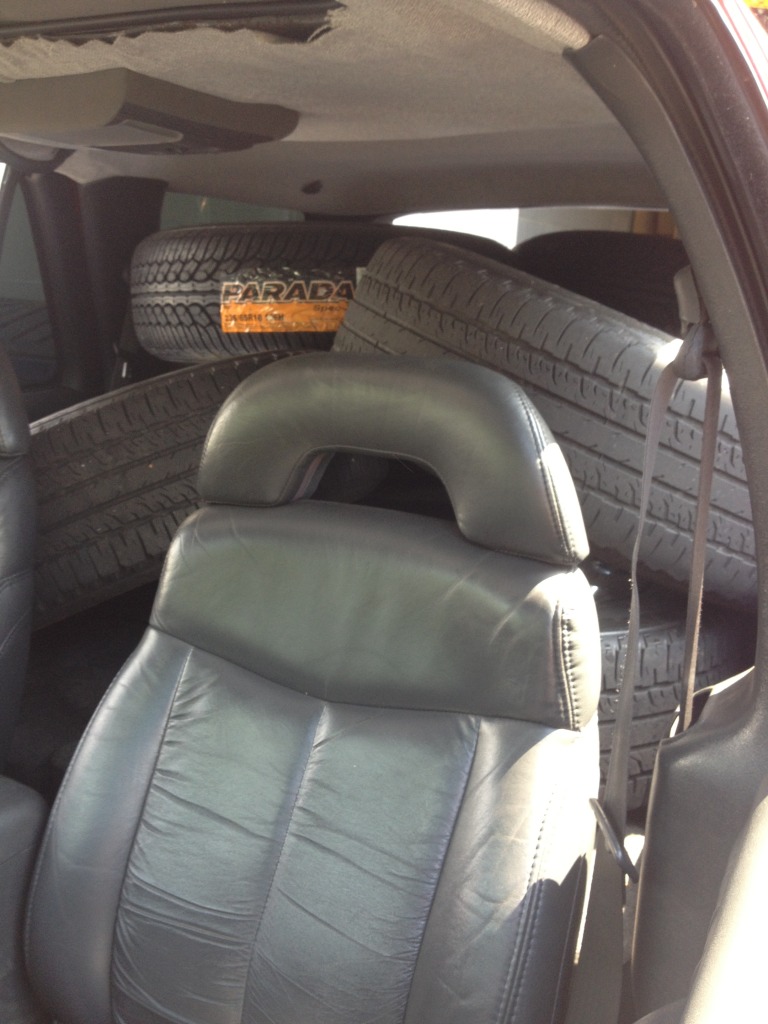

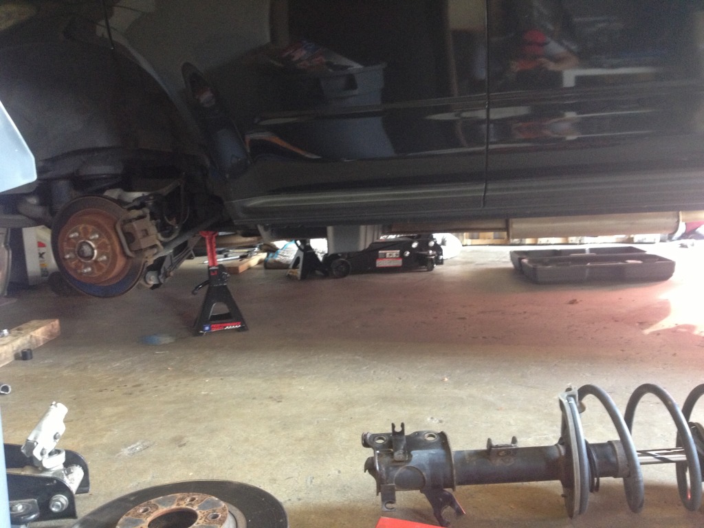

Today was a busy day! I started tearing down the murano and got to this point
The struts and shocks are out and waiting for the new parts to arrive tomorrow. So then I loaded up the new and old tires and dropped them at the shop to get mounted and balanced
And two more on the roof rack
Then I decided I should just go ahead and replace the strut mounts since I was already this far into it so I jumped on Advanceautoparts and found what I needed and then my online coupon for $50 off $125 so since I was at $85 I decided I would treat the blazer to a free $45 set of brake pads and I still saved $5
So I threw them on quick and now since the murano has no feet I'm drivin the blazer home tonight! Hopefully all my murano parts will be in tomorrow and ill get it back together and in for an alignment.

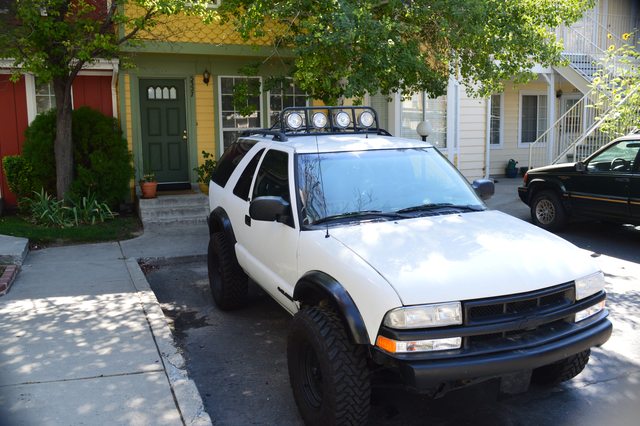

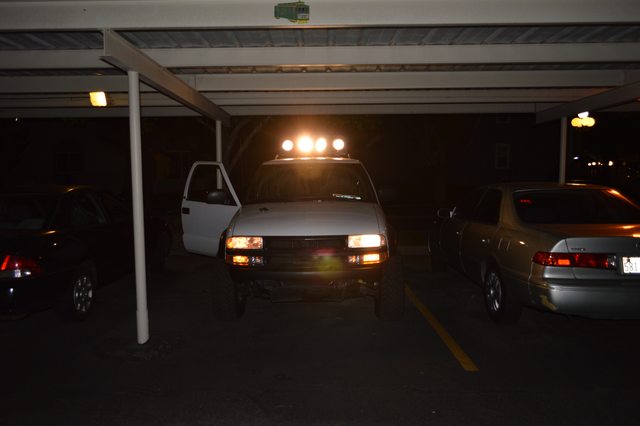

FINALLY got to work on my blazer after a month planning a wedding, starting school, working full time and going on a couple camping trips.
I had found the light rack from a UTV and mounted it up to the roof rack
plus I scored the stock wiring set up from the UTV so it is all clean looking on top
Ran all the wiring hidden under plastic, have a couple of things left to do when its lighter out tomorrow.
Also ordered a new double din head unit (non-touch screen) mainly for the bluetooth
(Yeah I was listening to Outkast, it was that kind of night)
Next on the list is to fix my exhaust, I went up and hit a couple trails and bottomed out a little on a rock and broke my mounts for the exhaust I made, so now it rattles at idle lol
And also I have an issue with my 4x4 lights. Ever since I blew my ATC fuse the 4x4 wont engage (I think, it clicks) I push 4hi or low or 4wd auto and the light just blinks at me. No codes so I am kind of stumped :/
Awesome man!
as for the 4wd, have you tried pulling the tccm fuse for 30 minutes? reset the tccm?
