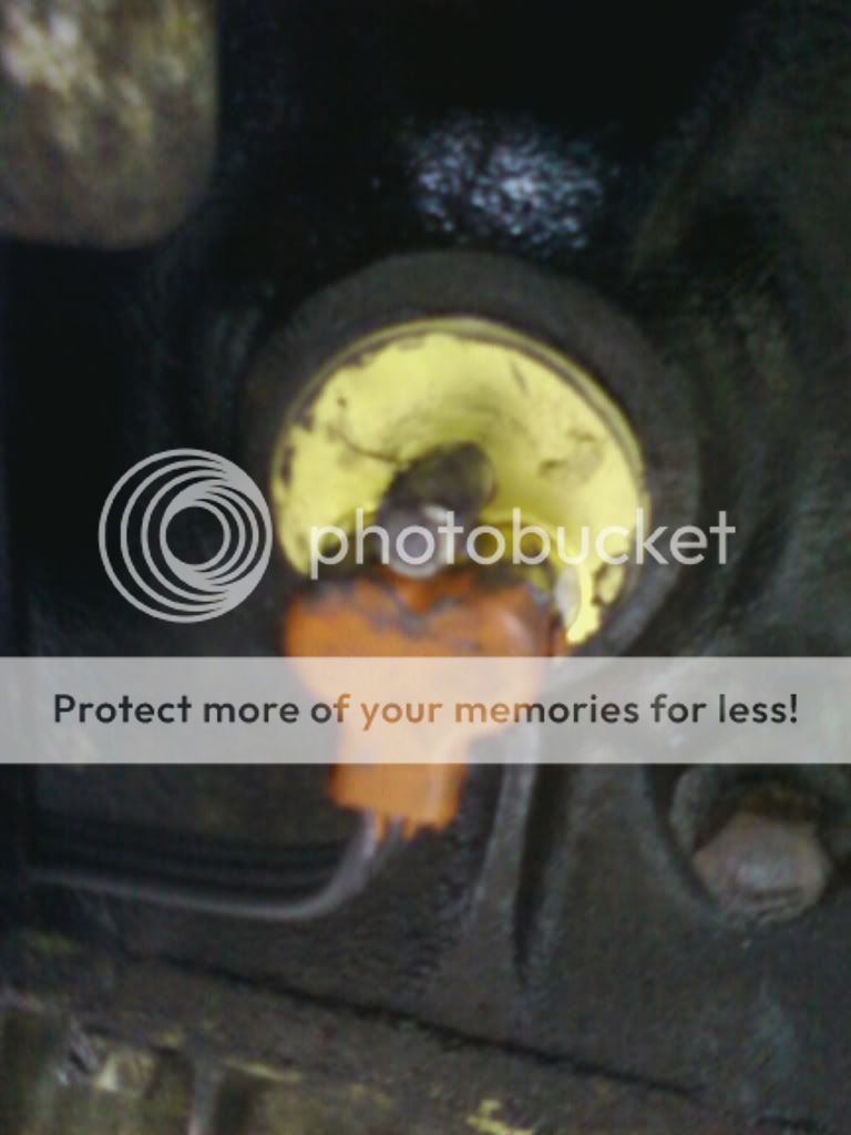

You gotta put one in like I did.
The line above the oil lines is for the block heater. You knock out the driver side freeze plug & install it there, then just run the plug out by the grill. This is the '00 Jimmy engine I put in my '89 S10 Blazer:
