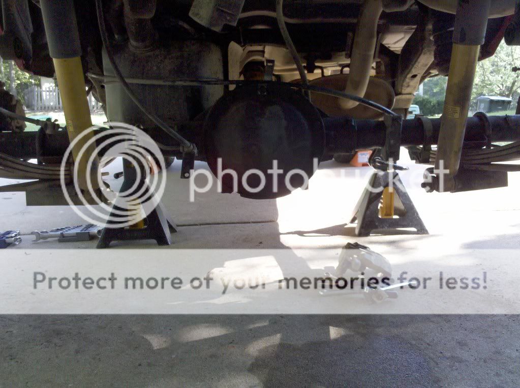

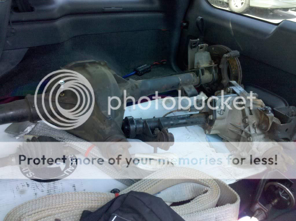

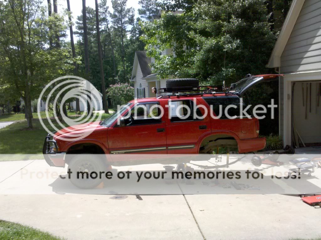

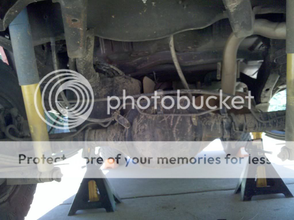

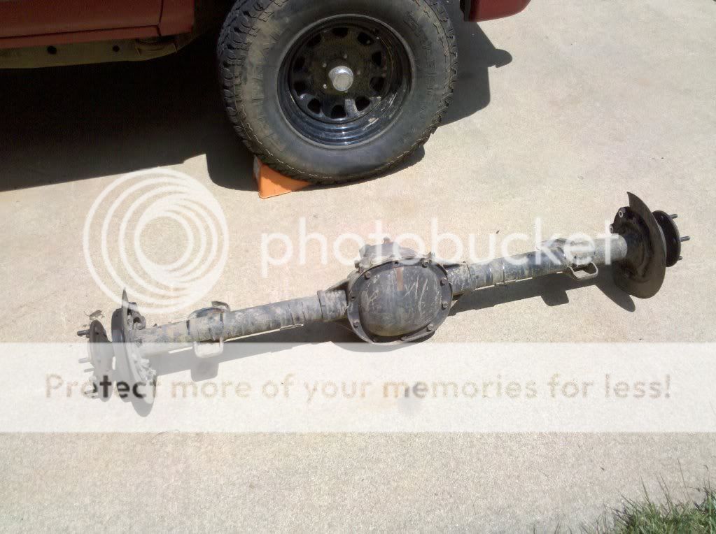

Ive been meaning to put these up for a while now..kept forgetting. ZR2 front and rear axles in my 4-door blazer. Replaced the stock 7.625" rear end with 3.42s with an 8.625" out of a ZR2 blazer. No pics of the front swap though, started running out of time. Its pretty much 3 bolts and a pinion more than doing both CVs at the same time.
It's awesome with the 3.73 gears..Ive got all the low end power back that I had pre-lift/tires/etc! It's also crazy feeling the back end lock in when one tire starts slipping with the G80. I have noticed it sometimes does not lock though...trying to get used to it and see what I have to do to make it lock (wheel speed vs vehicle speed, braking...etc).
Notes for anyone interested in the swap:
-8.5/8.6" rear ends are MUCH heavier than the 7.625's
-Steel brake lines on the axle are pretty fragile after 100k+ miles...be careful getting them off haha
-Autozone flare-your-own-brake-line tools suck..buy pre-flared at the dealer and save the trouble
-Oil leaks from the oil cooler make all the bolts and parts up front around the diff super slippery...I suggest pre-cleaning and degreasing
- Learn to weld before swapping so you can do a SOA...I was so sad I couldn't SOA as I was installing the new axle
