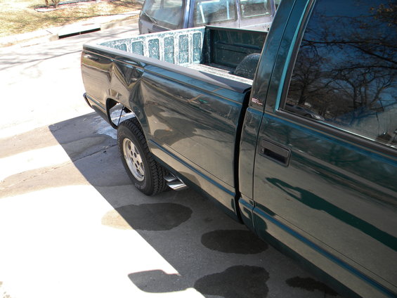

I didn't know that about the Colorado, makes sense though since they're cheaply made. Packing does burn out, even the stainless steel wool used in modern Magnaflows will burn out. I have a Thunderbolt highflow cat (as loud as a Dynomax Bullet) and a 3" in/2.5" dual out Magnaflow on my Sierra and it dumps out the side in front if the axle, this is my truck, ignore the dent:
The muffler is the 18" case, and it's super loud. It's just as loud if not louder than a Flowmaster 40 now, not near as much drone but just as loud with the highflow cat. It's so loud now that i'm getting tails and putting the tips back like this:

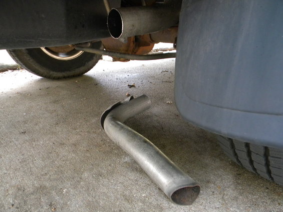

Now on my Suburban I have an 18" case 2.25" dual/2.5" single out welded in the stock pipes:
Stock tailpipe, bend cut off which eliminated all drone:
And it has gotten a bit louder over time but not loud by any means, not like the Sierra at all.
